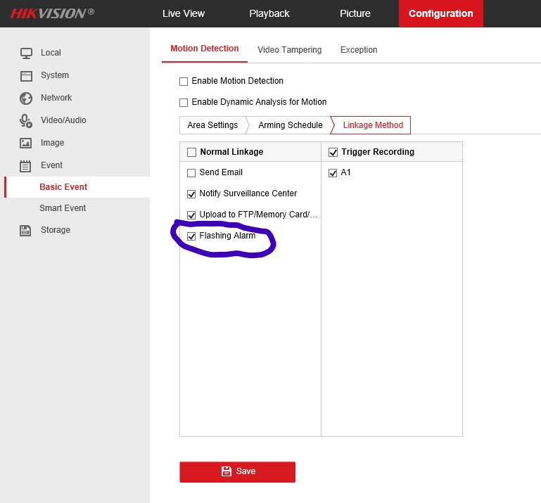

@busterboy
If you don’t mind me asking: How do you configure the flashing strobes?
Assume it’s via the cameras own configuration? In the Smart Event Linkage Method area?
I’m running Firmware V5.6.5 Build 200316 and can’t see an option, so wonder if it’s been removed or I am looking in totally the wrong place.

No problem.
Using the firmware v5.6.2 you get this option in the camera configuration panel. :)

Hello Busterboy
On the flashing strobes. Is it the LED on the camera that strobes or is it an indicator on the NVR. I have the same camera and NVR but hadn't noticed this option.
