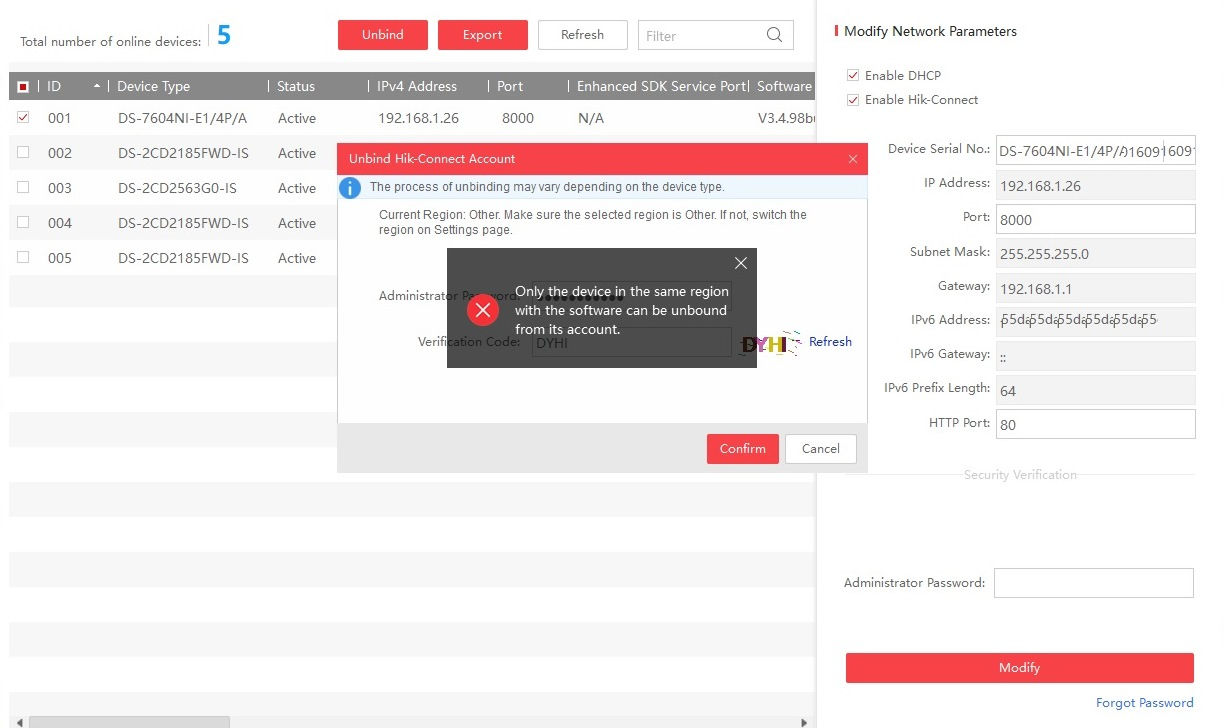

Cannot unbind - I get this error message "Only the device in the same region with the software can be unbound from this account"

I am trying to unbind a device from a previous account to my account, the problem is I keep getting the error "Only the device in the same area with the software can be unbound from its account."
Any assistance will be a huge help.
Phillip

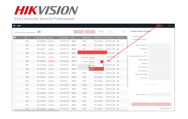

Yeah don't have that button
I had the same Problem. Its because you uploaded from an old SADP Version to the 3.0.2.4. Delete the SADP complete, then reboot your PC and make a fresh install of the 3.0.2.4 or 3.0.4.2. Then you have the button.

Has anybody been able to successfully unbind any NVR that has given these errors?
I've tried Hik Connect via Android mobile & iVMS via local PC, both fail with either the "local area" or "same region" excuses!
I'm starting to think that this is either a S/W bug or part of the Hikvision hack phenonium...
Yes. My solution was thr time-zone settings on the NVR must be correct

Have you followed the steps at #10?
Tried that, if I select Russian it displays a different error, something about not being bound in this region...
