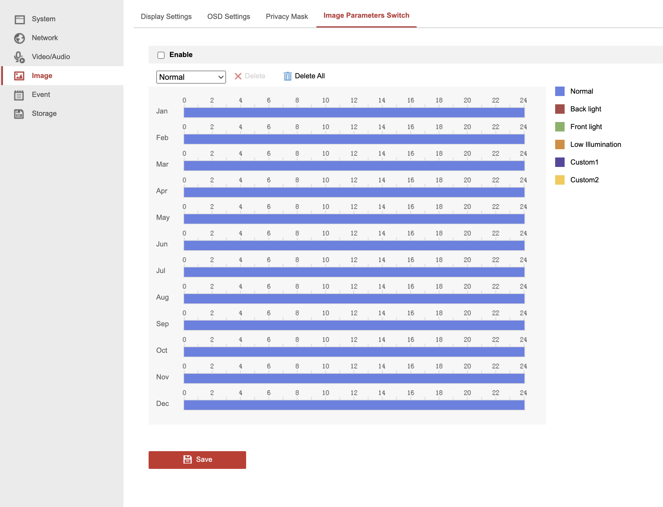

When logged into the cameras directly you should have the below Image Parameters Switch menu which allows you set when camera switches between different image settings, and you can set those different settings for Day/Night by choosing different Scenes (e.g. Normal, Low Illumination, Custom1, etc...).

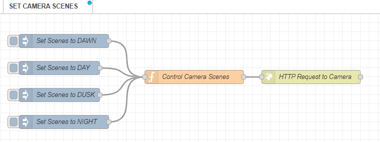

Hi JB... I got the native generic Node-RED http request node working instead of using the Ultimate Hikvision nodes... it's way better this way... only 1 node is required (assumes all cameras have the same username/password) so it really cleans things up...

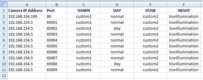

I'm working on adding a spreadsheet (similar to what you did in the other Node-RED thread) that lists the cameras to be updated...

I'm still a bit confused as to what you want to do. The only Image Parameters switch I can find is this one:
That just enables and disables the schedule (which you're not using if you're changing the scene in node-red) Or is that the point?; you want a means to go back to a schedule? If so I've had a look and it doesn't look possible to trigger that on/off using the API; I can't find a command.
That is the one... I can see how I'm confusing things... for now, I still use the schedule to set the scenes... so, as I'm working on this stuff, it would be nice to turn the switch on and off for all the cameras without having to log into each one of the 10 separately...

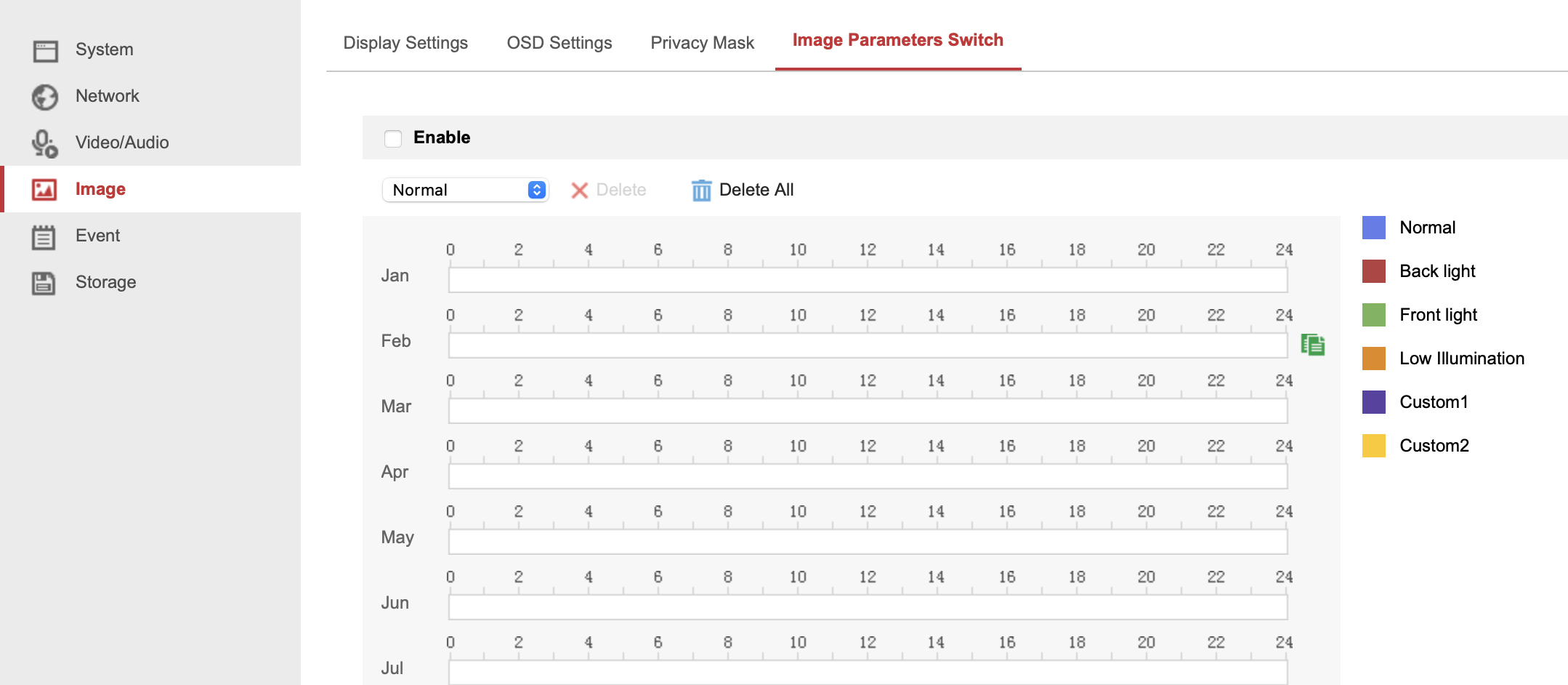

Hi @alfaclvi ... they are not settings like backlight, WDR, BLC... they are scenes that group those settings for the image parameters switch... on the display settings page you will see "Scene"... that dropdown is where "Front light", and Low Illumination" are.
