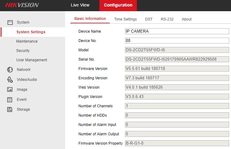

I am also getting this problem, however only with the SUBSTREAM (which is being transmitted for monitoring) and only the Max Bitrate.
The Camera is a DS-2CD2T55FWD-I5 with firmware version 5.5.61: See attached image (Configuration_basic_Info)
The camera is connected via POE.
NVR: DS-7608NI-K2/8P

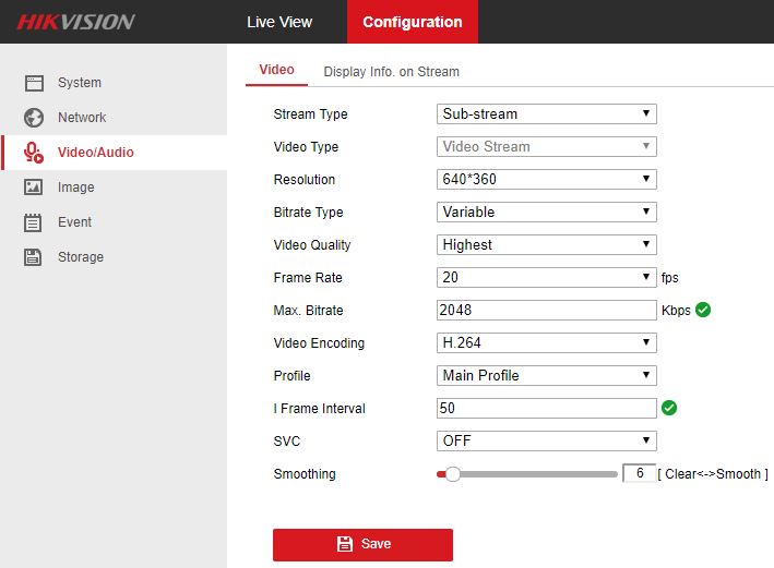

I can recreate the issue with ease as follows:
  • Open camera interface via Chrome (windows 10)
  • In configuration tab -> Video/Audio -> Video: Set Max Bitrate to 2048 -> Save

  • Go to Hik Connect app on phone (Huawei P10 lite (WAS-LX1), Android version 8.0.0 (Oreo apparently))
  • Open live view via NVR

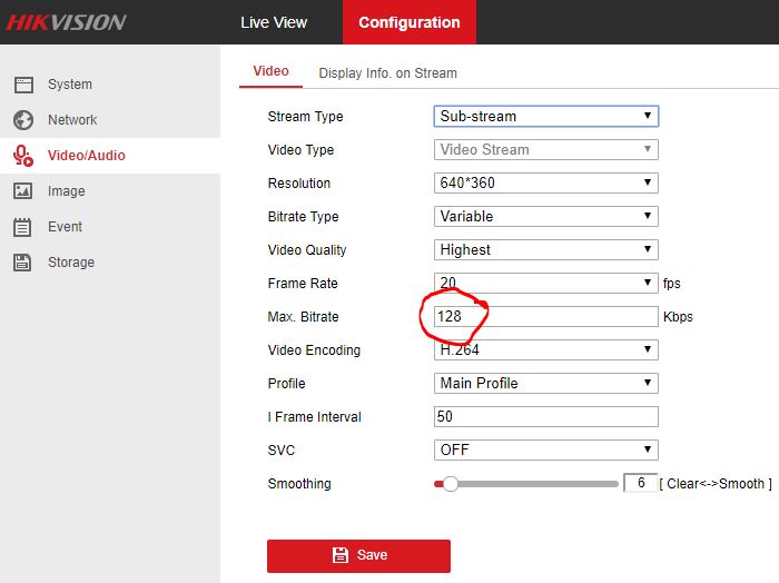

  • Tap on BASIC, tap on HD.
  • Tap on HD, tap on Basic.
  • Go back to web interface, refresh –> the MAX BITRATE is back down to 128, so bloody frustrating.
I have emailed HikVision Africa for assistance, but no real help yet. will send them an update
