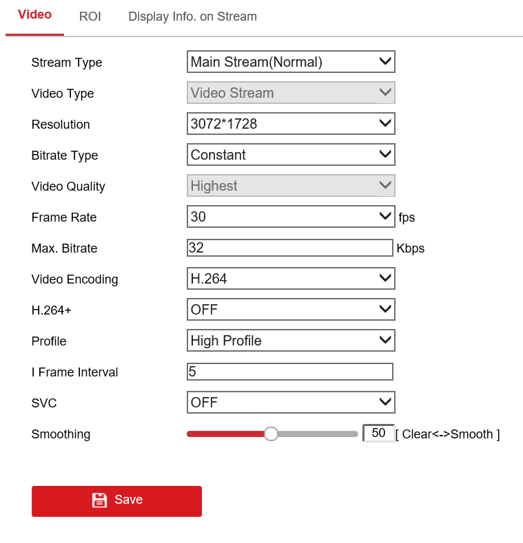

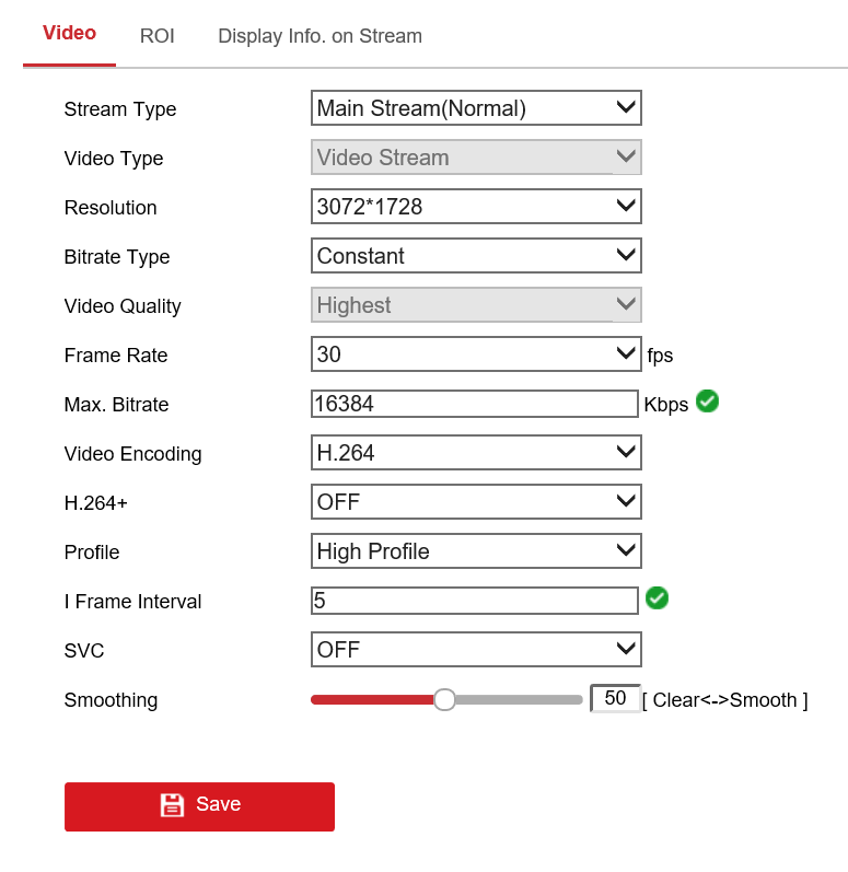

I hope I won't get flamed for reviving a thread that has been inactive for a few months but the issue described above is driving me up the wall.
I have 10 Hikvision IP cameras around my home that record both on their SD cards and a new NVR I recently added.
Two 8MP cameras are trained on the street in front of my house. One of them, the latest I added, is the 2385 turret. This camera is intended for both security but also speed tracking of the cars racing up and down my street. For this application I need 30fps, constant bitrate, 264 codec, and the best possible video I can get.
I am not sure whether any of the other cameras have this same issue, but it feels like the turret is the only one where it is very visible mostly because of its intended purpose. The issue is that the quality of the video keeps going up and down on its own... The only thing I noticed that seems related is that the bitrate downgrades from 16384 to a mere 32 on its own. I can't tell whether it is just a web interface issue, or whether the bitrate is actually as low as 32 (isn't that just way too low?) but setting it back to 16384 seems to make the video perfect. However, there have been cases where the configuration page said 16384 and the video was bad... simply hitting save would make the video good again. This may just be due to the page not updating the setting that got flipped in the background.
While writing this, I refreshed the config page 3 times and the setting changed:

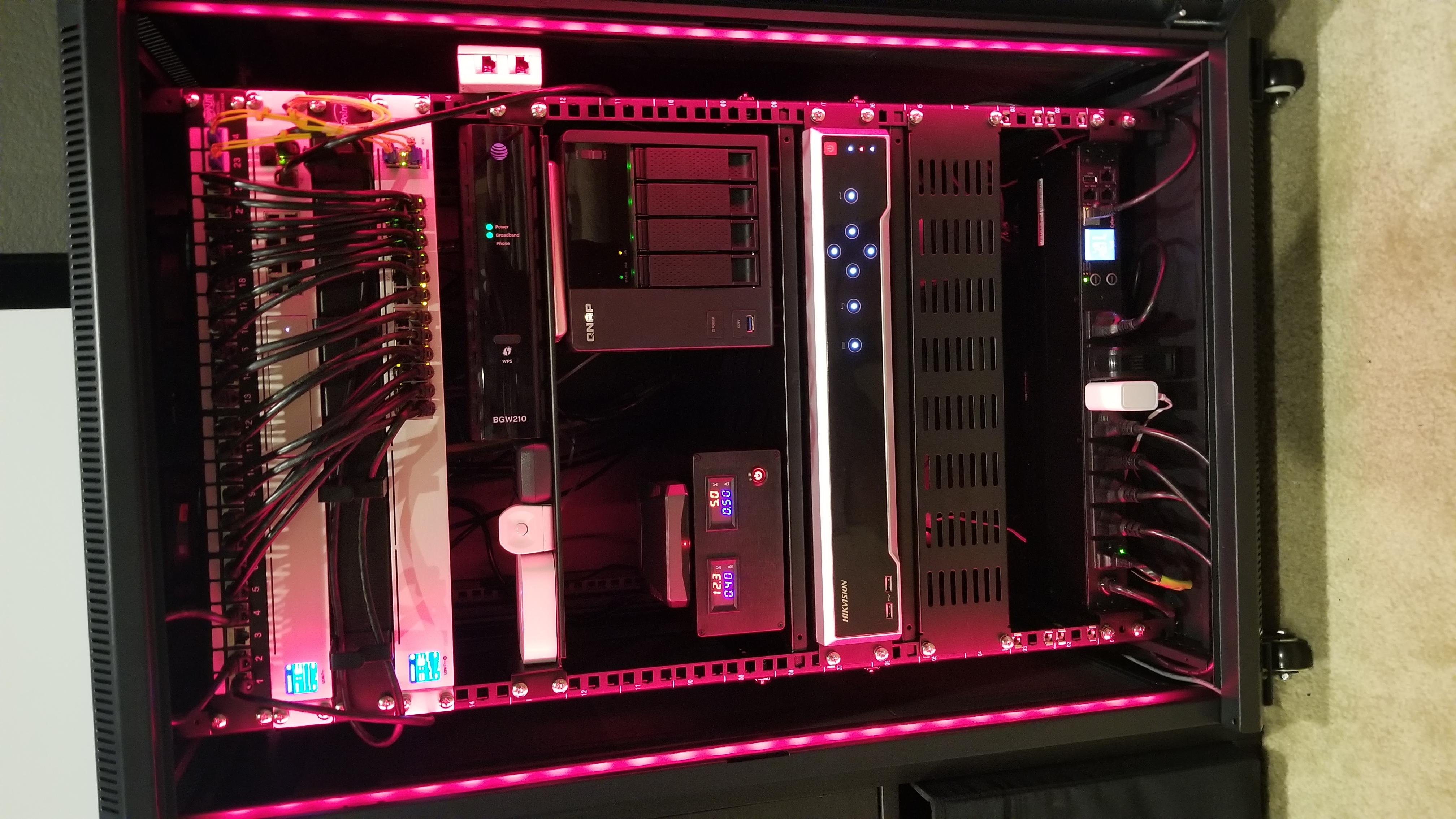

I removed the security software running on my QNAP NAS, and eliminated anything that might access the cameras from it. I eliminated all IVMS software on Windows and Android devices. I only use Blue Iris 5, tinyCam Pro on Android, and the Hikvision 7732 NVR. I looked through ALL settings trying to pick the best option that would not mess with quality but the issue is still there.

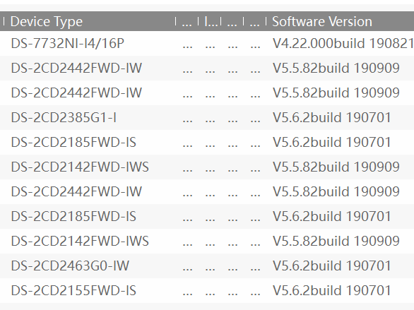

@alruf,
I guess you are on firmware 5.6.2 (I'm not sure which camera from your firmware screenshot is causing problems)?

The common denominator is the NVR. Before the NVR I never had issues of this type. I set the image/video settings in the camera GUI and then ensure it matches on the NVR GUI. I did not know there was a need to reboot the NVR... and since I do not have a screen connected to the NVR, it is a bit hard to do but I will try.
I also wondered whether networking issues might be causing issues however I have a dedicated 24p gigabit switch dedicated to the cameras and the NVR is on the same switch so all internal traffic should be isolated to the switch. In the attached image you can see the NVR and NAS however the NVR is actually connected to a remote switch downstream from the switch in this rack (to keep it on the same switch as the cameras). That remote switch is connected to the core switch seen in this picture via fiber (mostly for electrical isolation purposes).

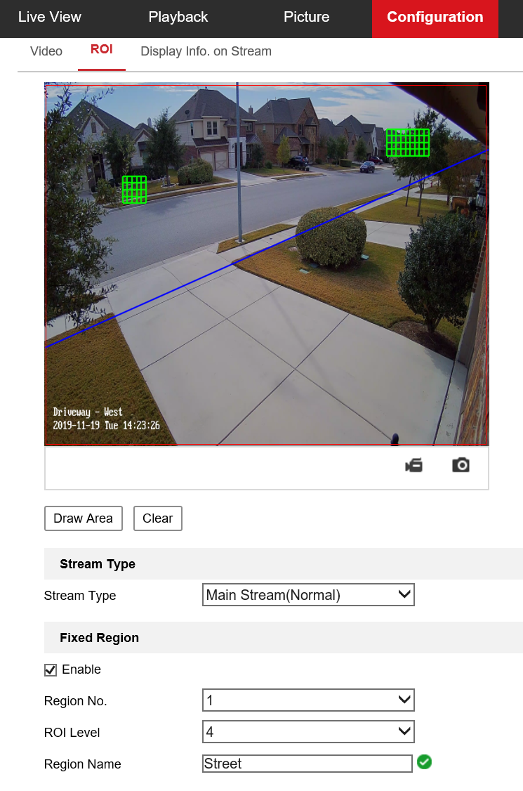

Sorry for 3 posts in a row... I may have found the cause but I am not sure what the proper solution is.
I noticed that when I selected a small portion of the video, that portion would stay perfect even when the rest would decrease in quality. I am not sure why it is behaving like this given I have never had this issue and never used ROI... anyway, by selecting the entire frame, and setting a ROI Level of 3 or 4, the quality stays good. With a setting of 3 the data rate seem to be the same as before, with 4 it increased to 3.3MB/s. Beyond 4, the rate approaches 4MB/s and my Note8 starts choking (or whatever it is) and I get lots of dropped frames.
It would appear that something is telling the NVR, or camera, to drop quality to make up for a bad connection (weird that I've seen this happen at home on my Wifi just under one of my APs). I wish I could turn that off... My goal is to record at max quality all the video. Remote viewing at high quality is a bonus. I can always switch to the crappy sub-stream if needed.

@rompik - Thank you for your suggestions. I will definitely try them if the issues continue with the latest changes I made. By selecting the entire frame and setting a ROI of 3 or 4, the problem seems to have gone away. I still think it is a bug of some sort and that setting the ROI is a workaround but at least I am getting video of the quality I want. I would recommend you try this on the camera where you have sudden pixelation as it sounds similar to what I am seeing.
