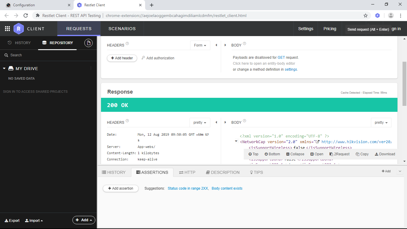

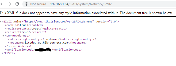

Anyway, I followed your advice and I received the 200 OK response from the RestLet tool.
Please see attached.

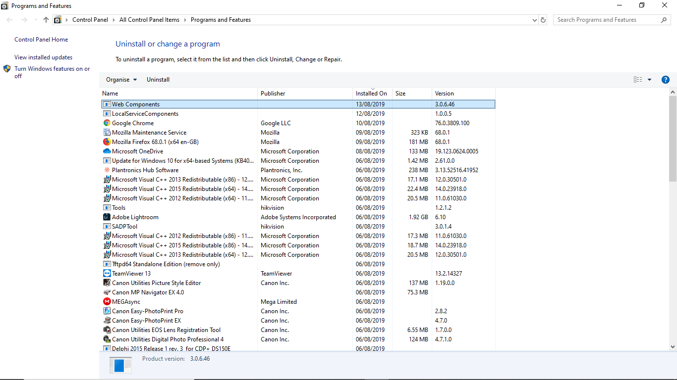

I have always installed the plug-in when prompted, however when I followed Stewarts advice I uninstalled the version installed by the camera and installed the version in his post.
After I installed the plug-in manually I no longer received the plug-in notices.

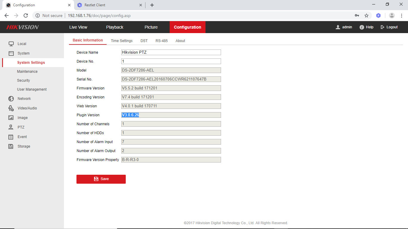

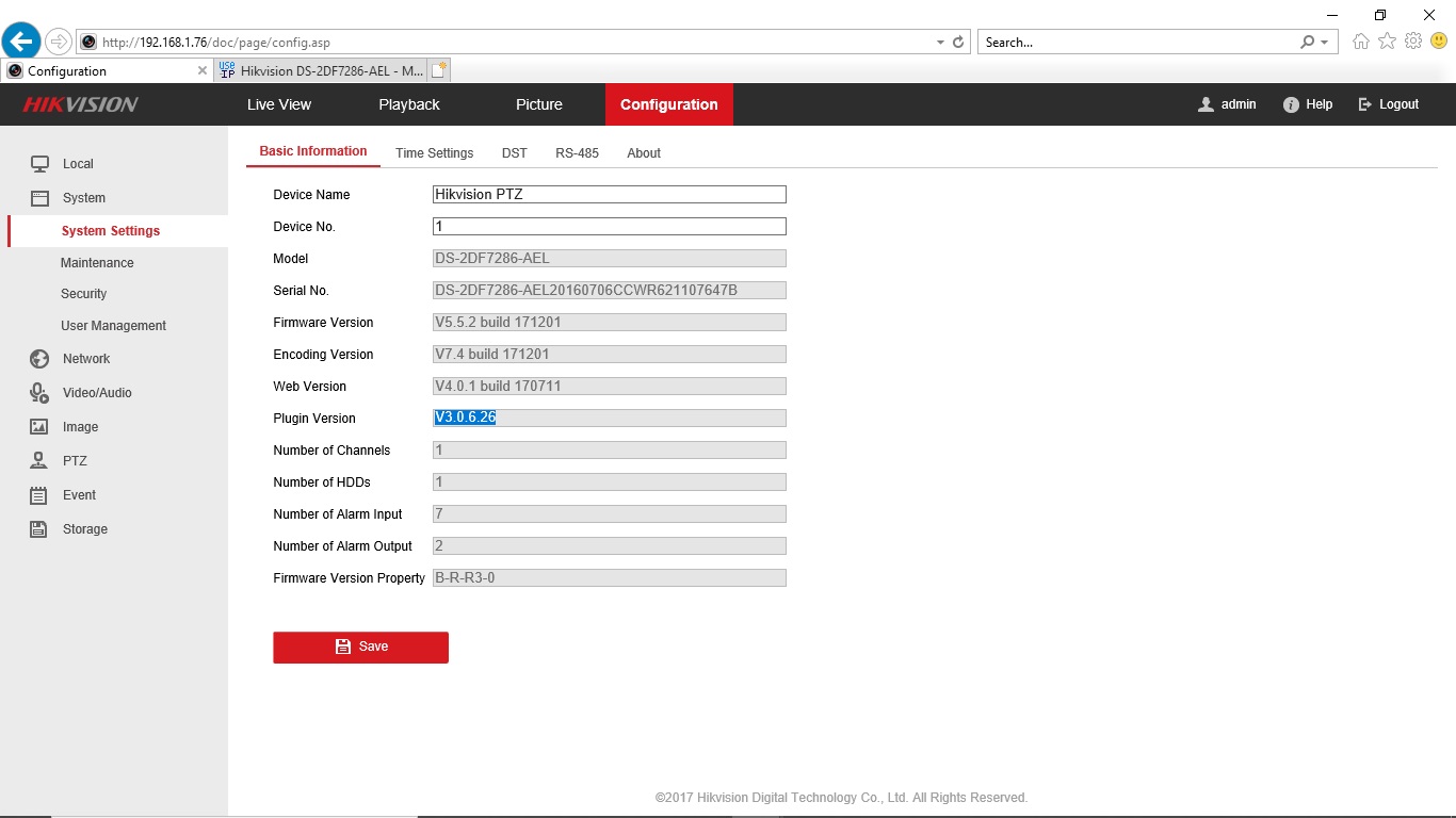

The version shown in Windows is now Plugin Version V3.0.6.46 but the version for the cameras is still 3.0.6.26. I'm not sure if that's due to the cameras firmware or whether the cameras web interface, if so, does that mean its picking up the incorrect version.
Hope that made sense?
Here is a screen shot of the version installed in Windows 10 and the version shown on the cameras settings page:-

Looking for this - <isSupportPlatformAccess>true</isSupportPlatformAccess>
Glad to hear you get Response 200.
Please amend and paste this into Chrome:
I'm hoping you get a something similar to the following. Paste what ever comes back please.
The response from this would help to:
Response from the 1st request was:-
This XML file does not appear to have any style information associated with it. The document tree is shown below.
<ResponseStatus xmlns="http://www.hikvision.com/ver20/XMLSchema" version="2.0">
<requestURL>/ISAPI/System/Network/EZVIZ</requestURL>
<statusCode>4</statusCode>
<statusString>Invalid Operation</statusString>
<subStatusCode>notSupport</subStatusCode>
</ResponseStatus>

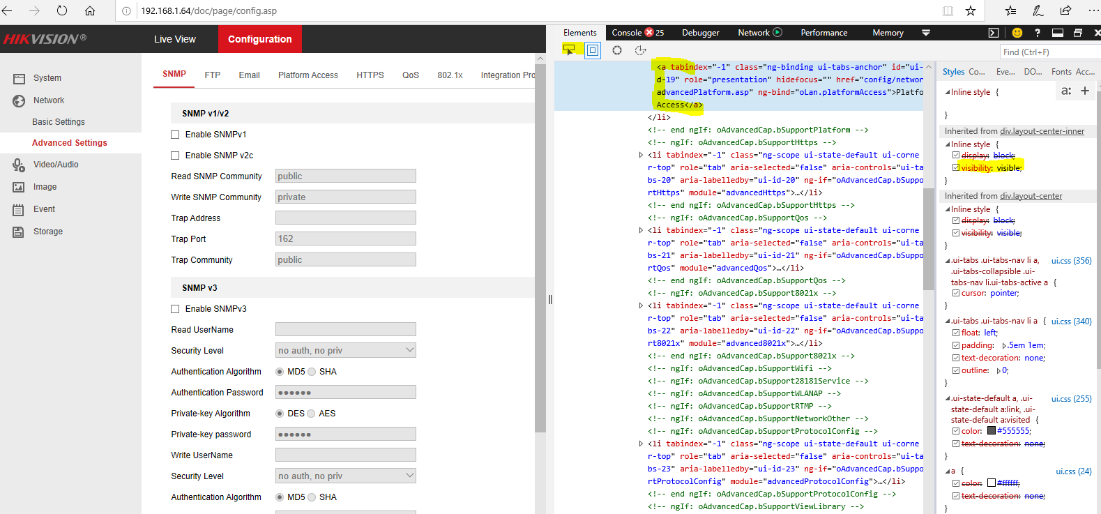

While I'm clutching at straws, have you tried inspecting the HTML of the webGUI? Normally pressing F12 in a browser will allow you to inspect the HTML. Click the selector icon and move the cursor over the menu bar of the advanced settings. I'm curious if the Platform Access item is there but hidden via CSS styling. This really isn't the way to be going about it but desperate measures...

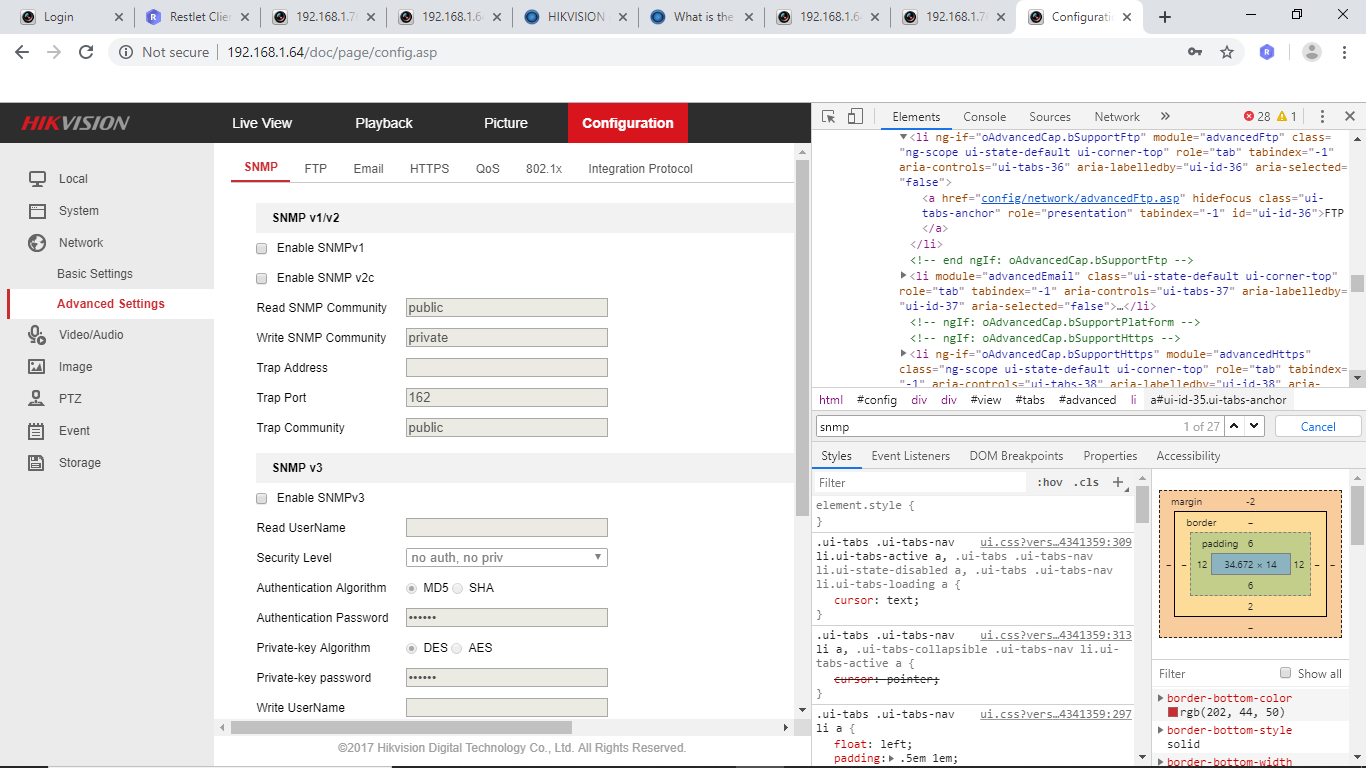

Hi Stewart,
I rechecked the original settings, ONVIF etc and they were still the same as before.
I have used Chrome to examine the webpage and even performed a search for PlatformAccess but alas it doesn't appear anywhere.
I think I was in the right area when I tried to find the missing option - please see below.

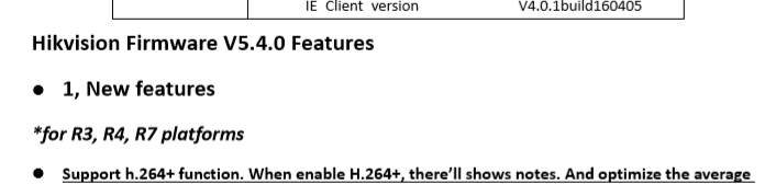

I'm not clear on what he was suggesting either. LPR is definitely refers to license plate rec. On a side note, the firmware release notes for v5.4.0 and v5.4.3 refers to compatibility across the R3,R4 and R7 platforms. Might the firmware for these models be cross compatible? On the download section Hikvision’s portal, the R7 the firmware is much more recent. If anyone has had success loading it I’d like to know. It’s not something I recommend otherwise in case you brick the camera.
