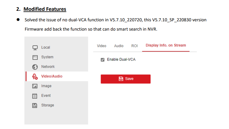

FYI. Hikvision has a newly released firmware for the G5 series cams which claims to fix the issue of the missing Dual-VCA option. in version 5.7.10 dated 220720
Firmware is on the hikvision.com site and appears as 5.7.10 build 220830.
Release note extract below.

Thanks @venturis
We've created a new thread for this firmware release, once you have installed the update please share any discoveries/issues you find in the new firmware in the thread linked below:
