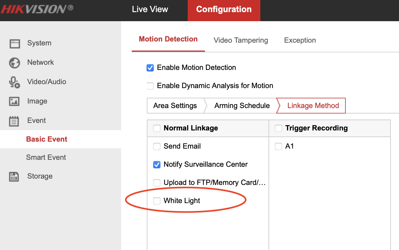

Can someone tell me if the newest version of firmware for my camera includes the "LED on with motion" option? I had to roll back firmware last year to 5.5.114 because the newer version did not include this feature. I'm hoping the latest version of firmware for my camera will include this feature, let me know. Also, can someone provide a link to where I can download the new firmware? See attached for my camera specs. Thanks.

Well, that's a huge bummer. What does the "flashing alarm" do? Does it flash the LED? I like the setup I currently have where the LED turns on with motion and lights up the dark alley. I can't imagine why Hikvision would get rid of this feature as it startles people and scares them away.
Does anyone know of any similar cameras that will allow for the LED ON with Motion?
@Black Diesel Hikvision removed the ability to trigger the white light on motion in the G2 colorvu models and only support this on the liveguard models (LSU/SL) with the latest firmware. Customised firmware 5.7.2_211228 was the last revision that supported this on G2 colorvus.
Not sure if the liveguards were as limited as your screenshot for the light on motion in earlier firmware revisions however it's split up into a couple of menus and lets you set a schedule for the light to trigger as well as set the flash frequency or have it stay on permanently for a set duration
Got it. Can I set it up for the light to come on with motion and not flash? I don't want it flashing, I just want it to come on for whatever duration I set it to when it's triggered with motion. Thanks in advance.

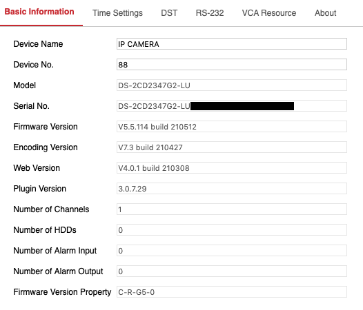

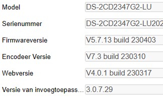

I have a DS-2CD2347G2-LU with latest firmware and the white light is working (supplement light and alarm). Like many others I tried all new firmwares but as this function was missing I rolled back to the custom 5.7.2..
Maybe because all of the rollbacks I start suffering from gaps in the recording (NVR 7608 I series) and spontaneous reboots (see post#19). I also found out, that when I login with hik connect and not ivms the output is set to "video only"and not sound
To solve this I start upgrading again, did restores, fresh installation, restore etc., but the white light functie is still there! My other problems also unfortunately

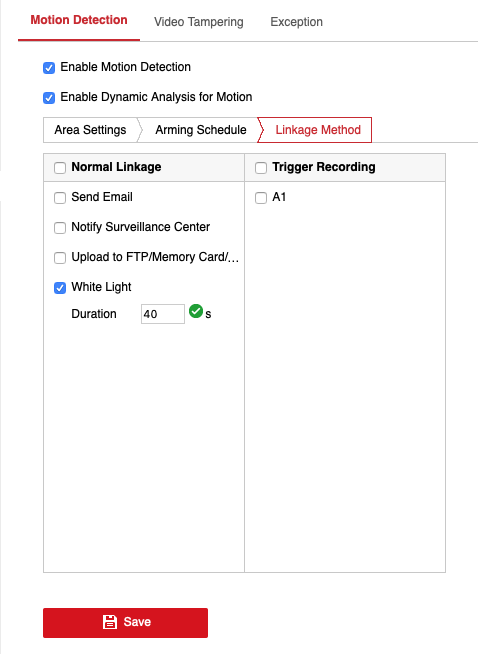

Yes it does. You have a G5 LU model which supports White Light on event in the latest firmware.

That's correct. The L(U) model and the LSU/SL models both use the same firmware version (G5 for the newer c revision models); however the LSU/SL does not support white light on event as it has the strobe light.
They did previously but it is present on version 5.7.13 (and was on 5.7.12 as well so it's been available throughout 2023)
You cannot get your model to flash as it does not have the strobe light. You just need to load 5.7.13 and that will support the LED being linked to an event as shown below (screenshot from G5 camera with 5.7.13):

No they haven't got rid of it with the newer cameras. There are two different variants:
Models ending LU - Has the feature (as it has no strobe/flashing light)
Models ending LSU/SL - Does not have the feature. It has a separate strobe/flashing light
Both of the above variants are current models - the LSU/SL model is not a newer version of the LU. They're the same model but the LSU/SL has two way audio (microphone and speaker) and also the strobe light. So for your numbered queries:
1 - If you want the static white light on event, then yes you need to get the models ending LU (2347/2387) but as stated above they're not an old model. They are current.
