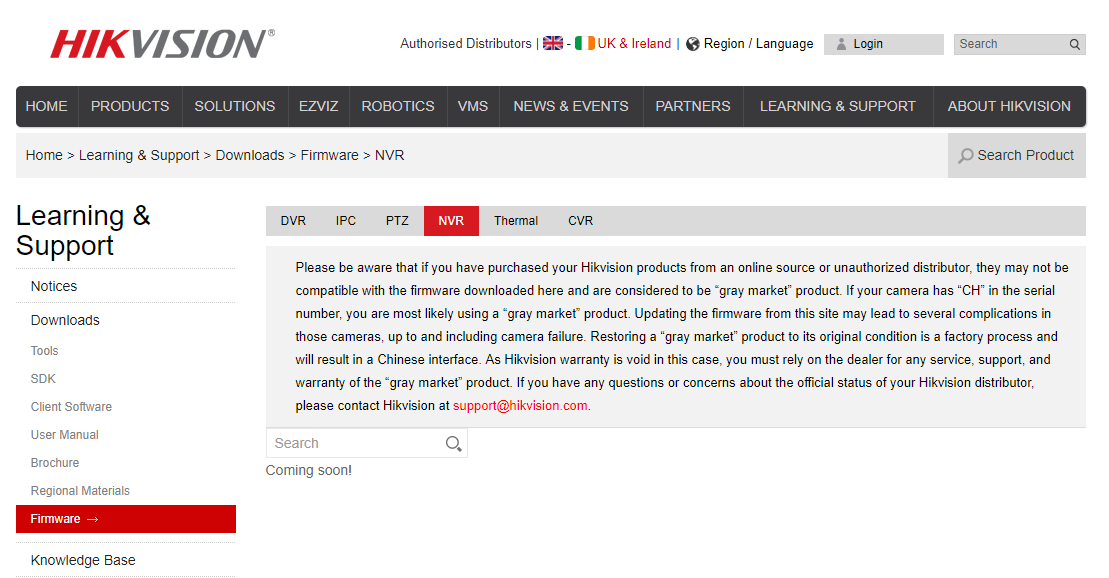

I also checked the Hikvision UK website for their steer on the latest NVR firmware - unfortunately it only shows the below - which does not help :(
Update and advice from Hikvision UK Tech Support today - 24th January 2019:
Hi Phil,
Thank you for your email. There have been reported issues with the latest firmware version hence it has been removed from our online portal. Please install V4.1.63 build 190111 as this is a more stable version - see link below.
