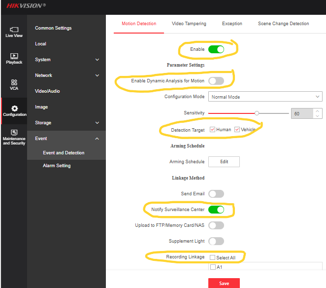

What "minimum" settings are required on a G5 camera to have the motion markers? Which of these must be turned on:

  • 'Enable' - required as a minimum
  • 'Enable dynamic analysis' - not needed. It's used to visualise the motion in real time on the web ui or iVMS.
  • 'Detection Target' - needed to differentiate between generic, vehicle, human. I use just 'Human' in the event setup, so if I select the Human filter on either the local UI or Hik-Connect during playback it'll show markers; however if I select the Vehicle filter in playback there will be no result for me (as that info is not being passed back from the camera to the NVR when the detection target is not selected). So if you select neither, you won't get any result in Hik-Connect (other than using the 'Event' filter which will show everything). Correspondingly the Human/Vehicle filter in the local UI normal playback will show nothing (though event playback would show everything - human, vehicle, animals, leaves, shadows)
  • 'Notify Surveillance Center' - not needed at all for the markers; it's solely for the push event notification and snapshot/clip in Hik-Connect.
I use a motion setup covering most of the screen with the detection target set as 'Human' and 'Notify Surveillance Center' disabled combined with line crossing or intrusion only on my property with 'Notify Surveillance Center' enabled. Using two different events for on/off your property gives the best results for me; a notification when someone is on the property but also an easy means to search video for people outside of your boundary if needed (my road is too busy to select vehicle). TBH sometimes I find motion gives less false alerts than line crossing/intrusion for me. In an ideal world Hikvision would alter the firmware to allow 'Notify Surveillance Center' to be enabled/disabled per motion/line/intrusion area, rather than globally for each detection type.

About the Dynamic Analysis, according to their instructions on the
they say: Notes: If search motion detection VCA playback, Enable Dynamic Analysis for Motion is necessary
Strange - I've never had it enabled but always had the function working (pre 5.7.15 and before). I'm not sure what's gone on this morning. All of my cameras were on G5 5.7.15 with motion detection markers working after installing the new build to fix the issue. As soon as I've changed one camera to 5.7.19 motion markers are no longer displayed, downgraded it back to 5.7.15 and it's still not working. I've no faith that Hikvision can release anything that works at the moment...
