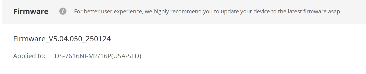

The new M series firmware is available on the US website:
DS-7616NI-M2/16P
I'm going to try loading it now...

loaded fine...

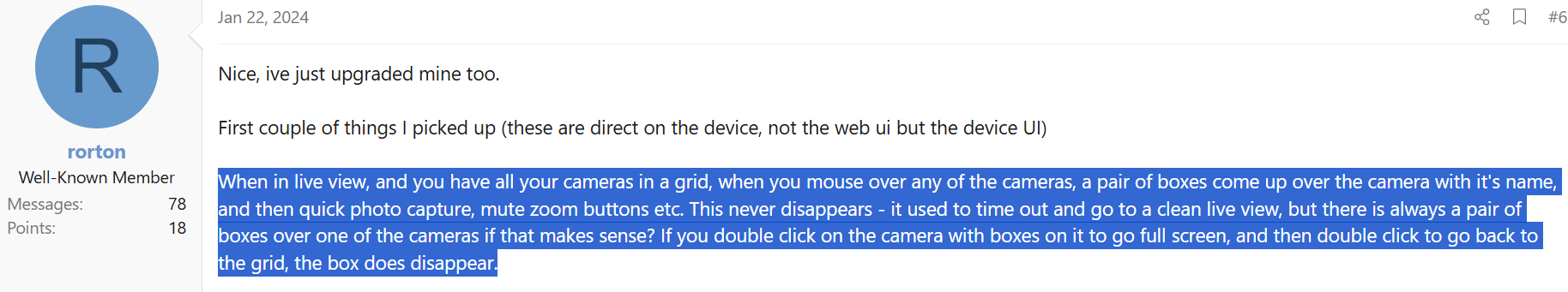

I promise this is the last time I bring this up since it seems like only @rorton and I care...
This started with V5... I liked the way the menu bars timed out in the V4 live view... kept hoping they would change it back, but I guess it's a new feature, not a bug... oh well :)
I hate that too. And the audio being muted on Liveview as soon as the screen lock cuts in. I now have to leave mine unlocked or I don't get audio on the HDMI output.
