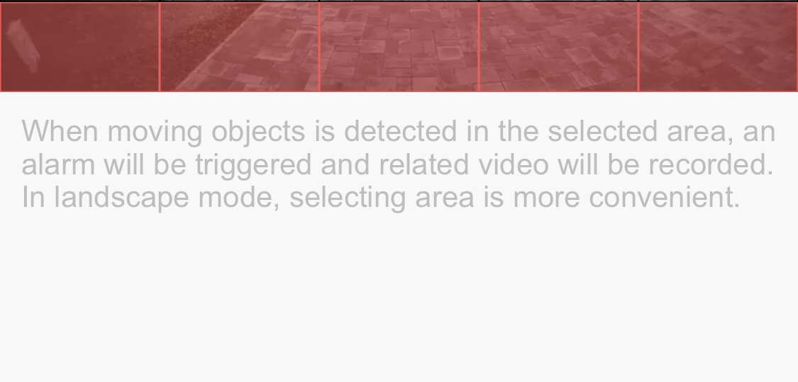

Hi guys! Was wondering if it possible to get a short video clip/photo when the motion detection alarm is triggered if I have a standalone unit? I read through the threads and know it was not available before but given that some time had passed perhaps Hikvision stepped up. I can’t find any useful information but the Hik-Connect App says that when the alarm is triggered a short video will be recorded. I have the outdoor unit without an SD card. I dont have the indoor unit or a NVR or DVR just an iPhone and the Hik-Connect App. Will getting an SD card do anything for me ? Thanks in advance for any feedback!

I’m afraid not. I connected mine to my NVR which I note you don’t have. You maybe better with a Ring (wash my mouth out now)
