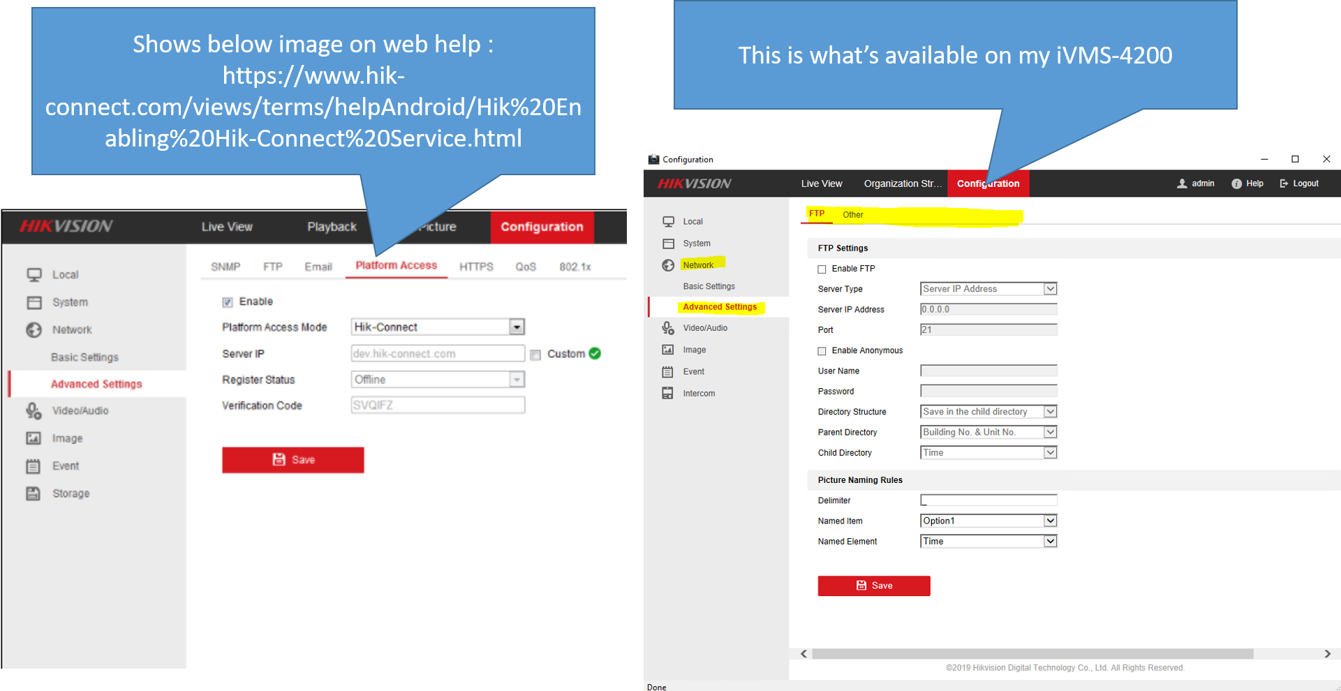

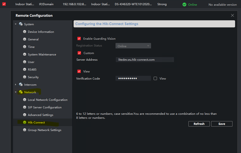

Wow ! After many (many!) hours of head-scratching & confusion I think you may have answered what I'm experiencing ! I just purchased a DS-KV6113-WPE thinking, like you stated, that it would ring my mobile phone (YouTube vids and other references showed/suggested this!) and i'm having a nightmare attempting to do this ! I've honed in on "you need to get it on 'Platform Access' in the advanced network settings however I don't have that tab/option in iVMS-4200 (or on the web config page - see attached image). What i'm REALLY interested in is the bit where you say "The only way, as you mention above, is to connect the Indoor Station DS-KH8301-WTS on Hik-Connect server and after that you can receive a call on your smartphone or tablet"... Is there any chance you could advise on how that's done ? Note: My Indoor Station model is DS-KH6320-WTE.
I've also attached the Indoor Station config and can see it's got some server address on it (not sure what that's supposed to be !? Put the address into web browser and that doesn't do anything at all ?! :(

Hi @MarkTotnes
You are halfway there with the Hik-Connect setup, you have enabled Hik-Connect in the platform access menu of the Indoor station. (there is no Hik-Connect option in the Intercom settings because the intercom has to be linked to an indoor station and then that indoor station is linked to Hik-Connect)
The next step is that you need to go to the Hik-Connect Portal and login/create an account (if you have already created an account in the Hik-Connect app then it will be the same details for the portal, if you haven't created an account in the app then create one at the portal and then use those same details to login to the app)
Once you are logged in you should see an option to add a device, click this and a box will appear asking you to enter the device serial number which you can find on the label attached to the indoor station or the box it came in.
When you click ok it should find the device as you have enabled Hik-Connect and you should be able to add it to the Hik-Connect account, it may ask you for an encryption/verification code which is simply the code you set when you enabled Hik-Connect on iVMS-4200.
If the device is successfully added you should then be able to access the intercom by logging into the Hik-Connect account on the app and when you press the call button on the intercom it should ring via the Hik-Connect app.

Hahahahaha - Dan, YOU ARE A STAR ! It was as simple as you said !!!! :)
After soooooo many hours of looking around the web, I'm sure that the link you provided 'Hik-Connect Portal' is the first time i've landed on a page that actually matters !!!!
Holy smokes ! I feel like putting a proper 'How to get a DS-KV6113-WPE to ring your mobile...' document/steps together for any other poor souls out there ! Heck - A lot of people appear to be stating 'it doesn't do it' and 'cant do that' on various groups/forums etc...

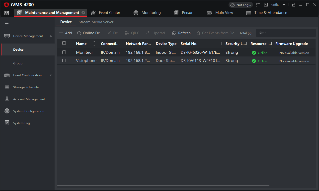

I tried with iVMS-4200, following the video here, and my DS-KV6113-WPE1 is not recognized as a card reader (video 7mn 30s) : the list is empty.

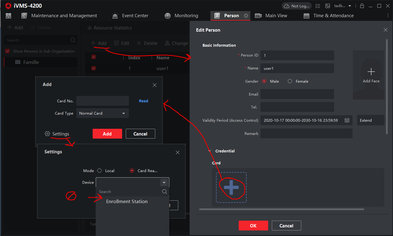

I think that there is another problem, because when I want to add a card to a user, I'm supposed to have my DS-KV6113-WPE1 in the list of remote card reader, but the list is empty (see images bellow).
Even if I try to enter a dummy id card, and I try to apply the user to the videophone, I've got an error...
Maybe I'm wrong during the configuration...
Best Regards

That is a master programming card as noted in the instructions, you cannot add it as it is used to programme other cards. You need to buy some cards or tags, then place the programming card on the reader you hear the bleeps, place a blank card on and then you hear a single bleep I think, and the place the programming card on for a second time and it has programmed the new card

Not sure if you’ve reading the post you’ve referenced fully, or I’m not getting it. The master card cannot be used as a card only ever as a programming card to program other new cards to the system.
