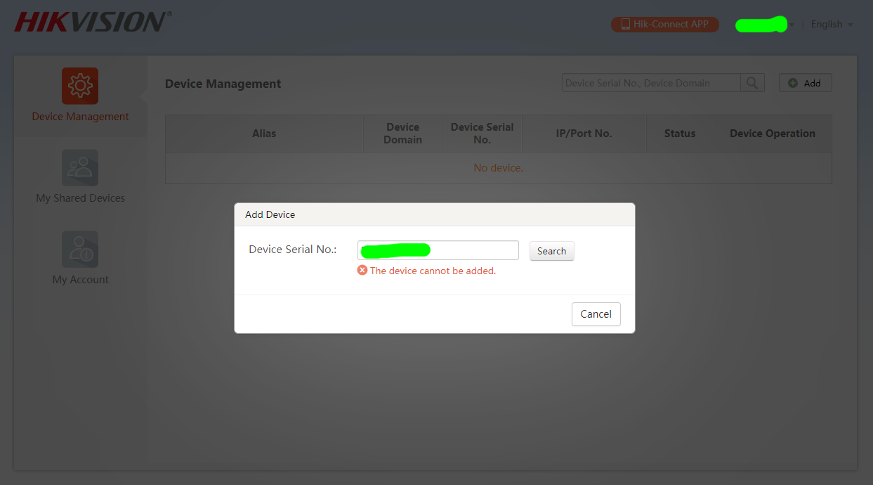

If I click on ADD and type in the serial number off the box my camera came in.
I get the following message: The device cannot be added.
I was presuming I was getting this error as Hik-Connect is not yet enabled on my camera

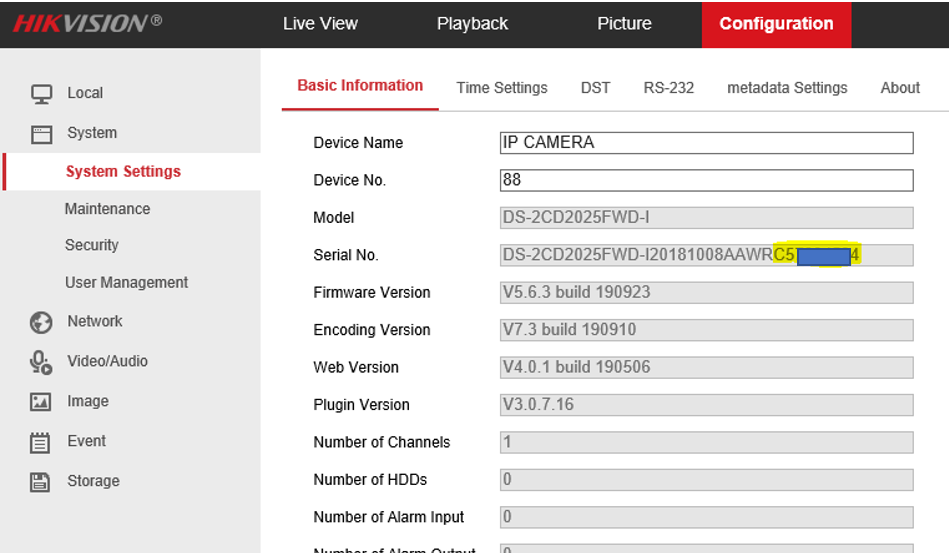

Use the last 9 digits of the serial number when adding a device on the Hik-connect portal. If the device is not found it's your network settings as Phil mentioned.
Thank you, yes, those last 9 digits are the ones I have only ever used.

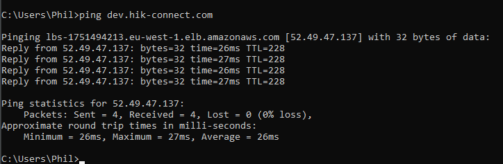

Please see 3 iii and see if you are able to ping the hik-connect portal please:

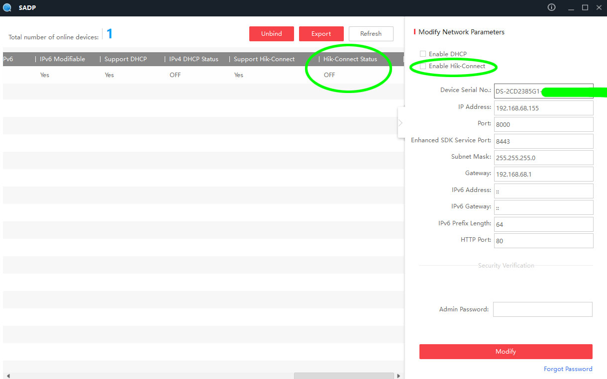

Unless I'm misunderstanding something, this looks off / not enabled to me (not that I know much!) :(
Don't worry about that for now please.
It is a way of initiating Hik-Connect from SADP, but is failing for your setup.
I am trying to work out why.
For some reason, your camera is unable to 'call home' to the hik-connect portal via your network, router, etc. - even though we have now checked all of your settings.
Can you please try the ping test to the portal - shown at #26 above.

As I had explained a number of times, every time I tried to enable Hik-Connect using SADP I would get the error I have posted in previous posts.
What however I was totally unaware of, until I saw a screenshot following the link was that it is also possible to enable Hik Connect via the Devices Web Page. Under Network / Configuration / Advanced Settings. And select Hik-Connect from the drop down box there.
Once I knew that setting was there, I went to it, enabled it, set a password, and saved. Upon reloading SADP just to check, it's now showing it enabled.

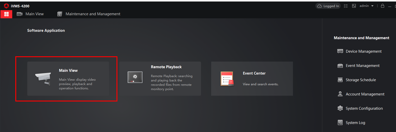

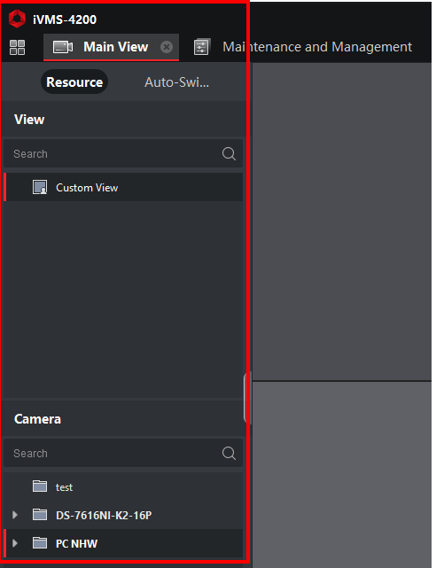

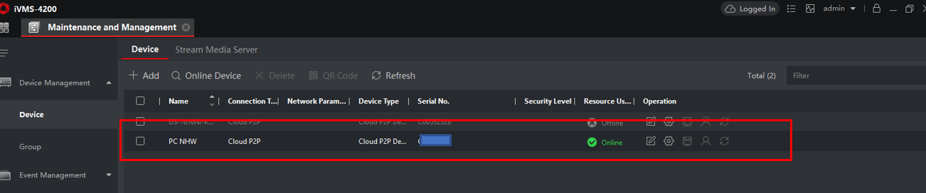

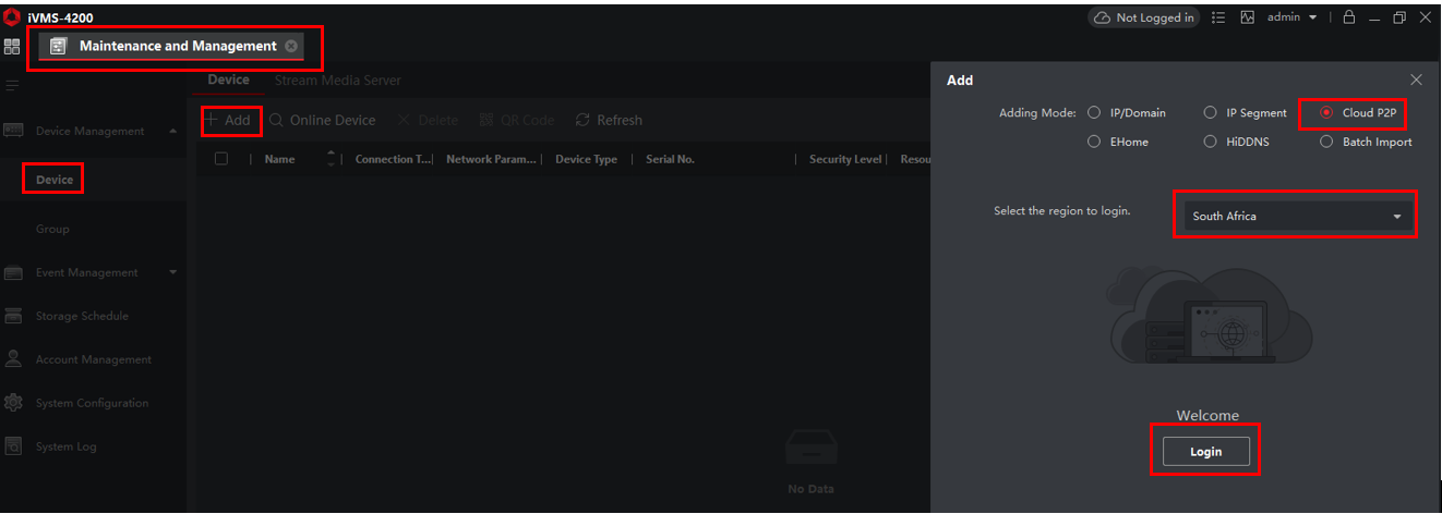

You could load iVMS-4200 on your work PC. Under the Maintenance and Management option. Click Add and select Cloud P2P. Select your region and use your Hik-connect credentials to login. This will allow you to view your camera.
Thanks, that's great to know.

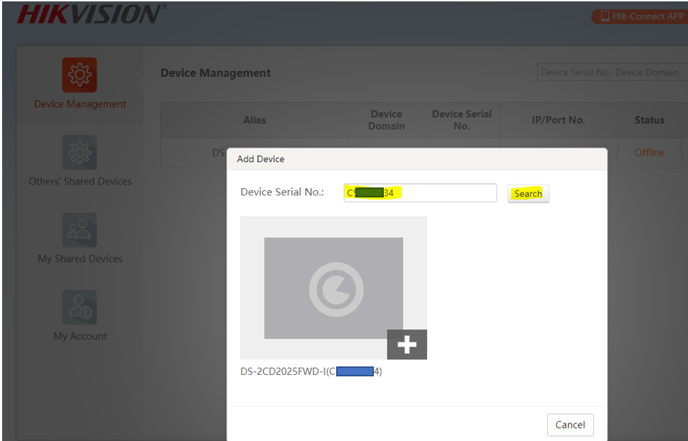

We usually recommend that people set the camera up with a browser first, then add the device to the web portal, and you should then see the device on the Hik-connect app. The steps to do this are below:
1. Find the camera with SADP and make sure it is activated
2. Browse to the cameras IP address with Internet Explorer and login
3. Go to Configuration > Network > Advanced Settings > Platform access and make sure Hik-connect is enabled and a verification code is set (this can be the same as the cameras password although I don't think they will let you use special characters)
4. Login to the Hik-connect portal using the same login details you used on the app
5. Click add device and enter the cameras serial number
This will be why you were getting the error code when asked for the verification code as this is set by the user in the Platform access settings before you try and add it to the app.
Make sure before you try to add the device to the web portal that you have deleted any trace of the device from the Hik-connect app on your phone as it may not add if it thinks the device is already connected.
