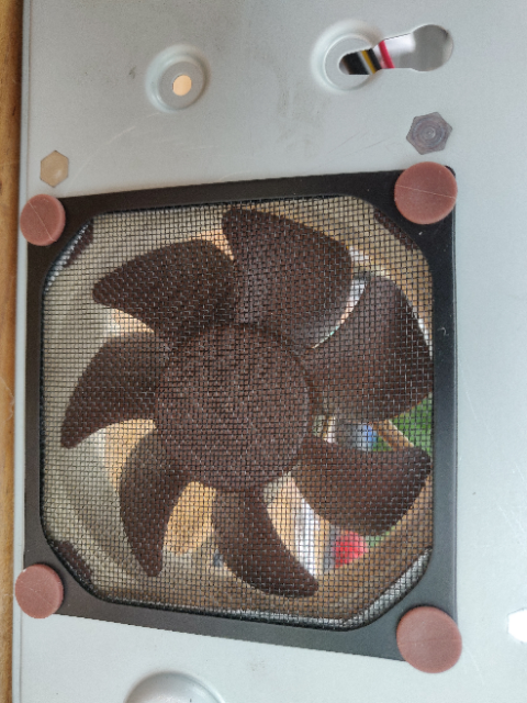

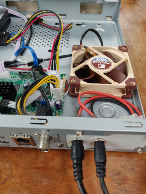

Hi. I finally jumped and added the external power brinks to my 7608NI-I2-8P.
Using Noctua NF-A4x10 PWM (40mm) to replace the case fan and a Noctua NF-A8 ULN, (80mm) as a new addional fan to bring air in.
No fancy video, but similar to mozso using Dremel to cut hole into bottom and using a fan dust filter as cover.
Decided to use 80mm fan to keep space for second HDD if needed.
Had some leftover steel to make cover for the back (where psu was originally) and to hold the new switch and cable connctors)
Ordered wrong rocker switch for the back (doh), so while waiting for the new one to arrive, switching both power bricks at the mains socket.
The small case fan is still faily noisy. Using the low noise adaptor coming with the fan for now. but might end up cutting out proper hole in the case cover and put a small 40m dust filter in. the noise caused by the air passing through the openings is still not ok. (when done, i'll remove the low noise adaptor again to improve airflow)
Some pics below.

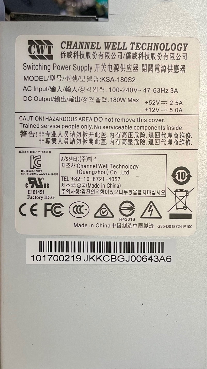

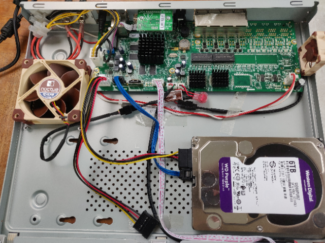

Like many other threads on here, I found my new DS-7608NI-K2-8P unbearably loud. It has a channel well technologies PSU (KSA-180S2) with a 12v 5A rail, a 52v 2.5A rail and a really noisy 40mm fan, and then a second not-quite-as-noisy 40mm fan on the case.
Everyone has a different sensitivity to this sort of a noise so I've seen some people say it's fine, and that's great for them. But mine was shut in a thick walled cupboard with a heavy tight-fitting door, and it would still be loud enough to irritate me enough if sat in the same room, to have to change room. These sort of fan noises have a quality factor as well as a loudness factor, and the NVR PSU was definitely on the nasty noise side a metallic, slightly varying and grating on the mind noise.
Anyhow, I've seen a variety of people on forums replace the fans to slight to good improvements, but if I was going to cut into the box around I wanted a full solution to make it (virtually) silent. I've also seen a number of people suggest replacing the power supply with external bricks, though not actually do the work. So that's what I've done.
This is a 60W 12v 5A power brick from Channel Well Tech I used for the first rail. The three yellow wires on the existing CWT PSU pigtail are all positive 12v, the black wires ground
https://amzn.to/2RxxRzf
This is the 52V 2.7A power brick from DSLRKIT specifically for PoE which is why the second rail needs the greater power, which I used for the second rail. Unfortunately Amazon has stopped carrying it since I purchased it. No idea if that is a good or a bad sign, but you'll find the same model elsewhere, or I'm sure other PoE power supplies would work. The old pigtail is 52v positive red, and black ground (at least consistent - but do check on yours!)
DSLRKIT AC 100-240V to DC 52V 2.7A 140Watt Power Supply: Amazon.co.uk: Electronics
These both come without kettle leads, you'll need two (I had some old ones kicking around)
https://amzn.to/2S3BmlU
I used a Nexus 92mm fan. Nexus make (made?) superb fans and I use in my silent PCs this one I had spare. Unfortunately their website is either down or they aren't trading any more. Basically just get a high quality fan of as large a diameter as you think will fit in the case. Silent PC review will give almost all the info on fans. One of the things they are good at is dealing with the subjectivity of fan noise, not only will these fans be REALLY quiet, they also give off a very neutral/softer (to my ear) much less obtrusive steady white noise. Basically though any high quality 80/92/120/bigger fan from Scythe or whomever, is going to be enormously better than the original 40mms and move plenty of air.
Fan Roundup #6: Scythe, Noiseblocker, Antec, Nexus, Thermalright | silentpcreview.com
So putting it together then.
The most likely thing to get wrong here is connecting the new power bricks to the pigtail in the wrong way and frying the board. So use a voltmeter and measure twice, cut once.
In general if you aren't comfortable with working with electricity, a voltmeter and a soldering iron stop. Or if think your boss will object to what you're doing with the kit, or the PAT tester might next time they visit the office also stop!
Steps
Carefully checked all the positive and negative voltages on the existing setup and the new bricks and labelled positive really carefully.
Removed the old power supply
Cut the pigtail off the old power supply, chopped the plugs off the end of the power bricks, and used chocolate block connectors to connect a to b
I wired the fan into the same 12v power rail and hot glued it to the bottom of the case where the holes are.
And then reassembled and plugged it in. Works fine (pictures enclosed)
Sound level.
Now acceptably quiet, quieter than most of the laptops in the house, I'd have to concentrate to hear it over this laptop with the cupboard door shut, with the cupboard door closed it's basically unnoticeable. The noise in the cupboard if you put your head is now a much more tolerable shhhhhhhhh noise, rather than the shrieky and grindy old one. But the 92mm fan at 12v still makes an appreciable amount of noise, and there is a lot of nasty aluminium undamped, un-braced surfaces in the box, so it definitely could be a lot quiter.

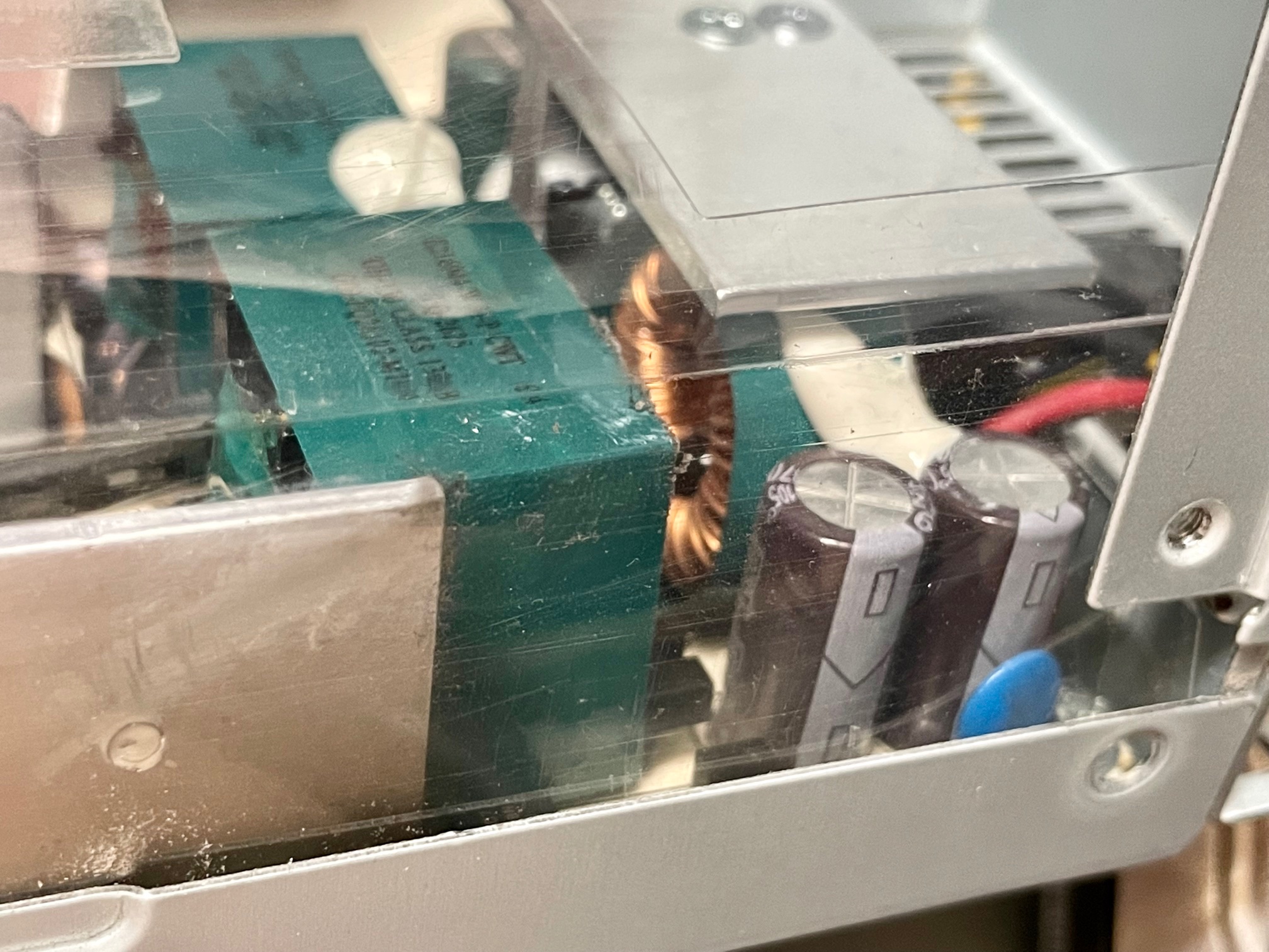

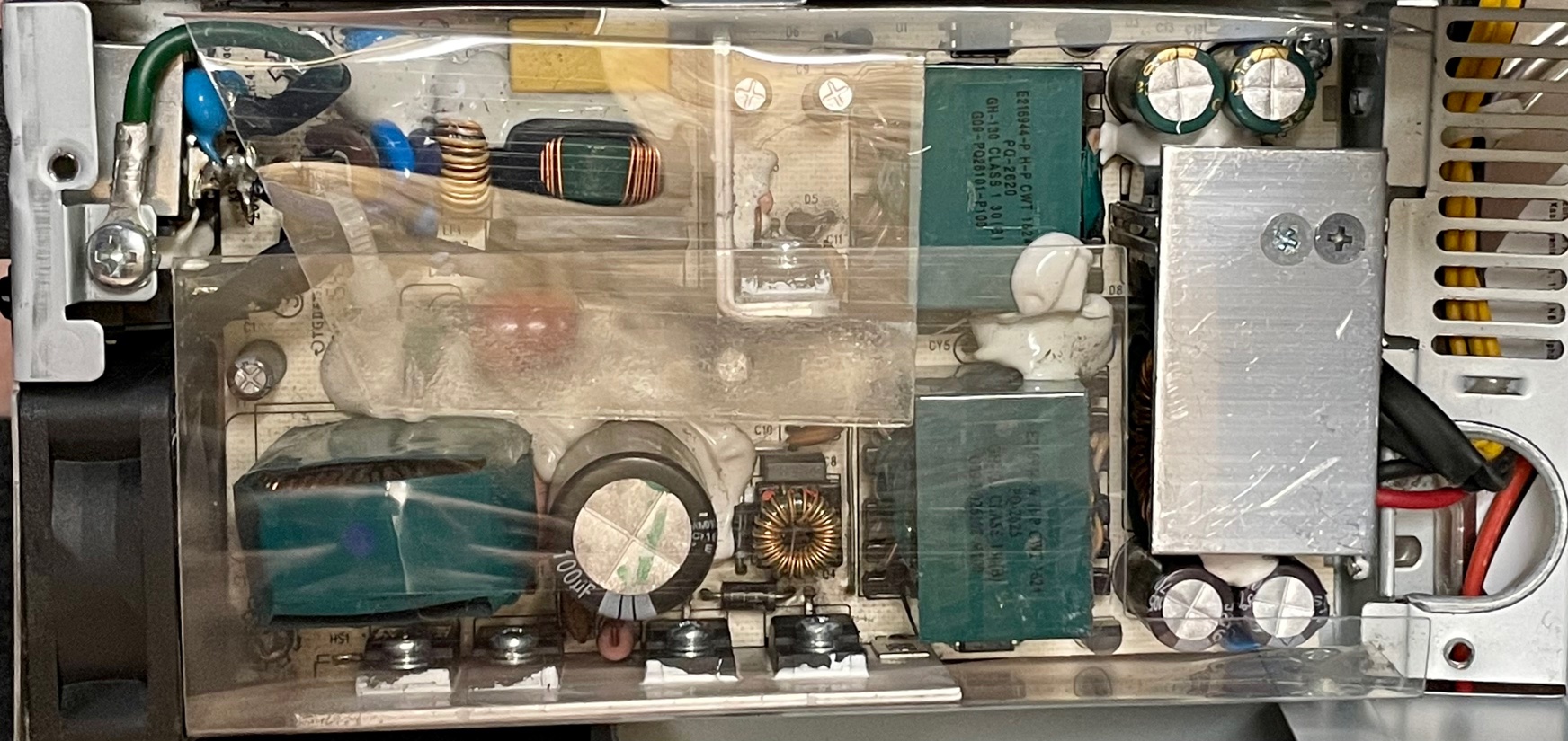

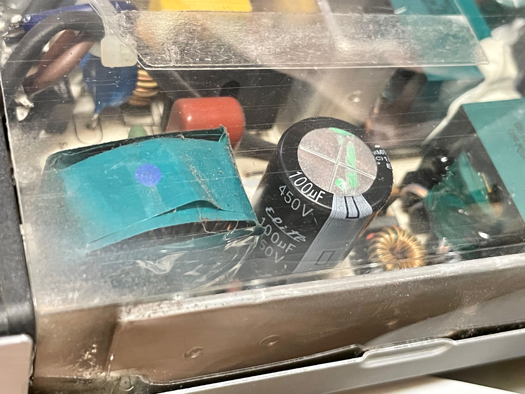

After almost 5 years of continuous operation (> 40000 hours!) I decided to open up the PSU today for a small visual inspection, so I checked how the internal capacitors are looking like. I thought I will need to swap few caps with new ones due to aging (bulging, swollen), but I was wrong: caps are in perfect condition. I will probably check them again next year, but I must say that this PSU exceeds my expectations.
It also seems to have a good design too: I can see an EMI/RFI filter inside, surge protection with MOVs, isolation transformers, CE and FCC certifications etc.
If you move the High Voltage AC PS outside of the chassis, then you only have the Low Voltage DC from the external PS inside the chassis, and then there is no need of earth from the AC mains power supply.
