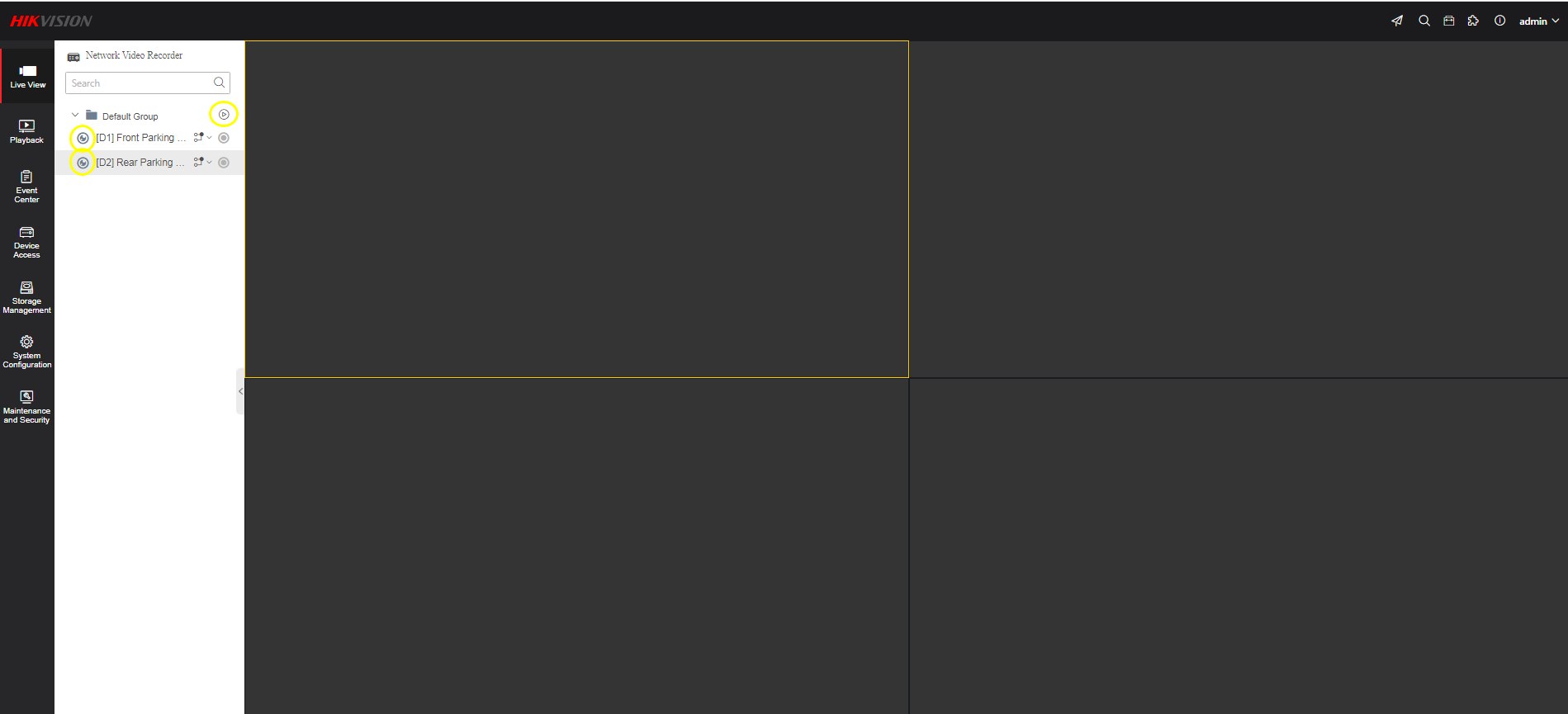

I too had initial problems getting Live View to work with my Chrome browser. Seems Live View does not start automatically. That said, (with firmware 5.02.005) I was able to get Live View operational.
In simple terms, just manipulate the Icons (circled in yellow, see pic) and Live View came on for me.
I'm not saying this is correct or a good design..... just what I did to get it Live View operational in my browser. HTH.

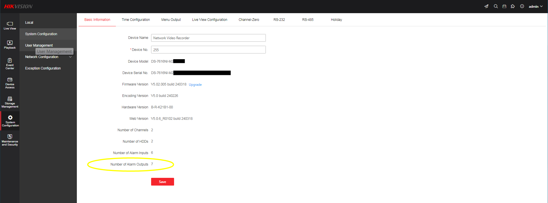

Is it just me ? or is the Number of Alarm Outputs incorrect ?
My NVR = 1 alarm output
Camera 1 = 1 alarm output
Camera 2 = 1 alarm output
By my count, that equals 3 alarm outputs, yet the HIK firmware suggests the count = 7.
Am I missing something ?
Well spotted. I have the NVR output plus three cameras that have an alarm output. I'd expect to see 'Number of Alarm Outputs 4' but my system also shows 7.

@sportster I think you'll find your number of alarm outputs has increased from 4 to 6 (mine has increased from 7 to 10). I'm interpreting (my wild guess) the number of alarm outputs to include:
  • NVR alarm outputs
  • Camera wired outputs
  • Camera speaker
  • Camera strobe
So 1 for the NVR itself and 3 for each camera that has the speaker and strobe light.
  • NVR alarm outputs
  • Camera speaker
  • Camera strobe
Just installed the 5.02.006 version. My alarm output count was at 7 before (with 5.02.005), and remains at 7 after (with 5.02.006). The extra counts may well be related to the camera's speaker & strobe, although in my case the alarm output counts didn't change. Color me puzzled on this one. Lol.
