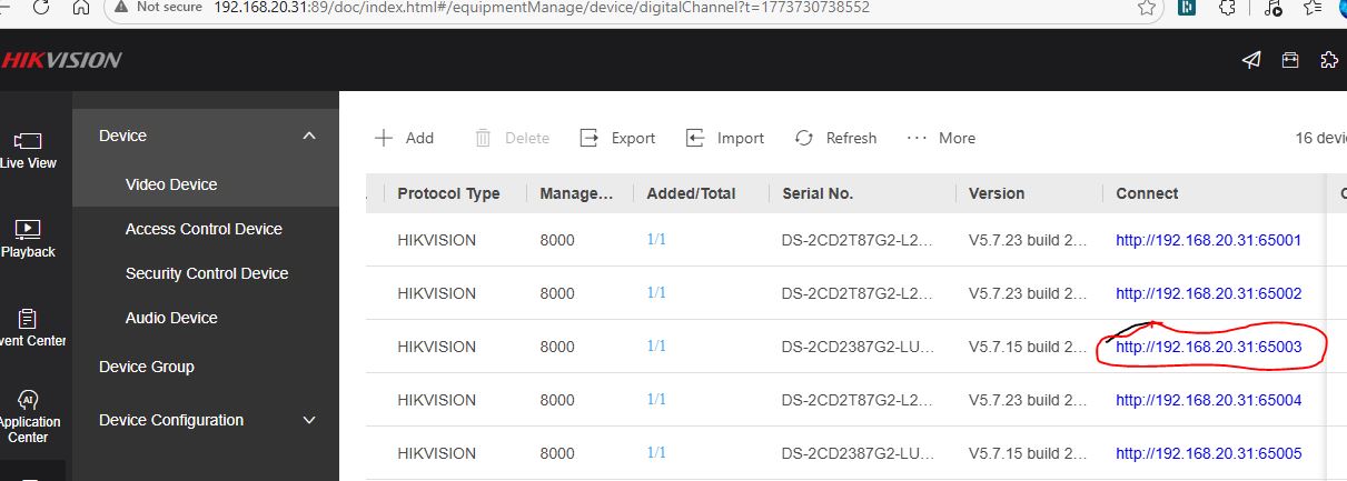

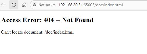

Hi Everyone,
I'm really hoping someone can help. I was updating my cameras to Firmware version V5.7.23 for which I have 7 cameras in total.
For 4 of the cameras, I accidently selected an old firmware version V5.7.15. The cameras updated with this version successfully, came back online and appear OK. But when I try to access the camera device from the NVR portal using camera web address in the PC browser (per link per in first image), I get a "Document Error: Not Found" error (per image in 2nd image) so I can't go into the camera GUI to update the firmware to the correct latest. The other 3 cameras which got the correct firmware are all fine and I can log into successfully.
Is there anything you can suggest - I just want to log back into these 4 cameras and install the correct latest firmware.

Hi Everyone,
Thanks,
John
Clear your browser history. It’s common after firmware updates that web ui elements fail to load/display correctly due to changes in the code.
Clear your browser history. It’s common after firmware updates that web ui elements fail to load/display incorrectly due to changes in the code.
That worked ! Thank you very much - all cameras now upgraded to latest and working fine. Thanks again.
