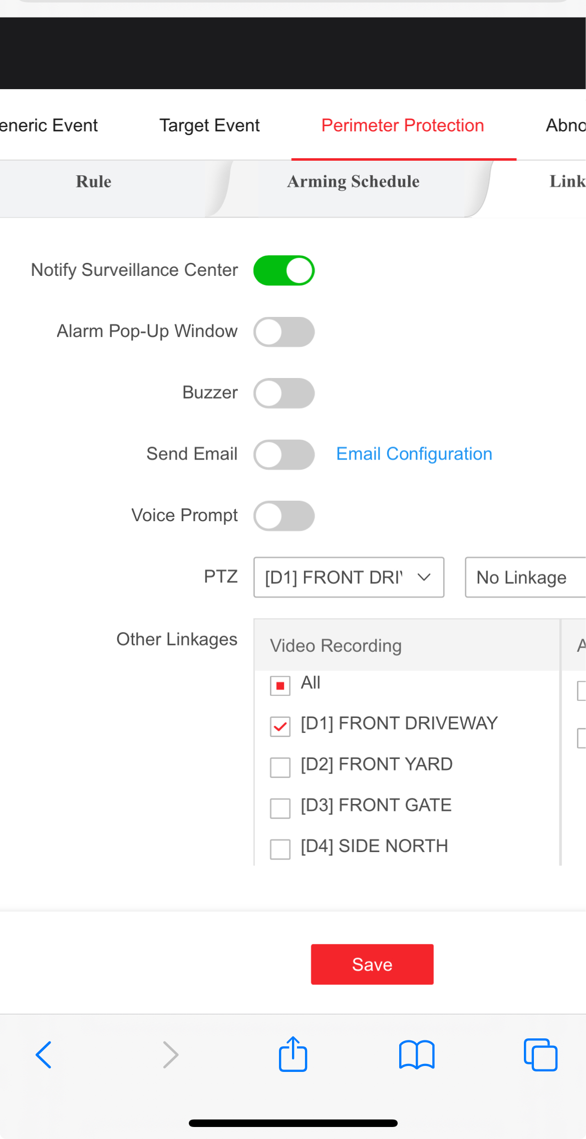

What are the settings for Linkage Method for both Motion and Smart Events? Is Notify Surveillance Center enabled?
Did you check your cameras GUI interface to see if all the event configuration setting set on your NVR are also "passed" to your cameras? Sometimes some settings are not.
Are Smart Events set to AI by Camera or AI by NVR?
Hi @alfaclvi - yes my linkage is set to “Notify Surveillance” per below screenshot. Given the markers appear perfectly in HikCcnnect app and issue only on web browser, then I’m thinking must be a firmware issue per @JB1970 post above.
Any other thoughts?

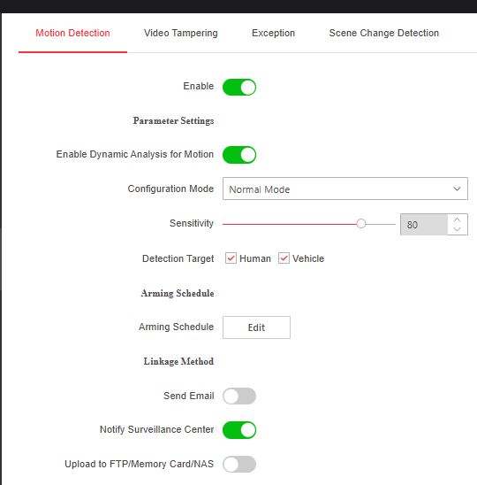

Yes I also checked Camera settings directly and they are set correctly as per below screenshot.
And yet still no markers on the web browser timeline, which is the same behaviour @JB1970 is seeing for his camera with the latest 5.7.19 firmware. This is regardless of whether I have a 1x1 display, or multiple displays, and where I have Play or Stop on the video...
The only difference with my settings is the "Upload to FTP/Memory Card/NAS" since I have added an SDcard in Camera slot.

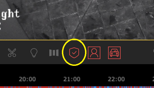

I've been reading the thread and noticed I have the exact same issue with both Edge and Chrome browsers on a PC. i.e, no event markers on Playback timeline, and yet on my iPhone I have them.
Settings are correct and the Human / Vehicle icons are there, however the icon with the tick isn't, (this icon isn't listed in the playback icon description section of the online help files) What is it for and is it needed?

No idea what that shield symbol is for - it’s on my PC browsers but not iPhone.
After upgrading the firmware to 5.04.050 the shield icon with the tick is now visible in the browser... apparently it is for privacy protection.
