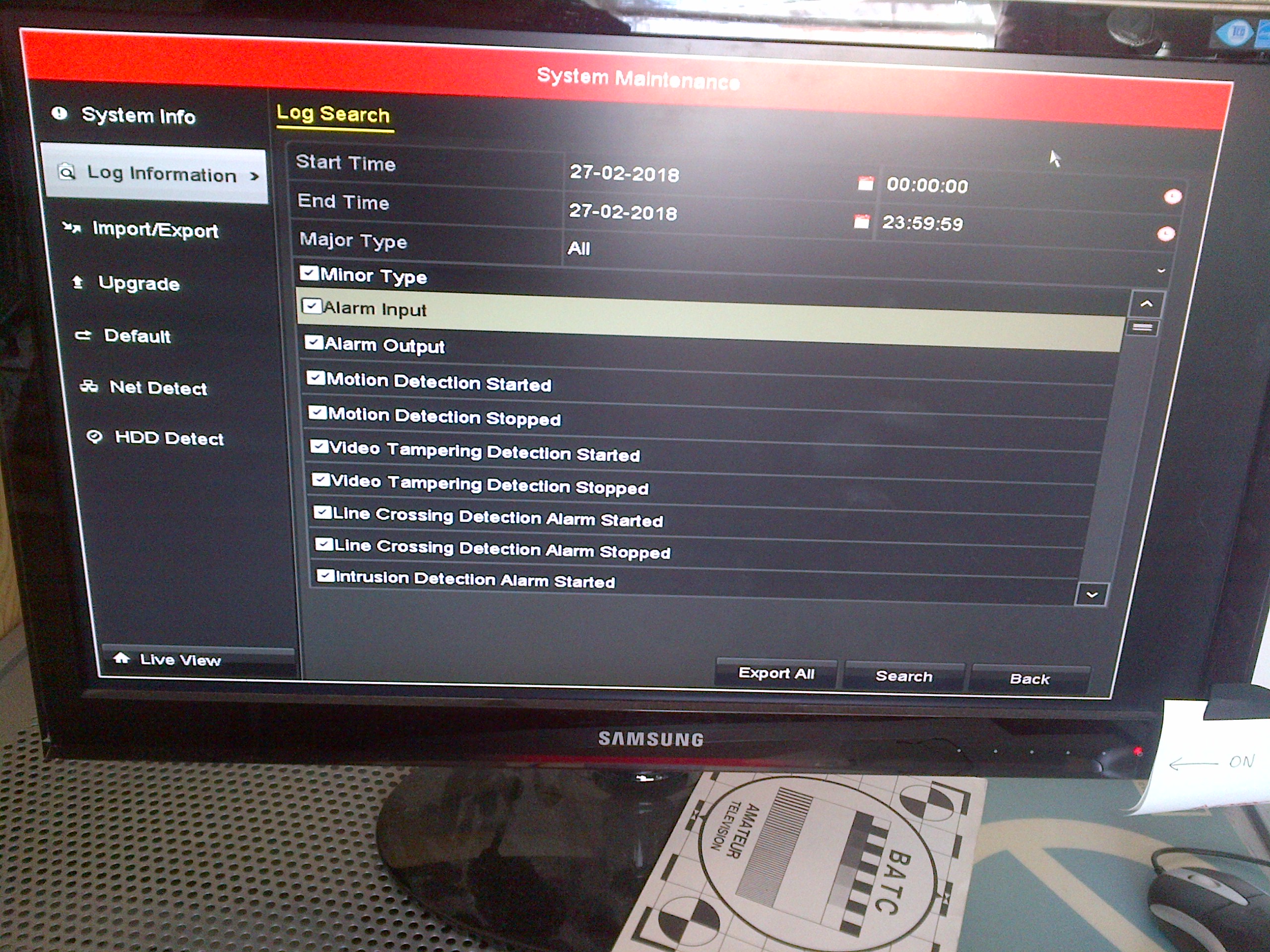

Ok Phil I am looking at the system maintenance page and clicked onto Log information page but I dont see any log view ?
You need to set a date & time period, then click Search

Ok Phil I have checked the log for 15 minutes on camera 7 and all the alarm readings are from the motion detector . I did try turning it off on camera 7 but still got the alarm sign coming up on the screen maybe I have to do a reboot with the system to take effect .

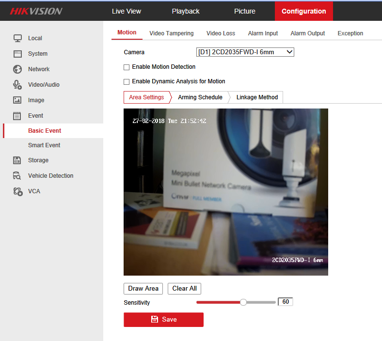

Have you disabled VMD on the camera AND the NVR for your camera 7?

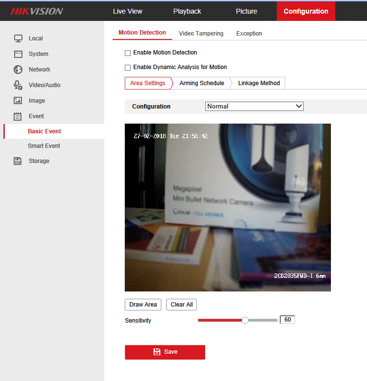

NVR Event config screenshot:
(for cam D1 selected in dropdown at top)
Very similar looking event page when logged directly into the camera:

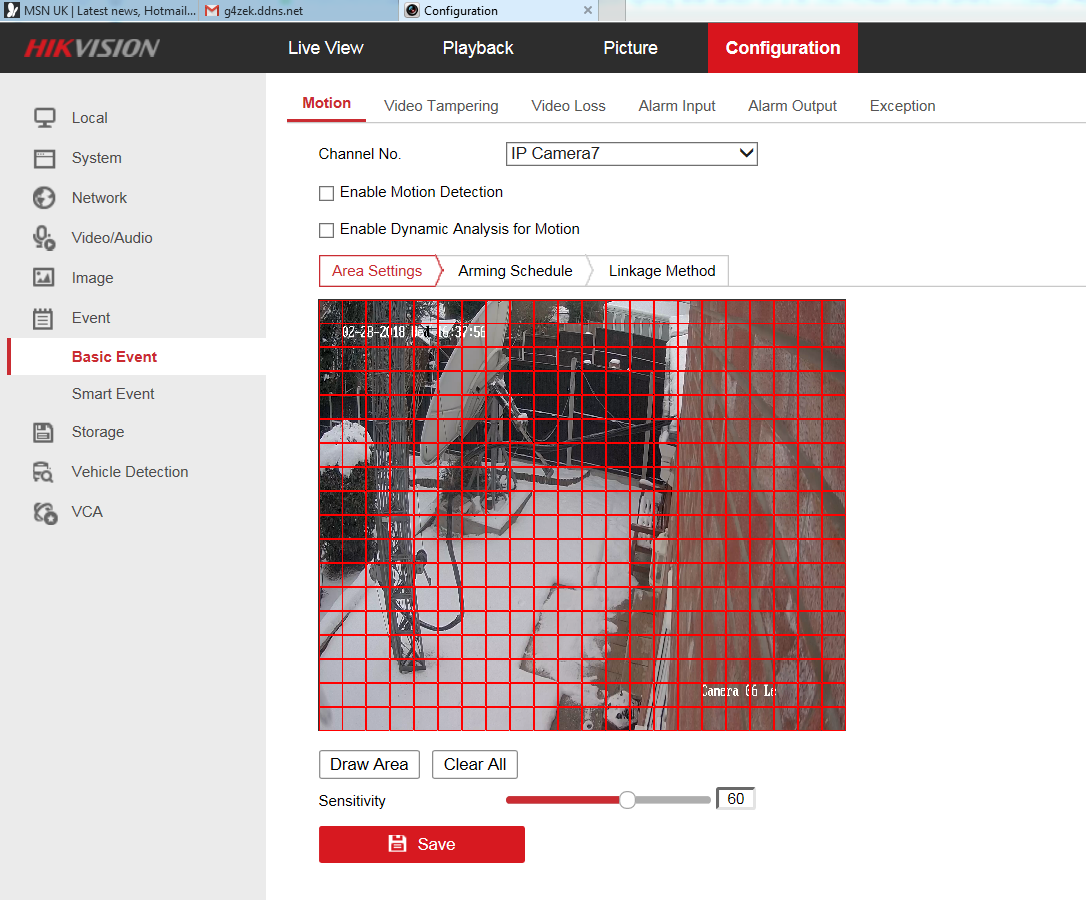

Good Afternoon Guys well I checked my motion detection and every thing is turned off as you can see from the screen shot .

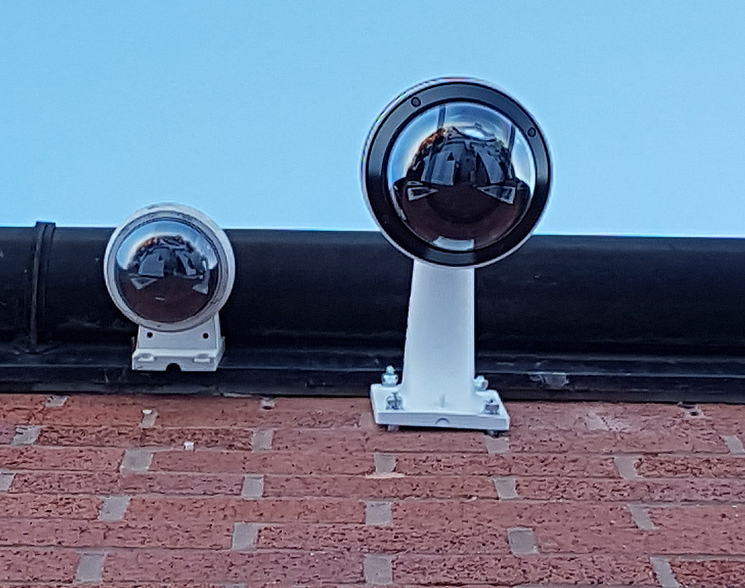

New and Old PTZ
I just used the power supply that comes with it, there is 240V power in the loft where the Cat6 cables run, so wasn't to hard
Only thing i would say if you get one, is buy better anchor bolts ;)

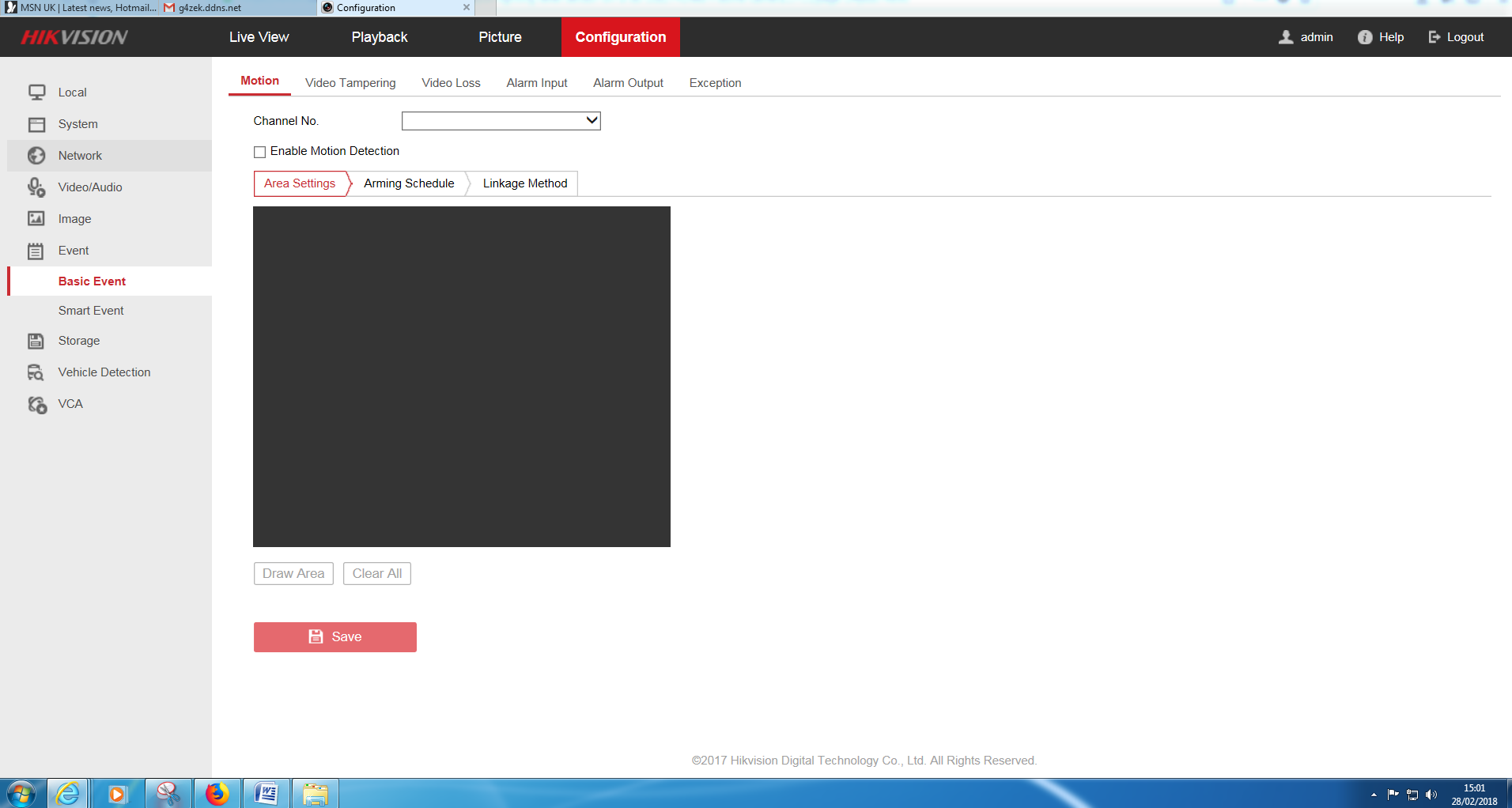

Hello Brian,
If you look at my Post #29 above, you'll see that I mention that VMD can be configured either in the camera or the NVR, and you'll need to check it's off in both.
Also, in the screenshot you have sent from your NVR - you need to select your camera in the box above the display to verify for your camera 7. You'll see in my example at Post #29 that I had my camera D1 selected.
Thanks Phil the camera was still on so turned it off now so far no flag , Ok on the Raw bolts yes I used larger ones on all of the cameras here but they are a bit light weight regarding the power supply so did you run a extra power cable to the PTZ or did you power the camera just via the RJ45 enernet connector ? I would think using a inline POE Injector I just dont want to run any more extra cables if I can help it .

I already have a 240v power supply in my loft Brian, so all i did was make an extension up then plug the supplied power adaptor that came with the PTZ in,and run the cable along side the Cat cable
Oh understood you spiced a power line into the cat cable my loft is not very high so it might be more straight forward just to add a POE Injector .
