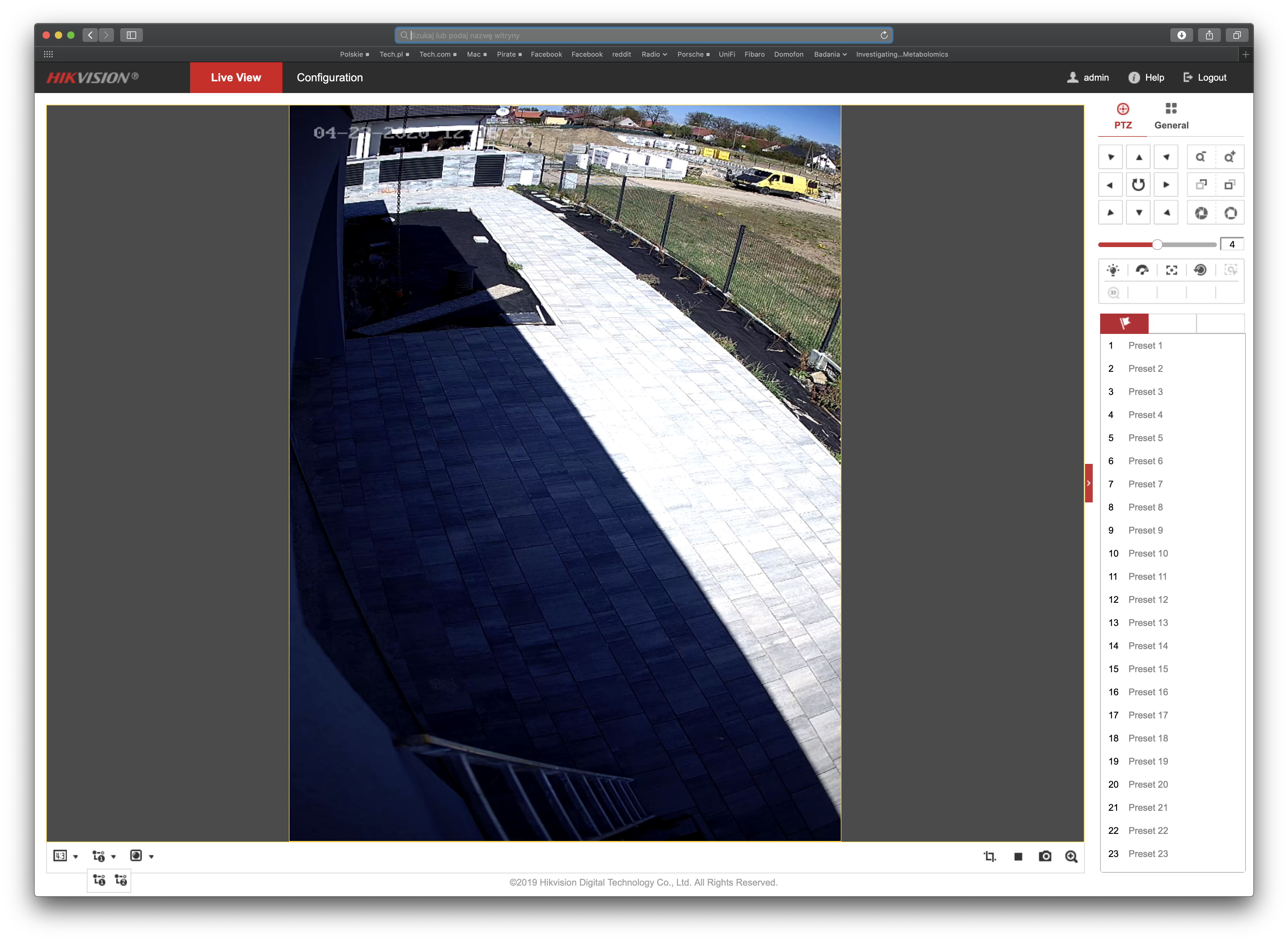

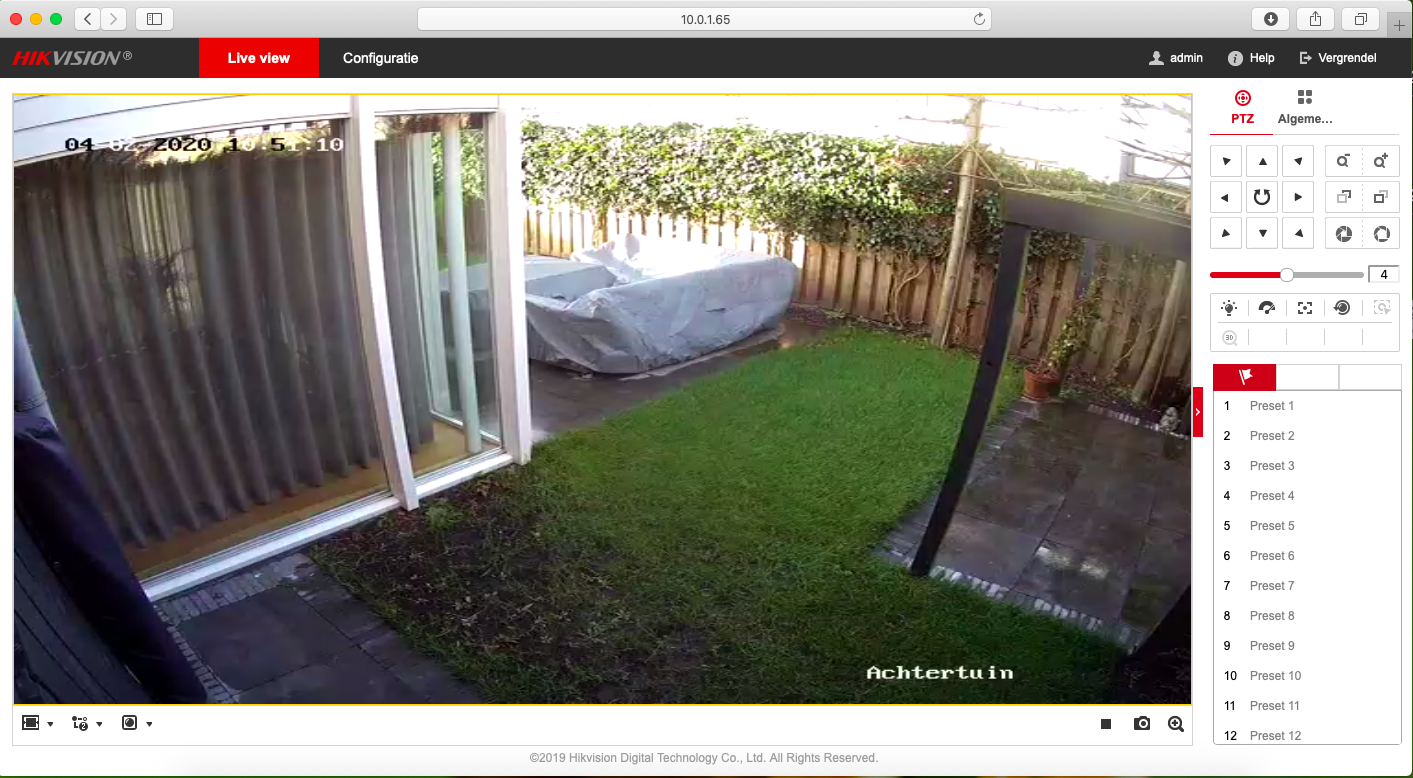

I have been fighting the same problem for ages, but somehow I got it to work...
Not sure what helped, but I now have a live view on all camera's using the web interface on my Macbook.
This is my setup:
I have three camera's, all are Hikvision DS-2CD2155FWD-I.
Just updated the camera's, all are now running the latest firmware released September 2019, which is ''V.5.6.3 build 190923''.
Running OS Catalina 10.15.3.
Running two browsers: Safari 13.0.5 and Opera 66.0.3515.44.
I can watch the live view on both browsers.

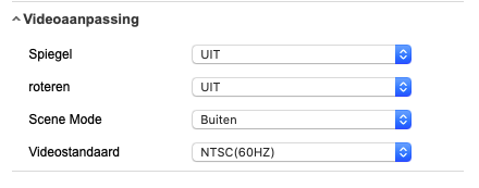

After I was sure everything was up to date, I only could watch a live view on 2 out of my 3 camera's. After playing around, I figured that the only camera which didn't work, had the ''rotate'' function turned on. So I turned it off, and now I am able to watch a live view on that camera as well (sideways...).
It is not a full quality live view, but good enough.
Finally I am able to change setting like ''line crossing'' etc., since the iVMS software doesn't allow me to draw lines.
I wish you could remember how you got Live View to work. I get a gray screen in Live View and in the config panels - in latest versions of Safari, Opera and Chrome.
Attached the screenshot of the working live view on Safari. One of the camera's only worked when I turned Rotate OFF in the settings.

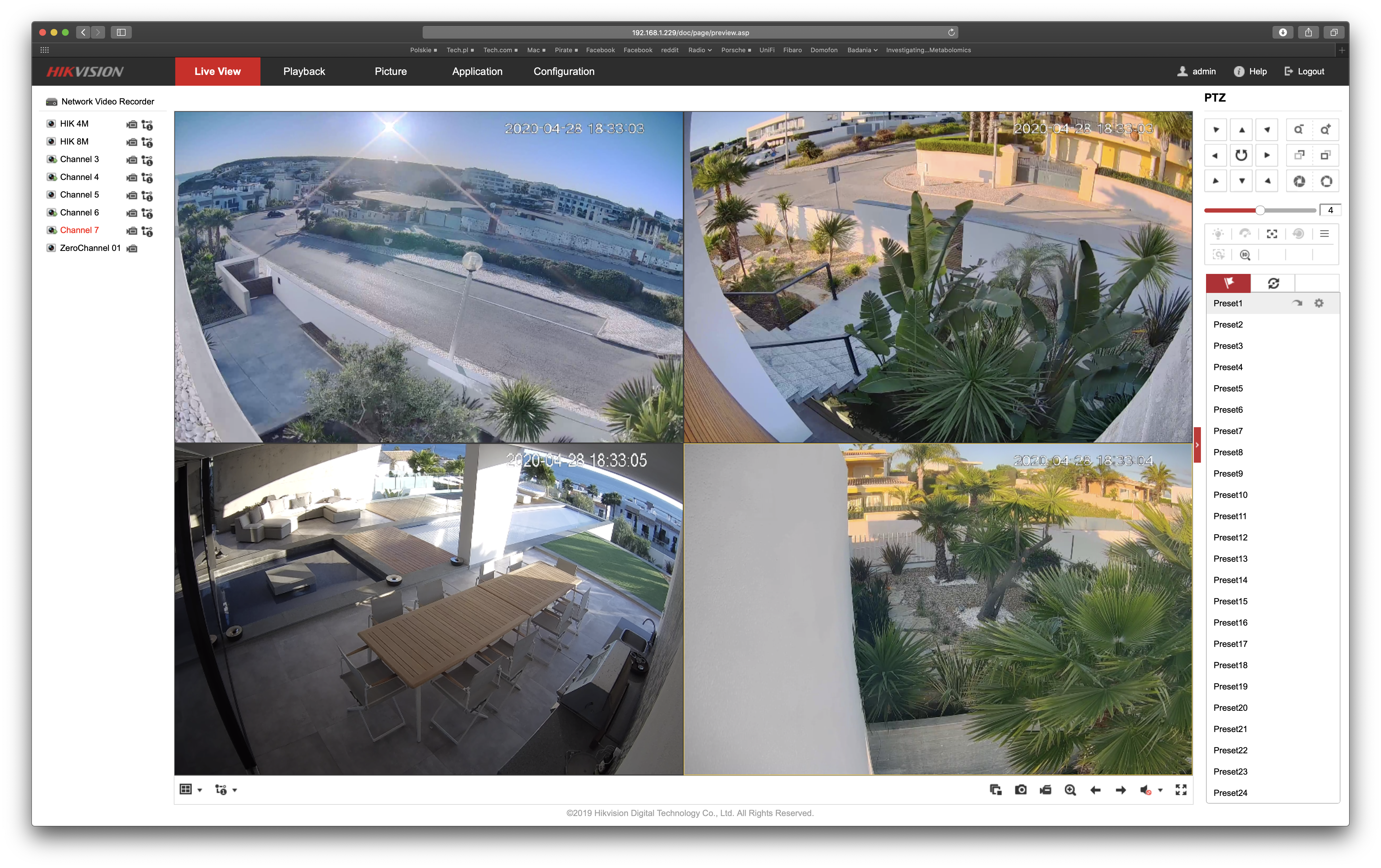

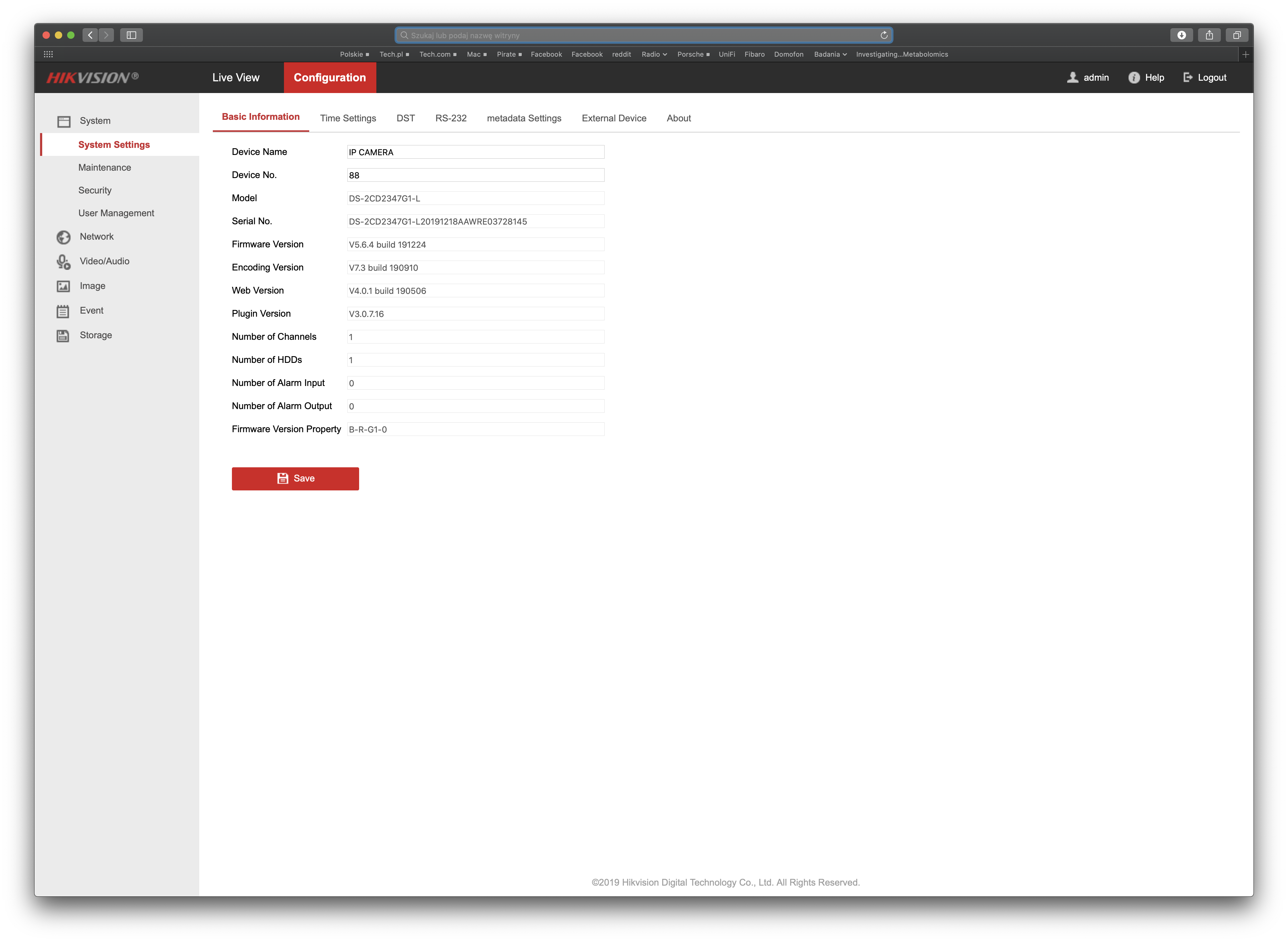

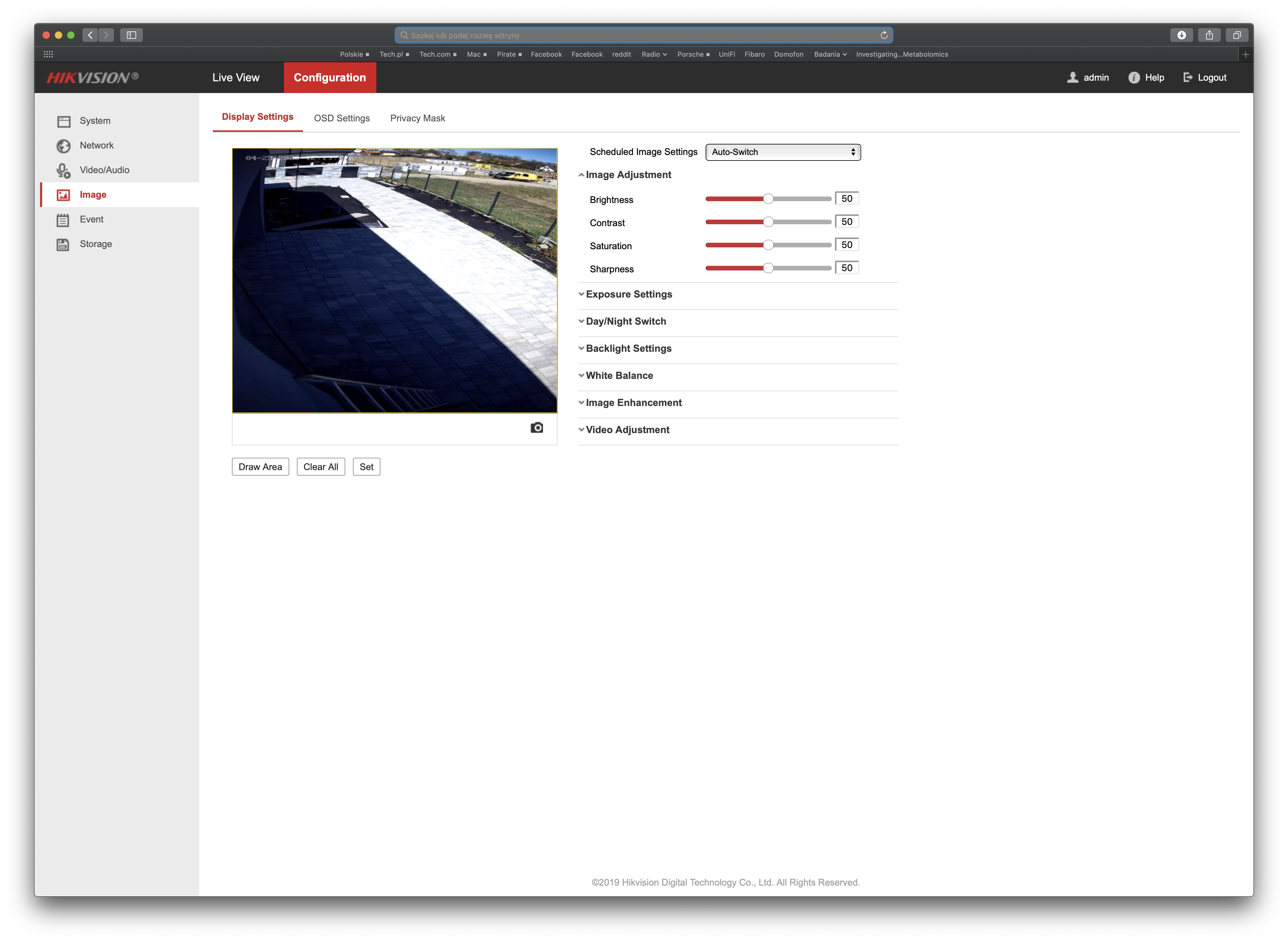

I have remote access to new G1 cam (from ColorVu line) and this cam also works under Safari for me. I attach pics from live view + system info + display settings. So HIK have working live view in latest Safari - there can be older fw's for some cam models which have older Java Script and simply don't validate Safari as valid browser with working WebSockets.

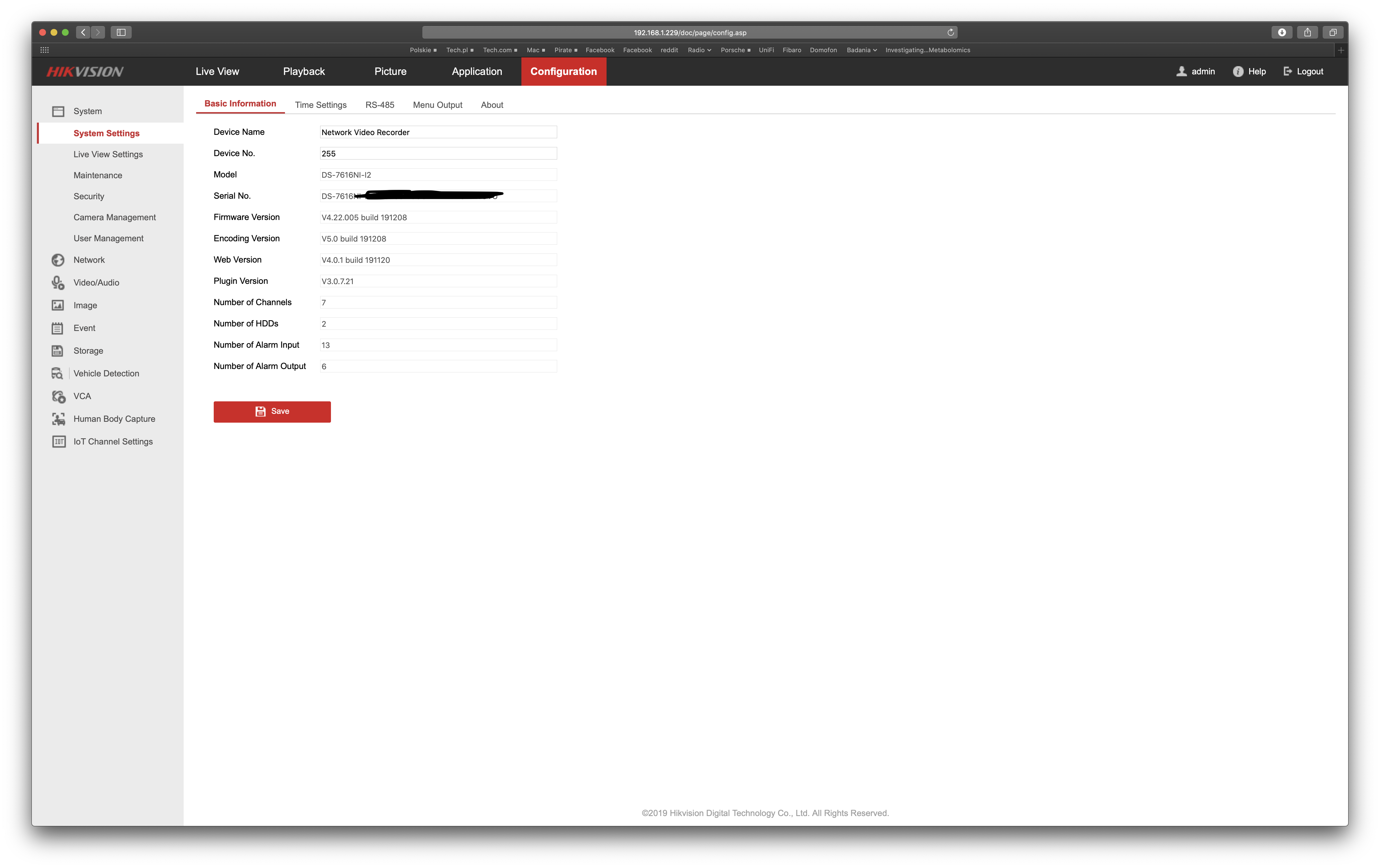

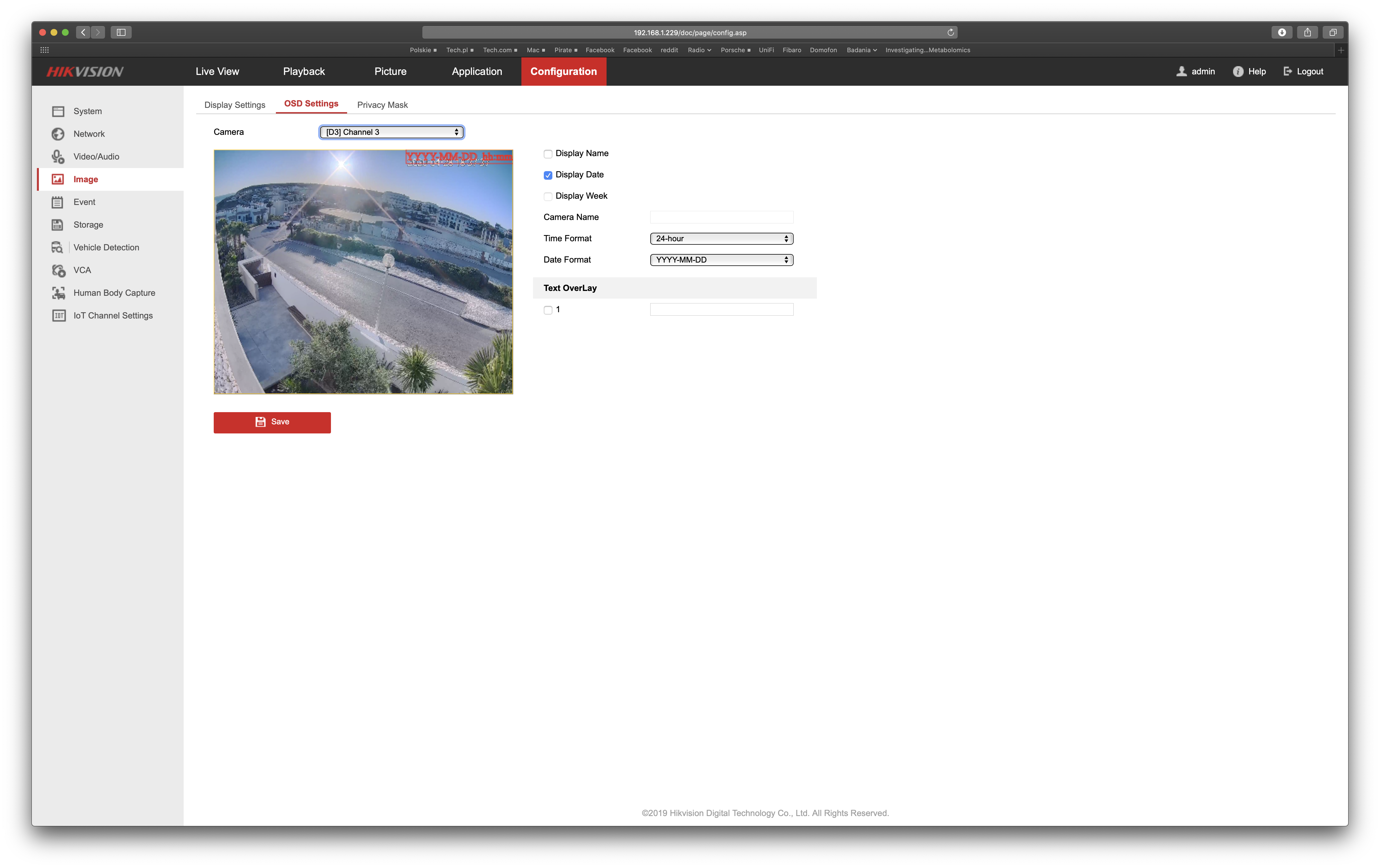

After replacing AcuSense NVR to normal I-series version (DS-7616NI-I2) on latest firmware (4.22.005) I can confirm that it works very well in Safari on MacOsX Catalina (10.15.4).
Live View without plugins works on all screens... There is no need to change User-Agent..
This solutions works with old/new HikVision and also Dahua cams connected to that NVR...
PS. This also works from Internet - but require two open/mapped ports (80 & 7681)
