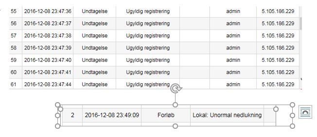

I as well linked the reboot issues to my access from iWMS-4500. However, just look deeper into the log details, and realized today, that when my NVR makes an abnormal shutdown, this is often after several attempt with unsuccessful login??
Could someone check whether actually same issue with you, that some is actually trying to access your NVR with wrong password and locked out?
Seems I have someone from Ukraine (based the ip address) that try to hack my NVR ;-(
So just changed the URL for my DDNS record ;-)
(screendump is from the log where the "ugyldig registrering"="unsuccessful login".
and second is the "unormal nedlukning"="abnormal shutdown"). Having this on various days from the same ip address and then my NVR makes a 3 minutes shutdown

Hello Soren,
very interesting...where can i find the log details in my NVR?
I don't think it is a "hacking problem" here because i use the internal Fritzbox DNS service, so the URL is not visible. Another point is that the NVR would block any attempt after 6 unsuccessful logins...
Ok, i find the log details...very interesting. I will have a further look on it...but what i see, is a bunch of "abnormal shutdowns" :-(
Thanls Soren!
I take a closer look today into the log: i see no invalid logins, but a lot of "unnormal shutdowns" (3 times within 30min last night, after tthat the NVR works for 12 hours with no problems).
Sometimes, the (legal) login by myself from outside causes a reboot too, but randomly.

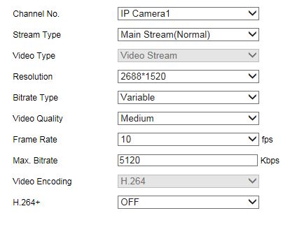

The nvr was reset (all the parameters, except the IP parameters and user information, to the default settings) via the webinterface (always use the webinterface for accessing the nvr and cam configurations) and use the windows client iWMS 4200 for playback as easier to make time searches etc. Viewing life stream I do on the iPad/iPhone app iWMS4500 or windows client iWMS4200.
I have five DS2CD2142FWDI 4MP WDR Dome cams connected. All running with video settings as in enclosed pic (standard/default config however I have manually adjusted the frame rate. I only use frame rate of 10 fps to allow for longer storage but still providing a good stream/video look when playing the recorded videos.) I have previously used the H.264+ encoding as ON, but Kieran once told me in another thread, that H.264+ uses more processing power. So I have tuned it off as have around 3-4 weeks storage for each cam (three of them only record for 16 hrs day).

i use H.264 too, not H.264+. But with full frame rate, higher bitrates (8192 kBit/s) and i have six cameras connected (4x4MP, 2x3MP with full resolution). I have two 4Tb WD Purple installed.
Maybe the cpu load is more critical in my installation...
