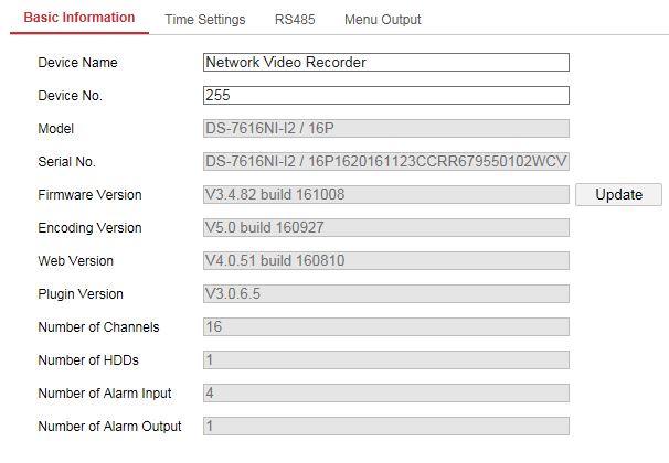

So I purchased an unbranded Hikvison NVR DS-7616NI-I2/16P everytime I upgrade it says
The type of upgrade file mismatches
Is this not the same firmware? Only thing different is the Hikvision logo is blank, and doesn't have English on it. its has a CCRR serial number?
Seems to be not an official EU Hikvision model...otherwise the firmware update fails. Only your supplier is able to help you if you have e.g. a chinese model. There are a lot of buyers thinking to save a bit money with firmware hacked models from another market and then it is a big surprise that these models doesn't accept any new firmware :-)
