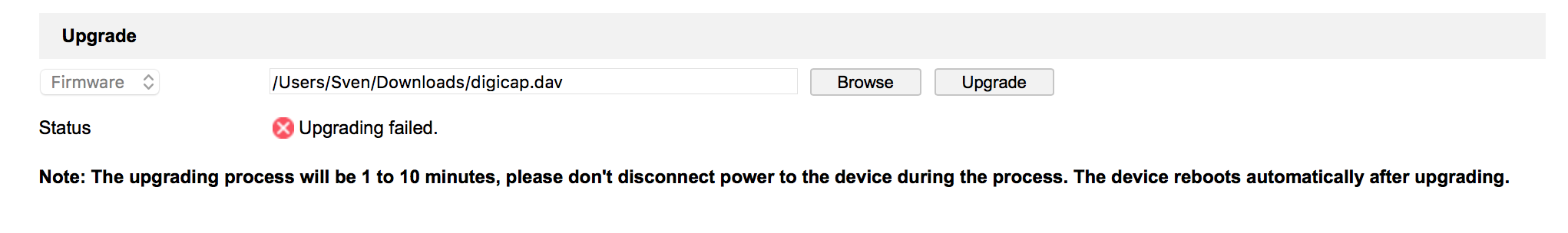

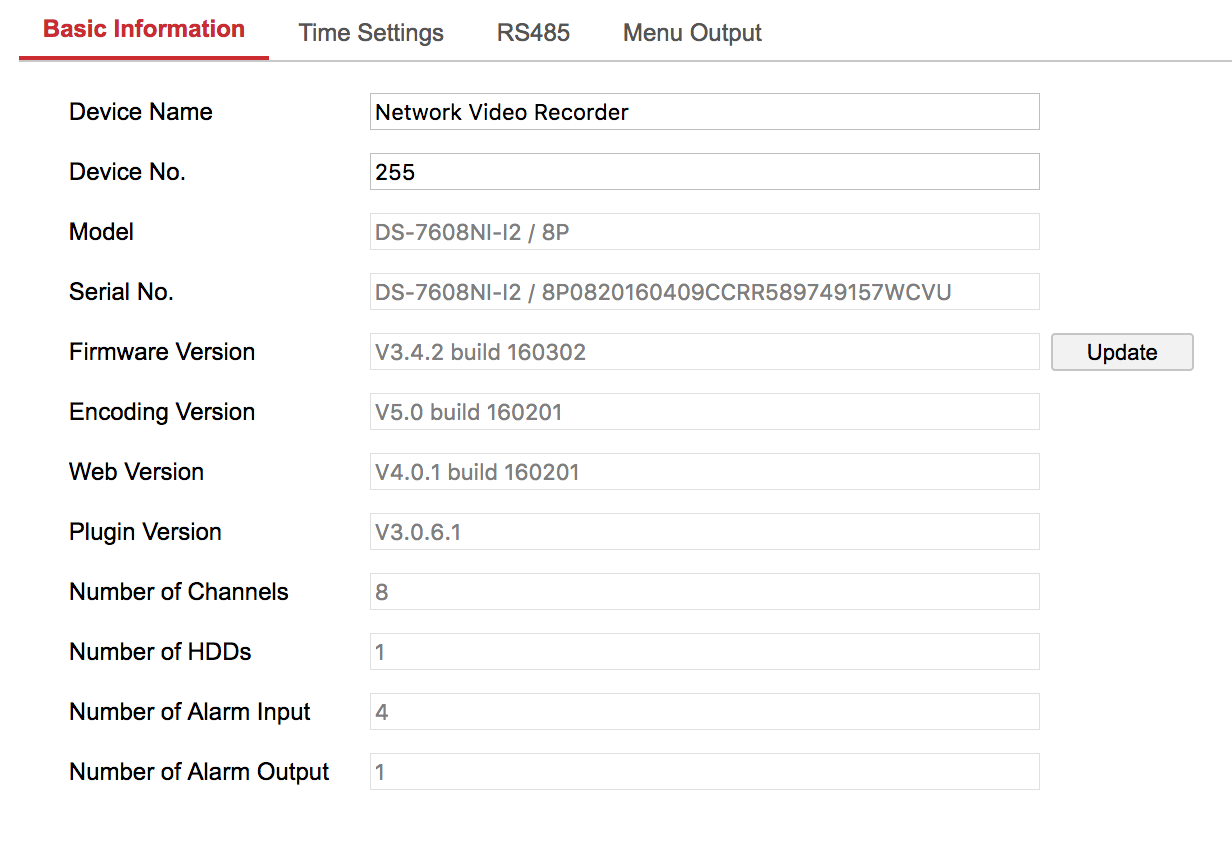

I'm trying to update my NVR, but ending with an "Upgrading failed." message.
What kind of system dependencies are known?
I tried with Safari on Mac OSX and Internet Explorer under Windows 7.
This is the version I tried to install:
DOWNLOAD PORTAL
V3.4.2 build 160302 -> V3.4.6 build 160405
What's wrong?
Thanks in advance,
Sven

That's the wrong firmware page at the HikVision portal for your NVR.
You need this page for your -I, newest at the bottom (V3.4.96):
DOWNLOAD PORTAL

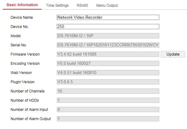

Just tried updating my NVR with NVR_K51_BL_ML_STD_V3.4.96_170921, but it's now locked me out.
It booted & asked me for a NEW password & an unlock pattern, which I set, but it now says they are wrong & I can't get back into it.
Can't see it with the SAPD tool either, even though I can bring up menus with the mouse on the main screen.
Anyone Help Please?
Phil.
Edit,
Full details in above post, that I didn't seem to get to quote properly.
Model# DS-7616NI-I2 / 16P
Serial# DS-7616NI-I2 / 16P1620161123CCRR679550102WCVU
Firmware V3.4.82 build 161008
I did export the device parameters before the upgrade, but when I try importing them from a USB I get a GUID file mismatch message.
Entering the password I had set is of no help as I can't enter a username.
