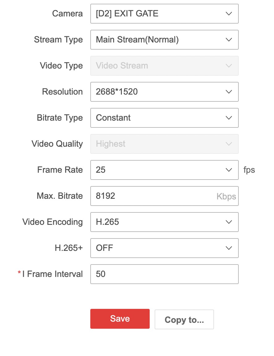

Do you know what the I Frame Interval setting should be?
( this is a new setting that was not visible under V4.51 )
I read ( obviously missing the core concept here to figure it out myself ), some of the arguments say half the frame rate, others say equal to the frame rate and I raid some say double the frame rate.
It all sounds like grasping at straws to me, as there is no way all three of those answers can be correct at the same time?
There's no real rule for this - it's normally fine just left as 50 in normal residential scenes, many like to set it to match the frame rate, but it's not really necessary to set it any lower than that.
Setting this value to be lower will increase video quality, but will increase the bitrate used by the camera.

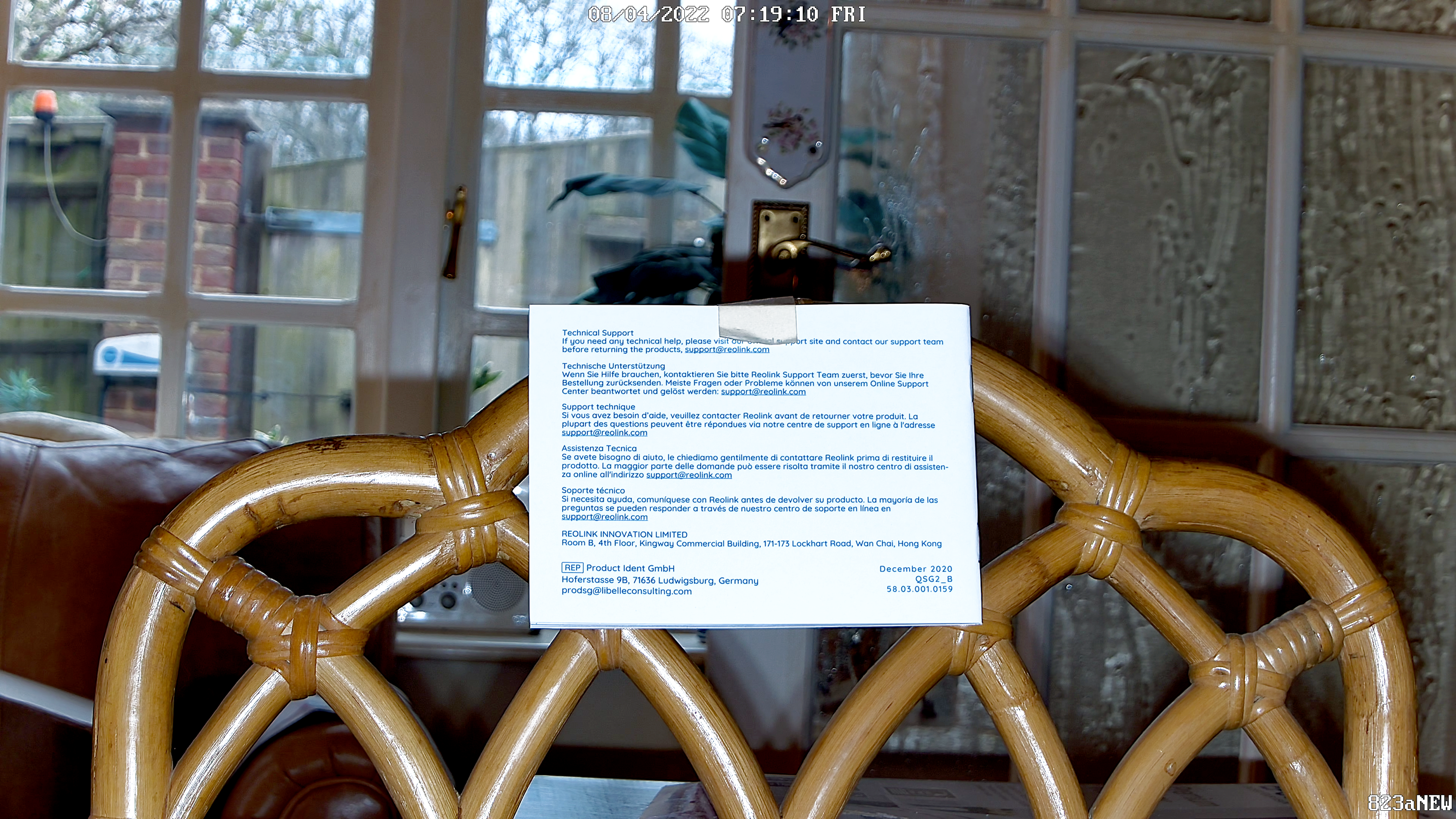

I can't knock Reolink for camera build quality or software and they use decent Sony sensors; but their firmware often lets them down. And they launch new cameras faster than they fix the old ones. Some of their cams have rubbish night vision while some of their wireless cams can have flaky connections. But the daylight image quality is pretty good, eg: [Image failed to upload]

This, from the 4K Reolink 823A, is superior to my Hikvision 4K cams which are two years older. (Download to eliminate host artifacts)

Thank you Phil. Testing with the still image from my Reolink RLC-823A which previously failed to upload…and bingo!
