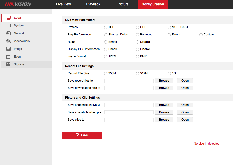

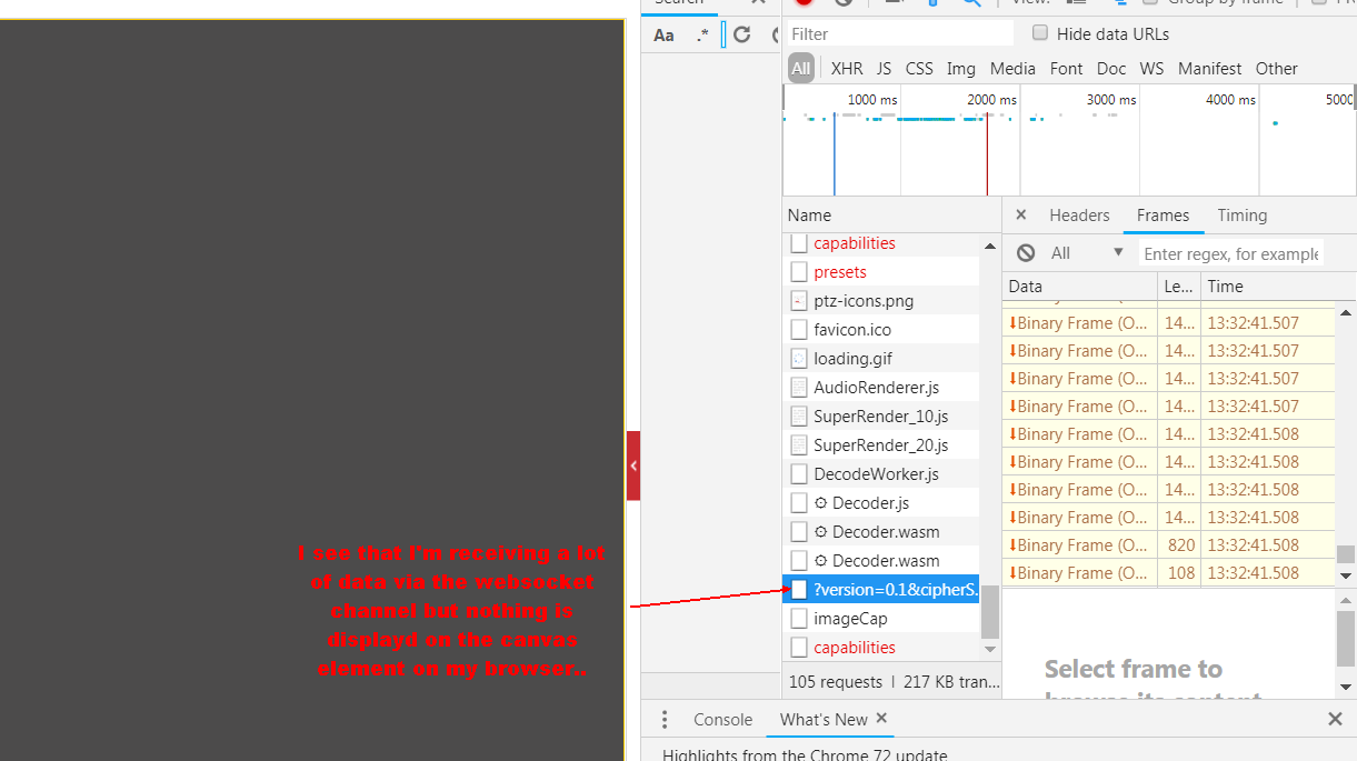

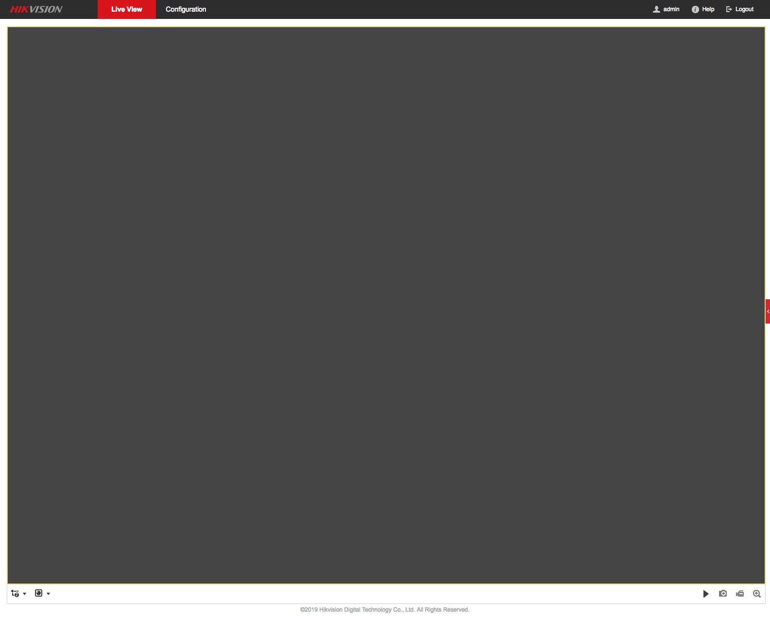

Hi,
don't know if anyone here has any thoughts on my issue (I've tried fw versions 5.5.80 and 5.5.82). My issue is that I'm not able to get any video input to my browser if webcomponent is selected (see the attatchment). If I switch to MJPEG then I can see the httppreview on the browser (canvas) but I don't want to use this. I've also been having some email conversations with Hikvision EU support about their websocket implementation and how to utilize it but every response what I receive from them is just trying to shuv me towards using a plug-in based solution (in my case that's not an option due to I have to display the camera feed on a QtWebEngine-component which doesn't allow any plug-ins to be installed on it..).
If anyone has any thoughts on this matter or has any inputs on the settings that I should have activated on my IPC then I would be more than happy to see those.

Until they introduce/release new firmware that has generally become known as the 'no plugin' solution I think you are going to struggle to get it working without using Internet Explorer, or the Chrome browser with the IEtabs extension added.
Maybe you could use one of the streaming url options?

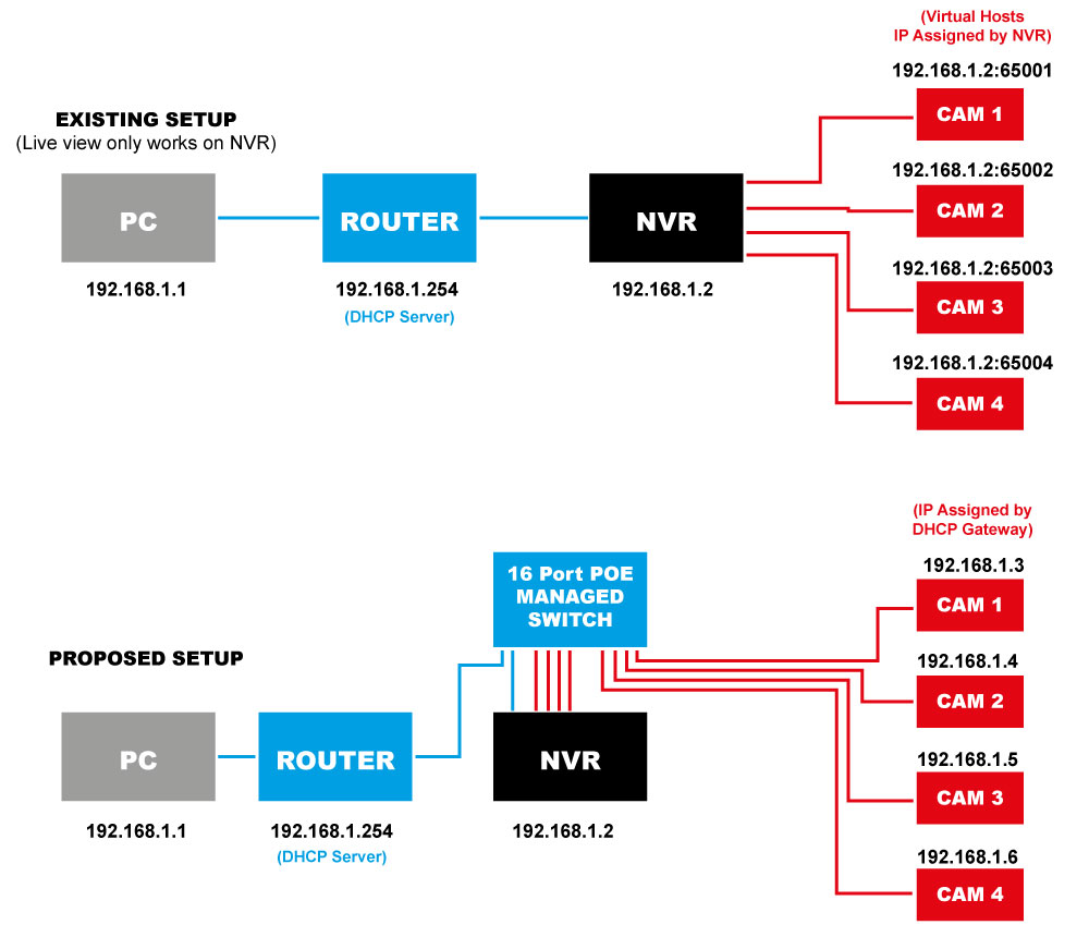

I upgraded to the 5.5.82 firmware on my DS-2CD2385FWD-I/G and DS-2CD2T55FWD-I5 and DS-2CD2T36G0-I5 which is connected directly to the DS7604NI-K1 / 4P(B) (FW: V3.4.100 180310)
I can report that since the firmware update on the cameras, all live view stopped functioning when logged directly into the camera using the NVR POE ports (access camera via virtual host). I can see the live view image when logged into the NVR but since the FW update the cameras live view image no longer works. When logged into the camera. ...which makes the intrusion detection, line crossing rendered useless as you can no longer edit them as live view won’t work on the camera. You can edit them in the nvr, but it only shows a few minor settings. Factory reset didn’t fix anything. So I’m stuck!
Since the FW update, when logged into any of the cameras, the ‘local’ settings disappear (Missing from the left hand menu). Upon inspection of the web browser developer tools console, it appears that your local menu item has been defined to be ‘hidden’ (html/css style.... “display:none”). Occasionally when it does reappear, all live view parameters and storage settings are blank. When I set them, it refuses to save.
I find this very frustrating as I was always told that hikvision was an extremely good camera system, however since purchasing the cameras and NVR I found them to be quite problematic and the software to be glitchy. Since the NVR was purchased only a few months ago I find it odd that the firmware is only on V3.4.xxx when the identical I series are on V4.xxx. Yet I read that someone had installed 4.1.6 on their DS7608NI-K1 / 8P!!!

I suspect the best way to fix this is to buy a £150 16 port netgear POE switch and plug the cameras directly into there, then give it a static IP and hopefully I can see the camera live view. At the moment the camera is plugged directly into the back of the NVR and the NVR is assigning it within the virtual host subnetwork. By implementing the 16 port switch and letting the TP Link router to assign each camera an IP address, then I can connect to the camera directly without going through the NVR. ...it seems like a waste of money setting it up like this, but this looks like my only option.

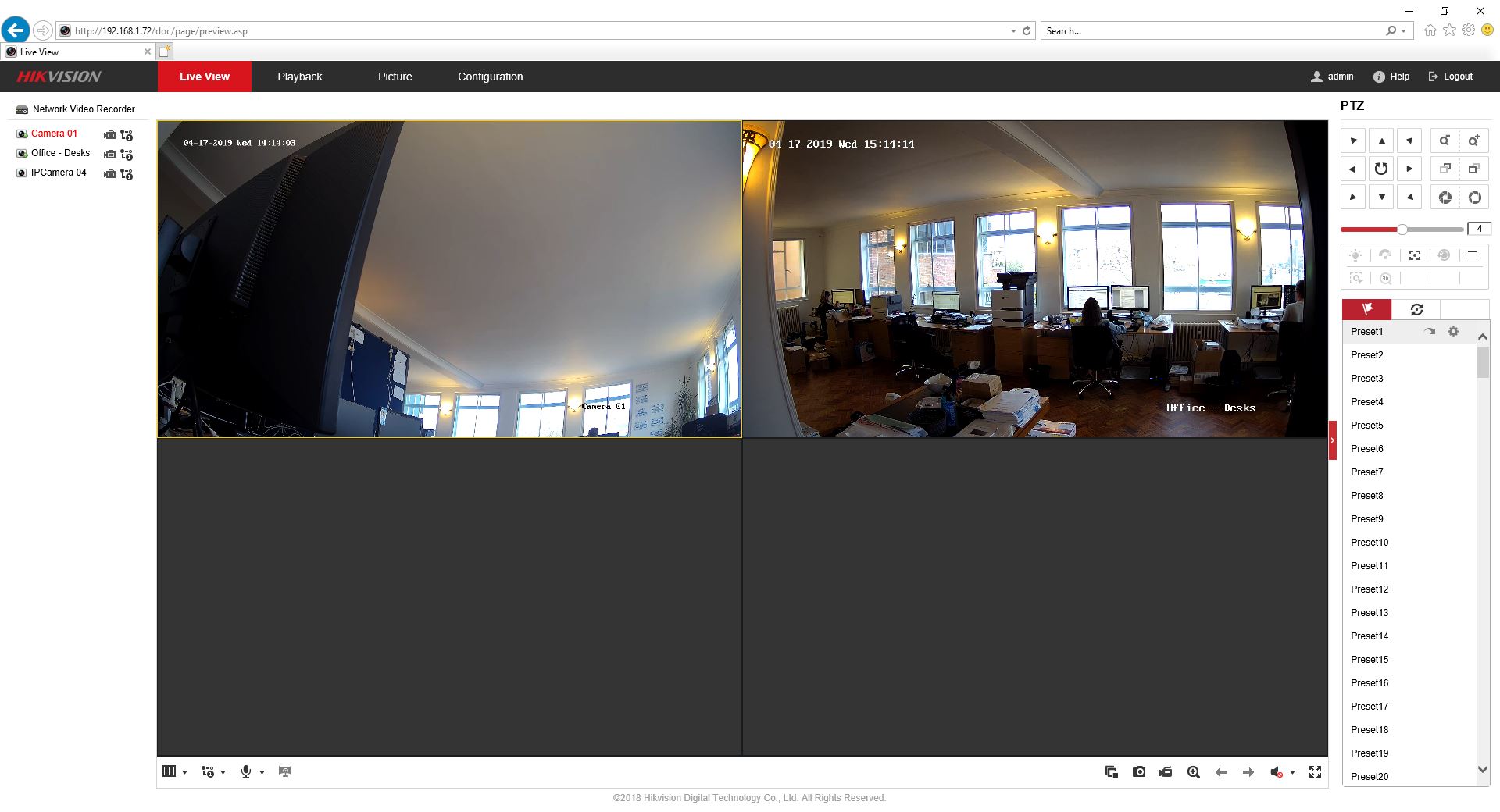

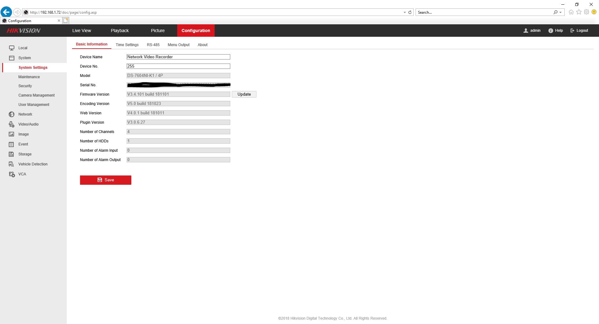

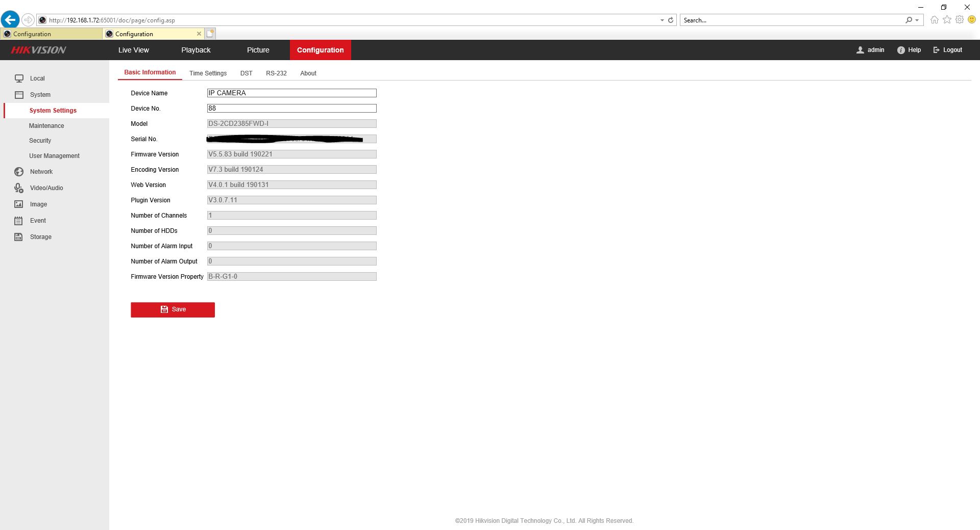

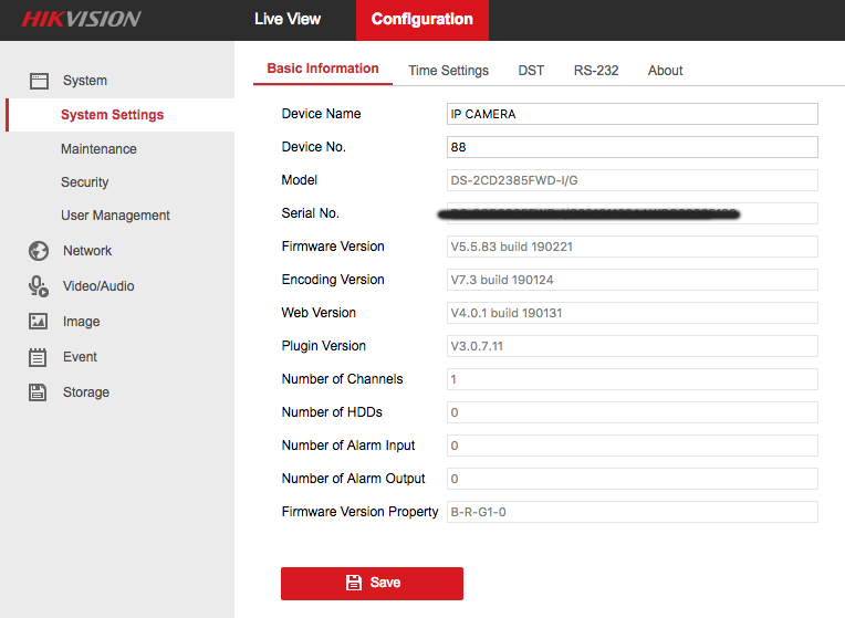

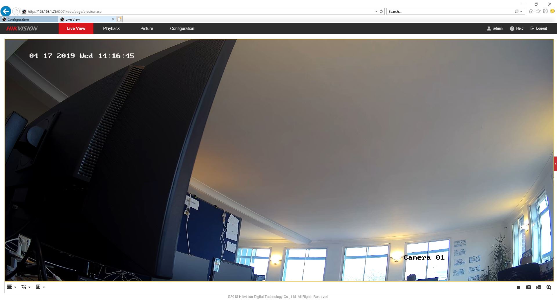

Everything you are seeing is very odd, as you will see from the attached screenshots our 7604-K1/4P is on the .101 firmware [we have also tested a (B) model with .100 firmware] and when accessing with Internet Explorer we could see live view, playback, and all the other menus. Then when I access one camera (2385) with the virtual host I also get live view, playback and again all the other menus, and that camera is also on the 5.5.83 firmware.
As already mentioned above we have tested a non-(B) NVR and that works fine, we have also got a brand new (B) model out of stock and that works fine also. I highly doubt it is anything to do with firmware as the 5.5.82 firmware has been out for months and we have had no other reports like this and if the firmware was going to cause any problems it would be with the older non-(B) model as they are now pretty much EOL.
This makes me think that it has to be something to do with your setup:
- Are you a Mac or PC user, or do you have access to both?
- Are you on the latest version of Internet Explorer 11? (v11.706.17134)
- Have you tried clearing your browser cache data?

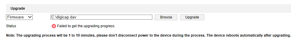

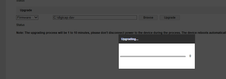

Hi, I am unable to upgrade the firmware on my Hikvision DS-2CD2385FWD-I.
It is currently running;
Firmware version: V5.4.5 build 170124
Encoding version: V7.3 build 170123
Web Version: V4.0.1 build 170123
Plugin Version: V3.0.6.14
I downloaded the latest firmware; _/IPC_G1_EN_STD_5.5.82_181211\digicap.dav but the update fails with ;
Status Failed to get the upgrading progress.
Any ideas ? ( I am using chrome with IE tab)
Thanks
Chris

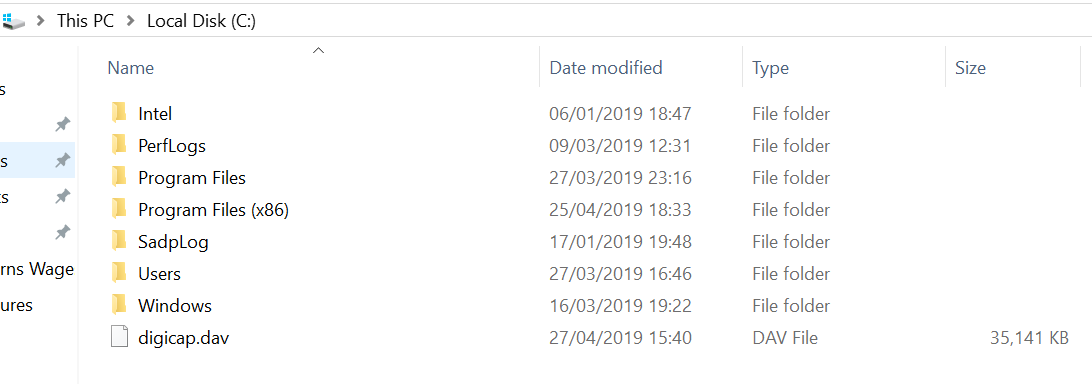

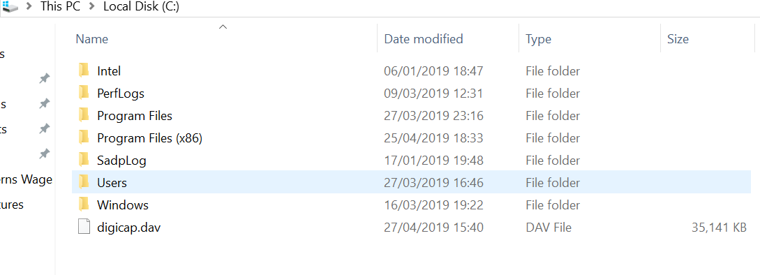

when you downloaded and unzipped did you put the digicap.dav file on your root of the c drive
dunno why when I attach digicap pic it doesnt show file name
but that will be your issue
Managed to get this working by first selecting "Reset all the parameters, except the IP parameters and user information, to the default settings " in the system -> maintenance section.
