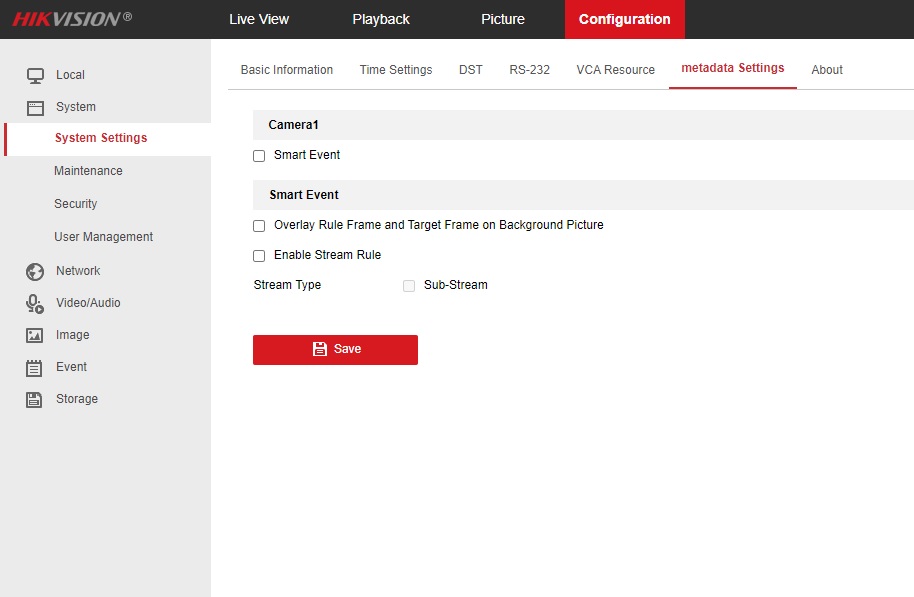

Can somebody with 5.7.12 firmware show me a screenshot of metadata settings tab in configuration? I want to know if “Overlay Rule Frame and Target Frame on Background Picture” has been added.
Here you go. Firmware v5.7.12.

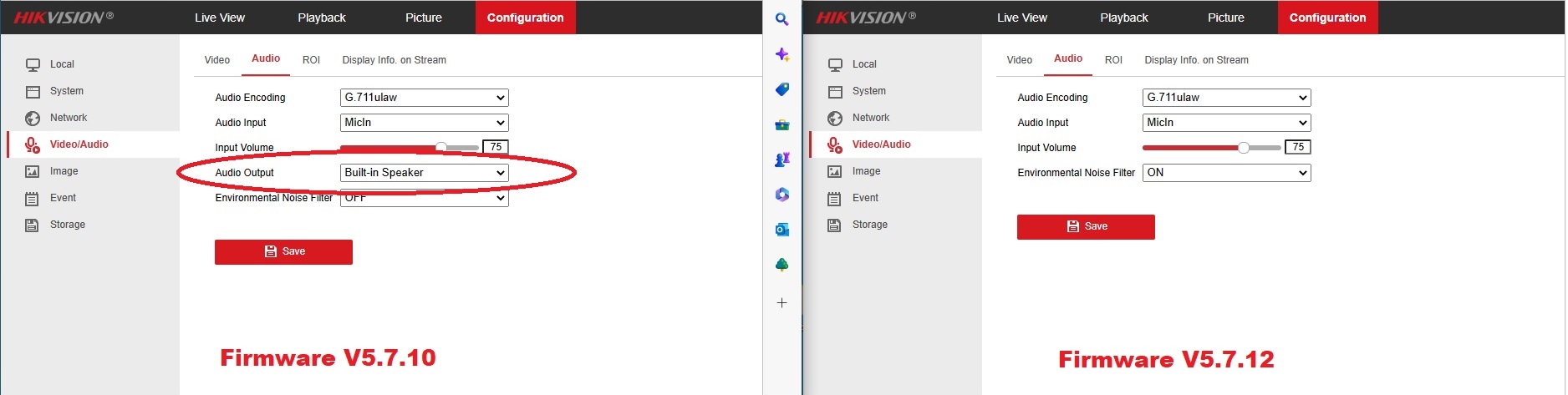

Another potential bug in the V5.7.12 G5 Firmware.
The screenshot below shows the configuration pages for two identical 2CD2387G2-LSU/LU cameras.
The image on the left is from a camera running V5.7.10 firmware whilst the image on the right is an identical camera running V5.7.12 firmware
Note the camera on the left has the option to select the audio output path. The options available are Built-in Speaker and Line Output.
After the upgrade to V5.7.12 the menu item to change output path disappears as per the image on the right.
Both cameras are identical. I'm able to manually trigger the siren/audio output on the camera running V5.7.12 and even use the 2-way audio but the option to use the line-output on the pig tail connector is gone.
I've tried re-flashing the camera running V5.7.12 again with firmware downloaded from another hikvision site but the audio output options does not return.
I've looked through all the menus in case the option has been moved but cannot find it elsewhere.
@Dan can you advise Hikvision of this problem?

@Dan has raised it with Hik Tech Support UK this morning.
