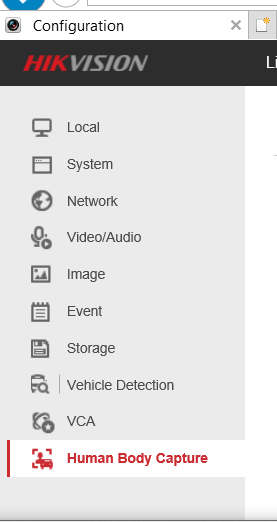

The repeated lack of release notes from the recent firmware updates is getting a bit ridiculous. That one has to get lucky and find a YouTube video from Hikvision Europe that may or may not document new features is bizarre.
Anyway, I don't remember seeing 'Human Body Capture' in the config prior to this new firmware. Not that I have any cameras that support it anyway, so I can't say what it does.
