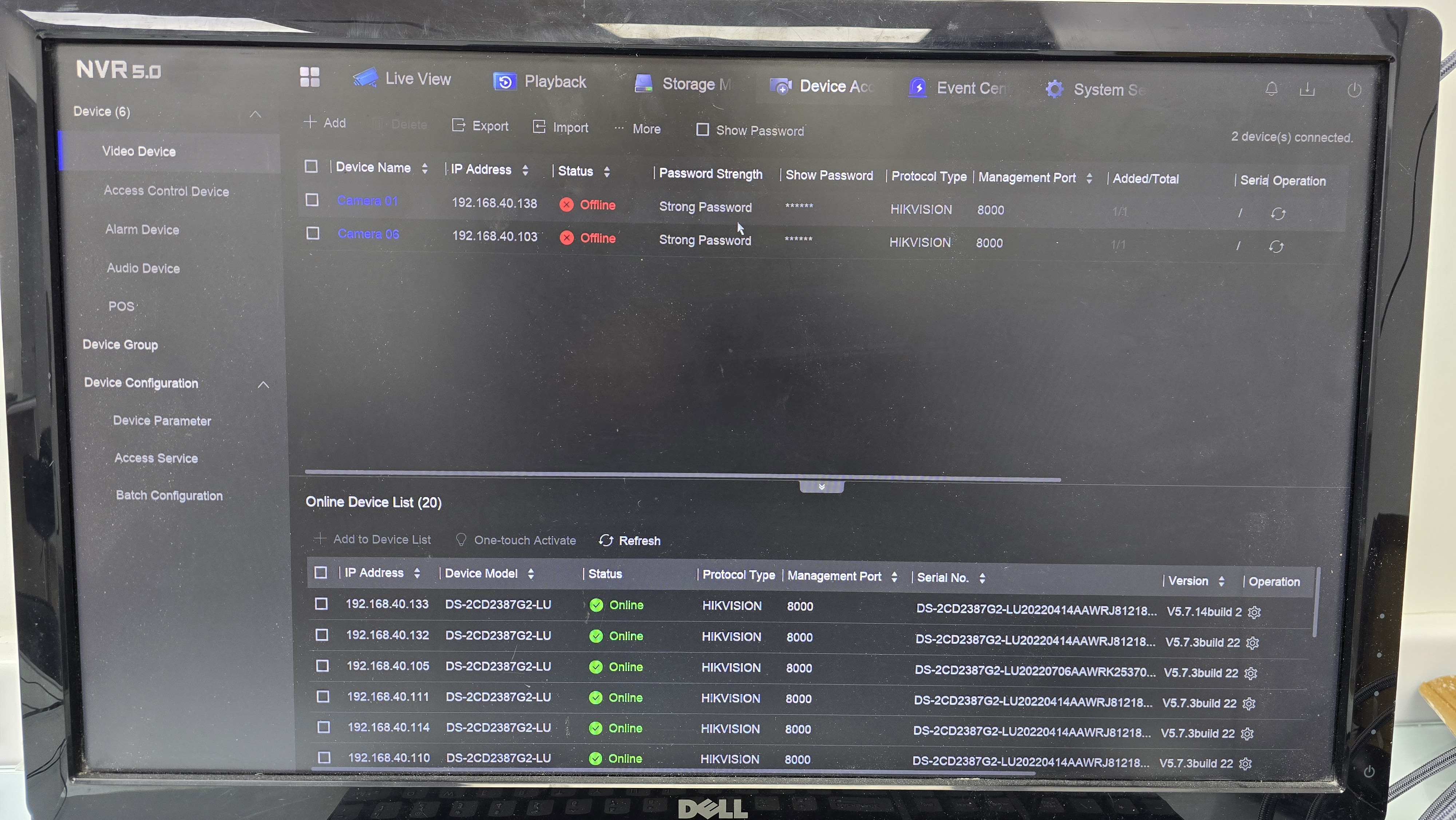

Hi,
I updated my NVR to the latest Firmware 5 and got this issue with the camera. It shows online, and when I add them, it gives offline.
Help, please

I lost two of my cameras temporarily on reboot following update. They were the two cameras that are connected to the PoE ports but manually configured (not plug and play). That solved the mystery of everything being greyed out when clicking edit and the inability to switch between plug and play/manual when needed. The fix was to go to Device Access > Device Configuration > PoE Settings and turn off 'Network Camera Plug and Play' for those two channels, then go to Device Access > Channel - the two missing devices then appear in the 'Online Device List' at the bottom of the page. Using the Quick Add reconnected them in the correct positions. So it seems that's the new way to add manually - Plug and Play must be disabled for the individual channel first which makes sense. This should also prevent a manually configured camera being wiped, by connecting it to a Plug and Play configured port when the passwords match (which was too easy to do previously)
