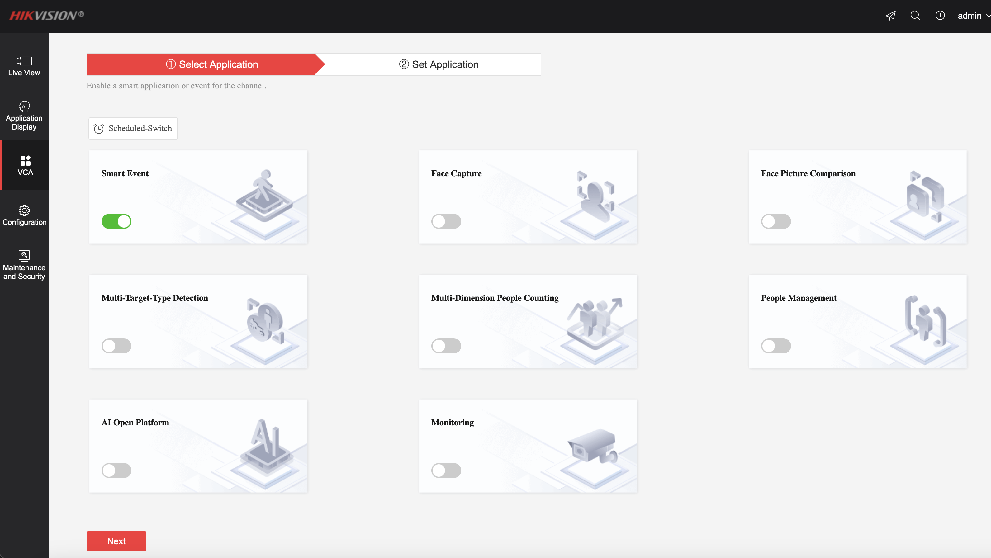

Hi everyone. This is my first post. I bought the DS-7616NI-M2 nvr a few days ago. At the time of installation it had a firmware v4.xx I don't remember the particular build. I updated the other day to the latest version currently available but the most serious problem I encountered with all my cameras is the lack of functionality of the advanced perimeter protection events. The interface tells me "function not supported". This is impossible because the same cameras worked perfectly with the two previous NVRs. Now I downgraded to version v4.xx but I have not solved the problem. So I ask, waiting for better versions, which is the most stable version 5.xx at the moment? Excuse the language, I write from Italy and I have to use a translator.
For some cameras, you need to go to the web page of it and enable the VCA function for it first.
Edit: Depending on what camera and FW it has, you may also need to reboot the camera.
