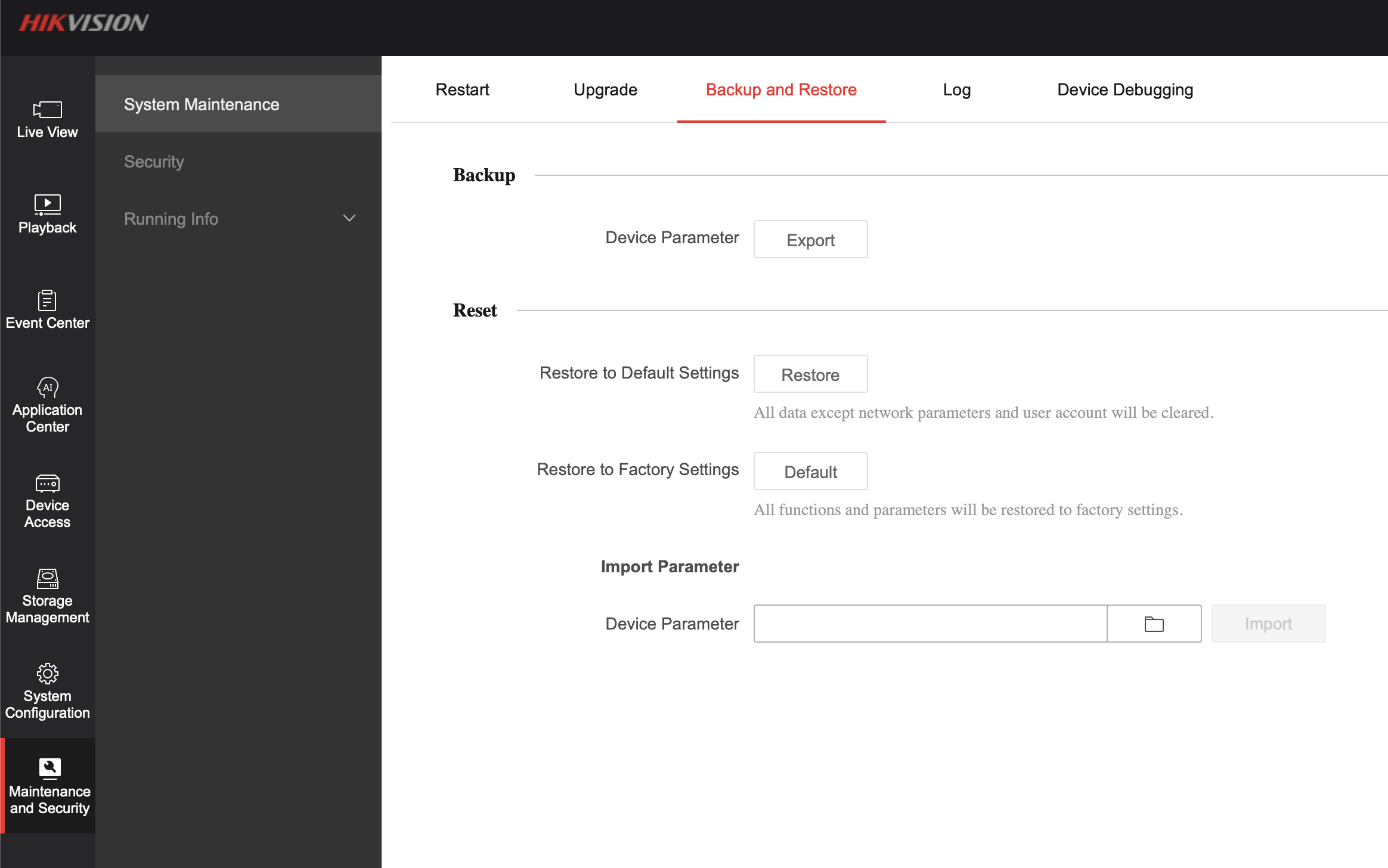

Since you are installing a new NVR I would factory default it after downgrading.

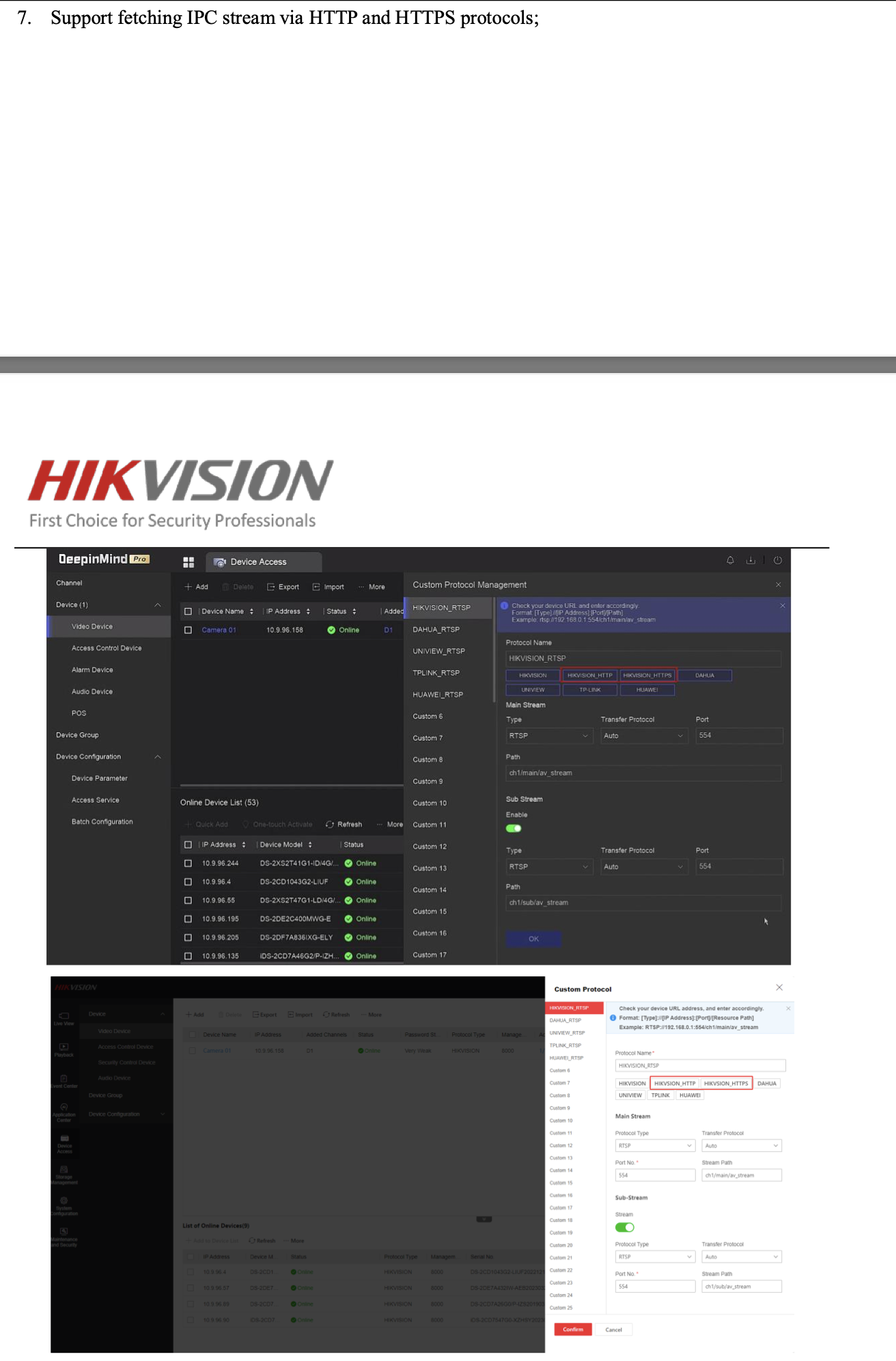

I wonder if feature 7 in the release notes have anything to do with human/vehicle markers not showing up in Hik-Connect playback for recordings after the FW update?
