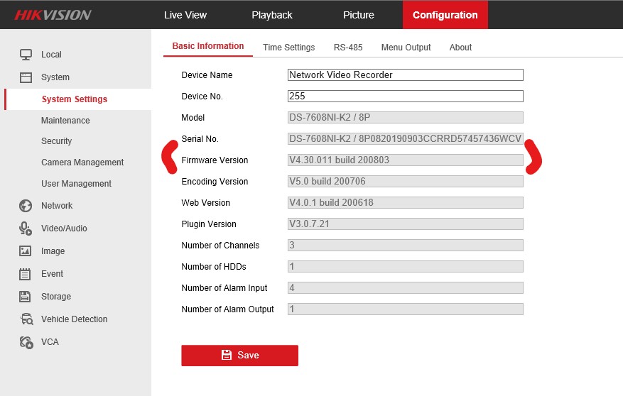

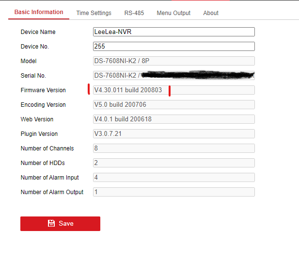

I've just upgraded mine to V4.30.011 build200803 EUI from V4.30.005_200628, but I did a down grade and reset first to V3.4.112_200604 as I had originally done an upgrade from V4.21.005_190509 and that is the version the Hik said we shouldn't have used and that we should down grade to v3 before upgrading to v4, so I took the opportunity to do that. All went smoothly and everything looks to be working as it should. I'll give it a week and then I'll upgrade the other 7 NVR's I look after...

I just noticed these new versions yesterday so uploaded it onto the portal. The latest uploaded firmware just fixes some known issue from the old version so it doesn’t have release note. It supports all [76 77 86 NI-K2 K4 K8]. It is alright to drop to the latest version V4.30.011 build200803 EUI.
So basically these firmware versions had been released for a period of time before the UK support team who manage the download portal where made aware of them so they uploaded both at the same time. To answer @Woodyz82 question, these firmwares would appear to only be bug fixes and you can jump straight to the latest v4.30.011 version.
