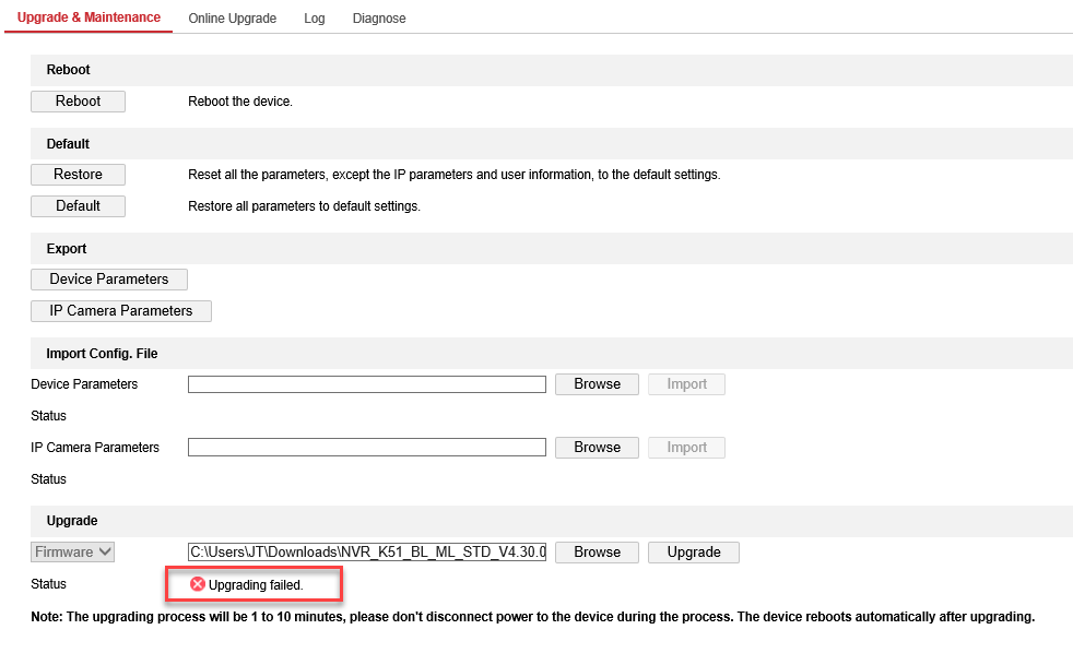

Has anyone been able to successfully upgrade their NI-K2 NVR with V4.30.061 build210313?
I tried and I am getting an upgrading failed error -
Yeah I have without any problems. However I updated mine via usb stick plugged into the NVR.
Hi @JT_Singh
What Firmware version is your NVR currently running?
Which browser are you using to perform the update?
@JT_Singh , you need to unpack/unzip the downloaded file first. Then you will have a digicap.dav file that you can upgrade the NVR with.
