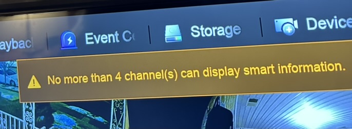

In the Live View screen on the NVR... if you select "Display VCA Info" from the pop-up menu at the bottom of the screen only the first 4 windows (I have 3 x 3 on my default view) will show VCA lines/information... if you go to another individual window say 7 and from its pop-up menu select "More/Show VCA Info" the following message appears...
I'm certain this was not the case in the 4.0 GUI... I've never used an AcuSense series NVR, but this seems like a limitation it might have? Confused...
