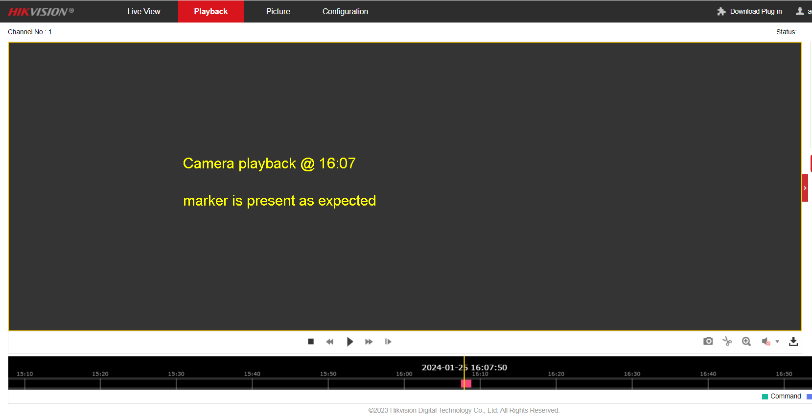

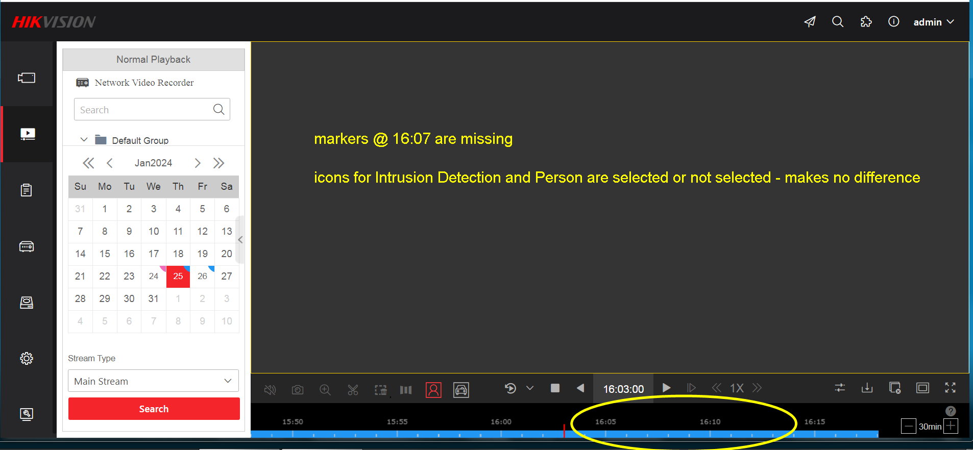

Intrusion Detection markers missing from NVR Playback - using Chrome Web UI
Scenario:
  • DS-7616NI-M2 - Firmware Version - V5.01.060 build 240110
  • DS-2CD2387G2-LSU/SL - Firmware Version - V5.7.14 build 231213
  • Web Browser --> Chrome
  • camera configured for Intrusion Detection
  • camera configured to record to SD card only when smart event is triggered
  • NVR set to continuous record
On NVR:
  • "Event Center" configuration shows Intrusion Detection is set
  • an "Event Search" shows captured pics @ 16:07. A double click on the pic & "Event Search" provides a brief pop up indicating "Channel 1 No videos" (seems strange to me).
  • "Playback" @ 16:07 actually shows the video of the intrusion
  • ICONs, during Playback, for "Intrusion Detection" and "Person" are selected or not selected - makes no difference - markers are non-existent
During Playback, in all situations cases I've found, the expected "markers" (along the bottom) for Intrusion Detection are non-existent on the NVR.
Prior firmware, V4.63.025 build 231201, these "markers" were present.
New feature, or defect, or a configuration issue I've yet to discover ? I'm thinking defect since I've spent hours looking at every config screen I could find. Came up dry.
A couple of pics are included in an attempt to highlight the above.

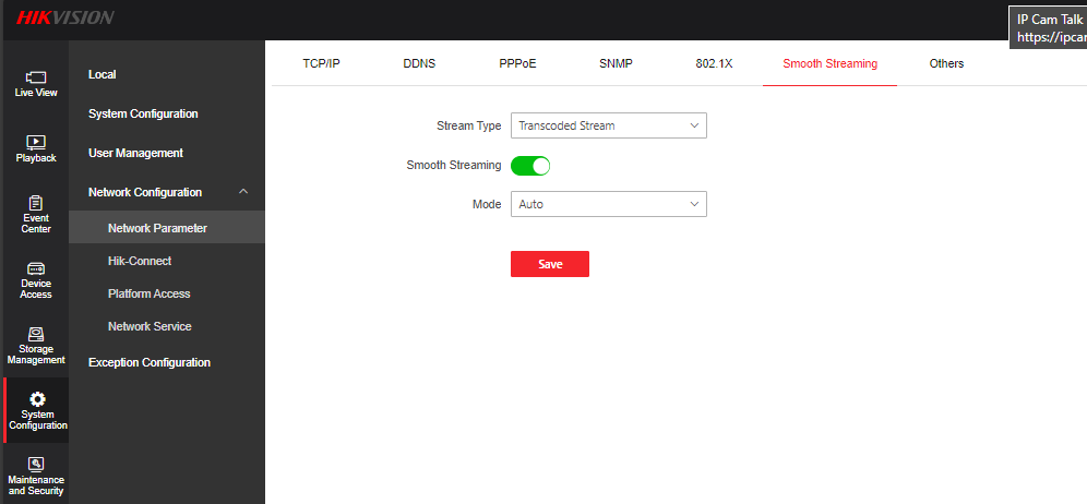

3. I tried changing the "Smooth Streaming" setting, no fix there...

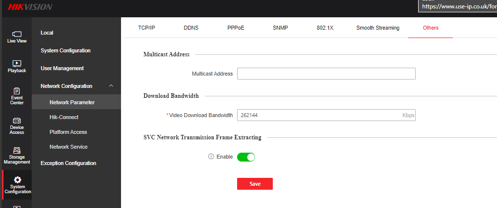

4. I noticed a new SVC setting on the NVR and tried enabling it along with setting camera's SVC setting to "AUTO", no fix there...
So, no fix found :(
