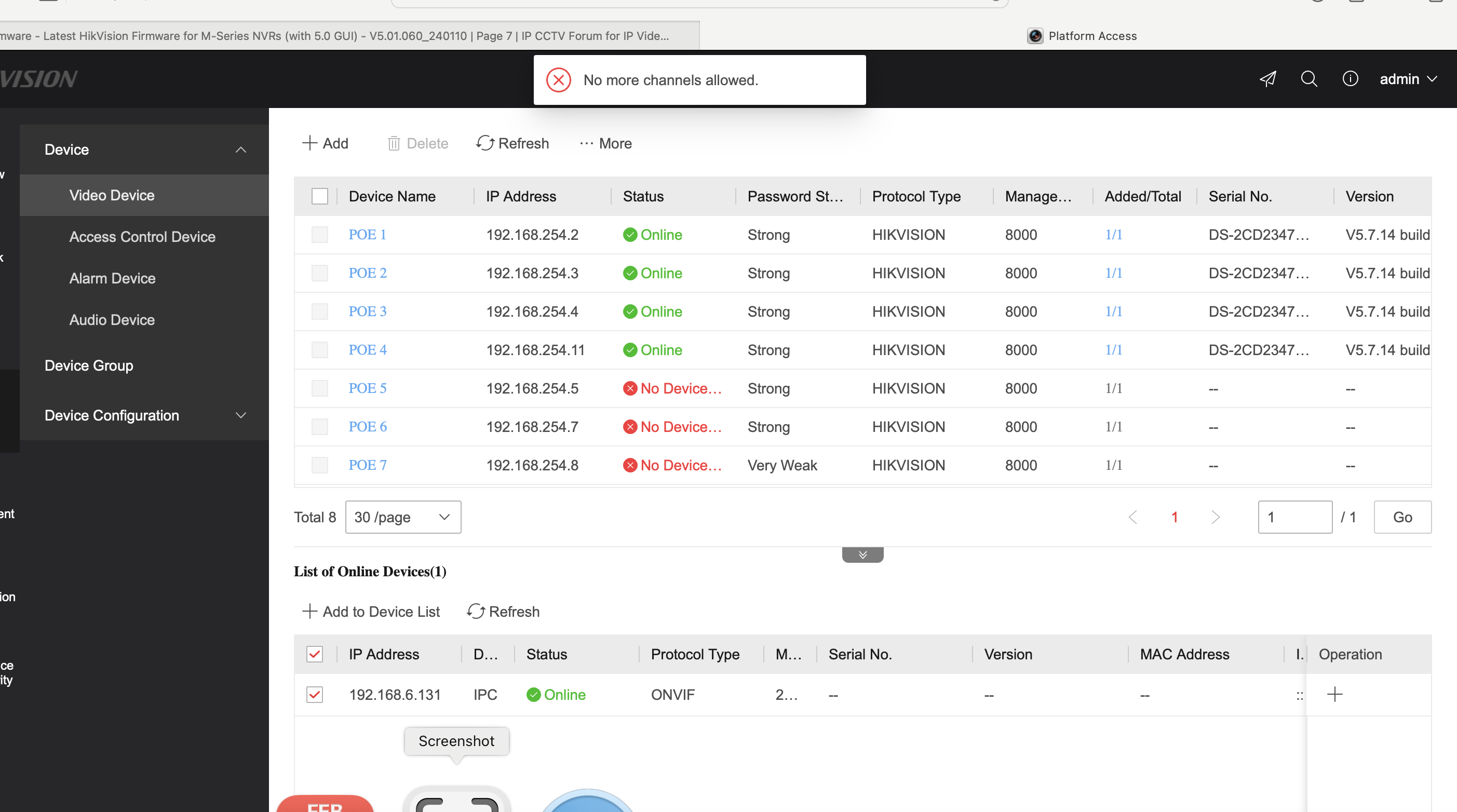

also no option to edit IP on existing device lists as options remain greyed out despite entering passwords - screenshot attached.

This is a screen grab of the other issue with it stating 'no more channels allowed' when pressing add online device to device list despite me having 3 spare channel slots.

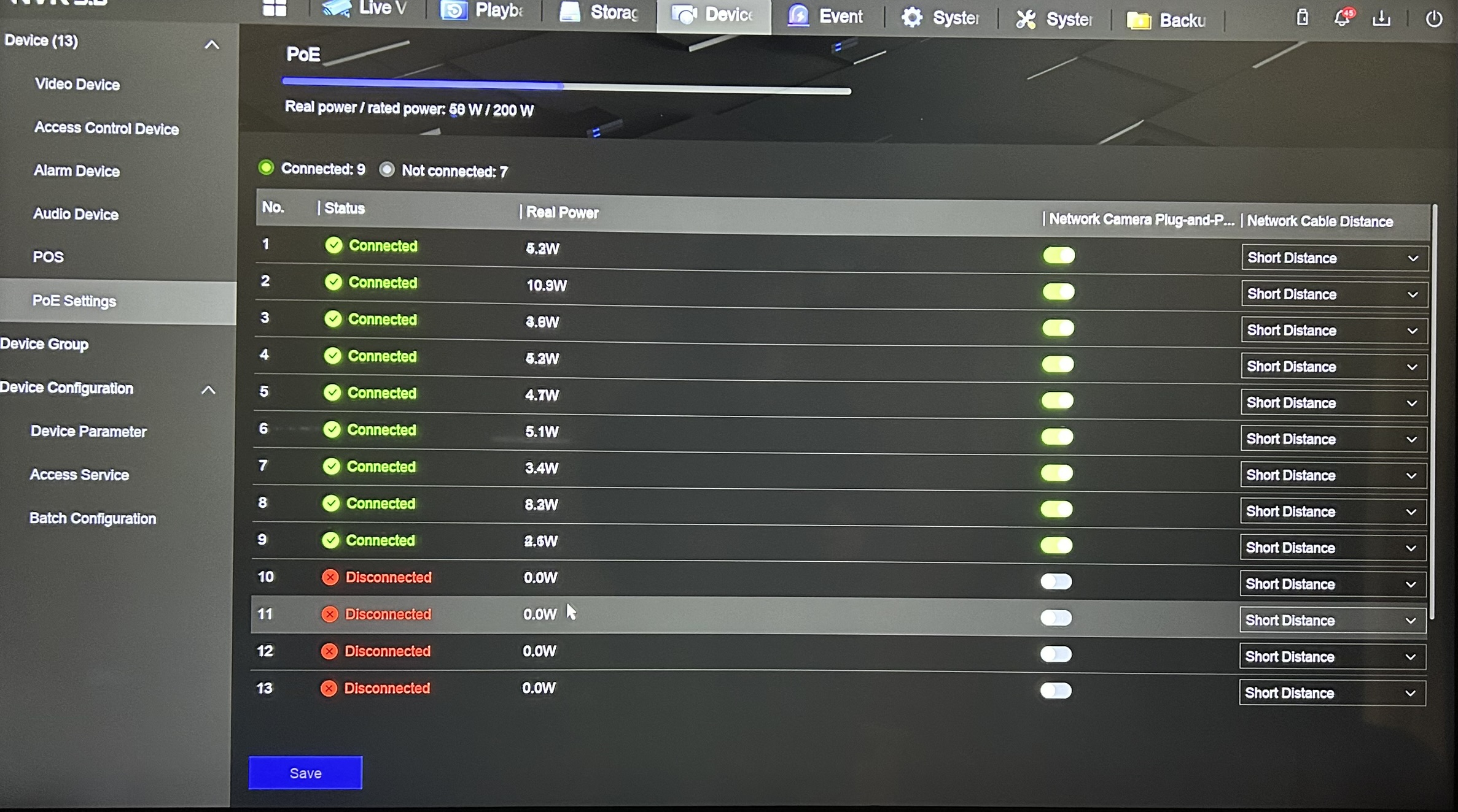

Hi @stuhope123 ... I assume the ONVIF camera is wireless?... if so, maybe you need to turn off PoE port 8 to free up a channel for it to use? Perhaps the channel was off before, but got turned on by the update? Here's the setting I'm referring to:
I think this setting may only be available on the NVR GUI... I can't seem to find it on my web GUI...
you my friend, are a legend!
