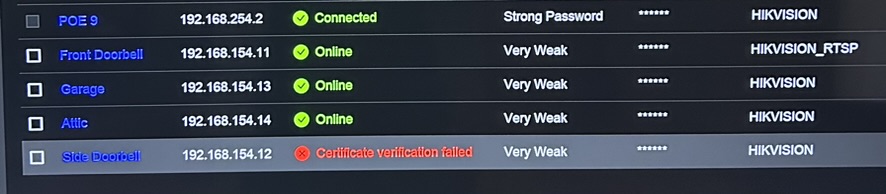

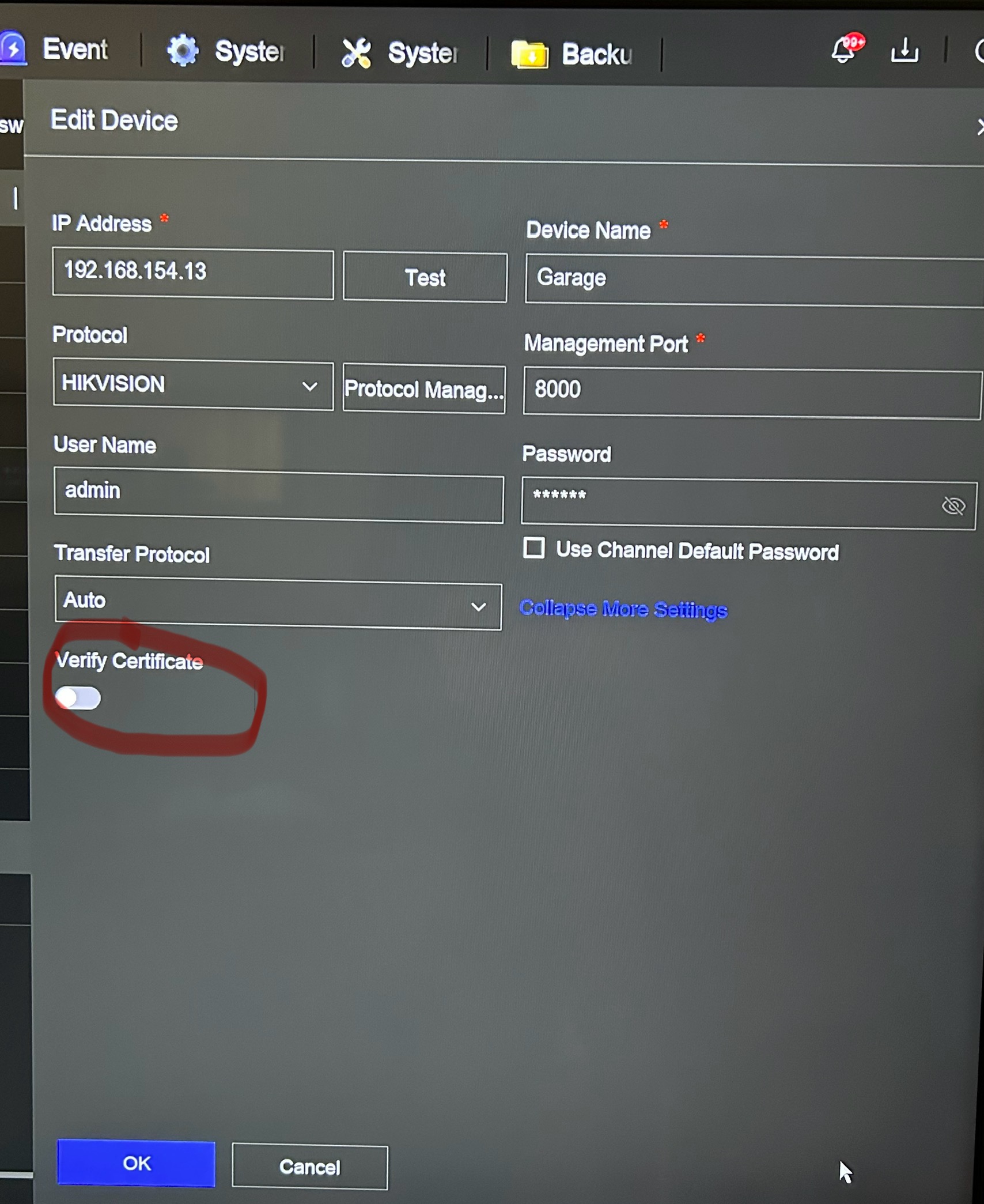

My Hikvision video doorbell won't register with the NVR either, I keep getting a message that the 'Certificate Verification Failed'
I have 3 EZ-Viz wireless cameras connected to the NVR... 2 of them are fine but the DB1C doorbell is not connecting... status shows "Certificate verification failed".

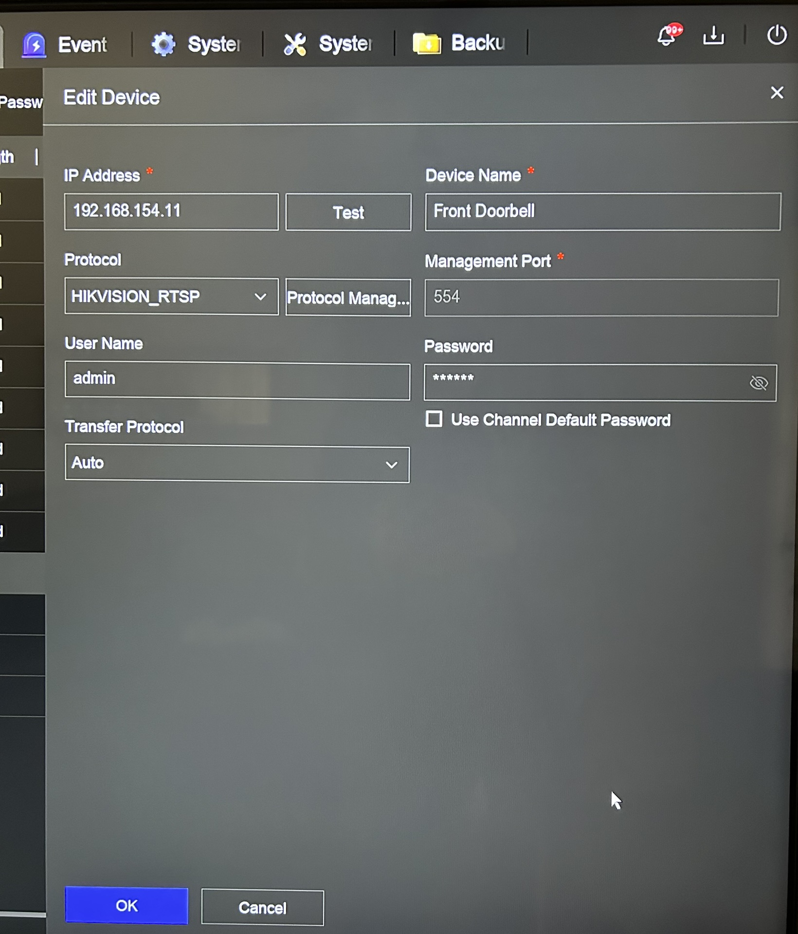

Under "Edit Device" on the NVR for the DB1C, I see there is a "Verify Certificate" button that is not checked?... tried checked/unchecked does not help... don't know if this was there in the V4.0 GUI.
The "Certificate verification failed" status occurred for both a Hikvision DS-HD2 and an EZ-Viz DB1C doorbell.
Even though I had "Verify Certificate" unchecked...
I have added the doorbells (hopefully temporarily) using the HIKVISION_RTSP protocol...
I always had this problem when added DS-KV6113WPE1 and Ezviz CS-H3R100.
But then suddenly they were both recognized with Hikvision protocol.
I cannot remember how. Possibly when added all together
In my case the doorbells worked with the Hikvision protocol until the NVR was upgraded to V5.01.060_240110, so I suspect it with take another NVR firmware update to fix this. It doesn't seem to make sense getting "Certificate Verification failed" if "Verify certificate" is unchecked when adding the doorbell.
Yes there is possibly a plug and play compatibility issue. Either a new firmware for the device or a new firmware for the NVR.
Could you also try the iVMS or browser remote configuration, camera management, select doorbell, edit, re-enter user name and password and protocol and save there too. Sometimes this helps. Then reboot

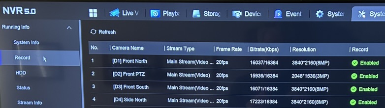

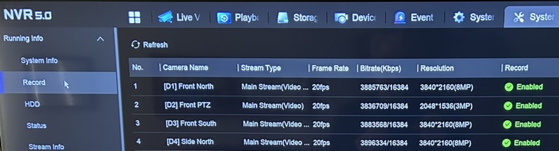

This is a minor little bug in V5.01.060_240110... sometimes when you go to the "System Maintenance / Running Info / Record" page, the bitrate values reported are clearly some accumulated figure...
A few seconds later when the page updates the bitrate values are correct...

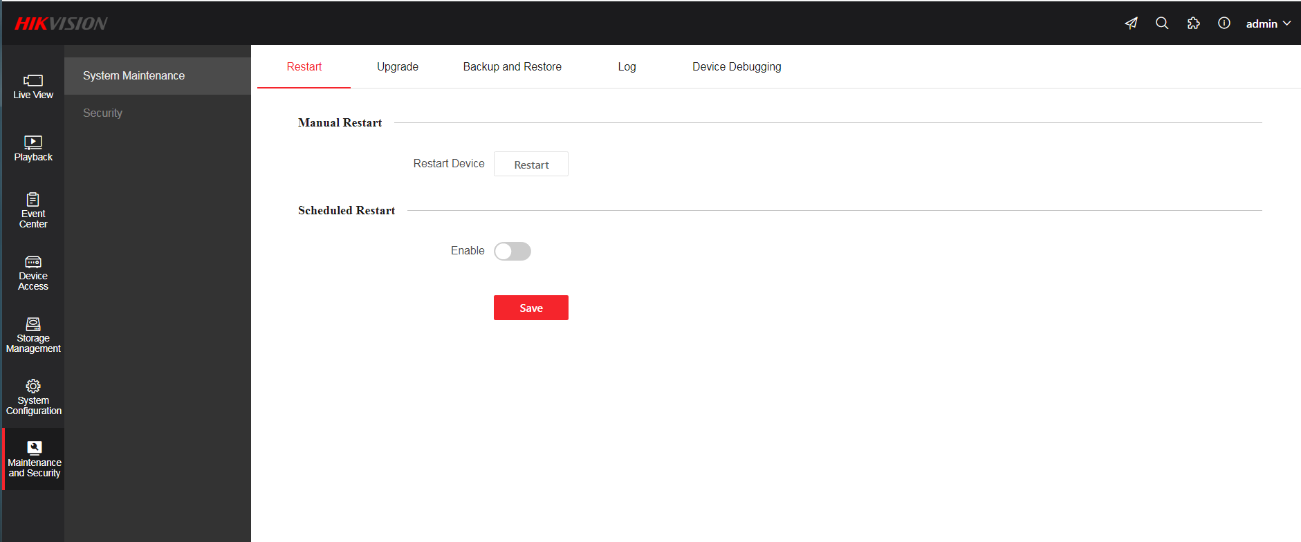

I'm not a NVR UI user.... everything I do is via the Web UI, specifically Chome WEB UI. Maybe I'm missing out. Lol.
re: that NVR UI.... the "System Maintenance / Running Info / Record" page doesn't exist in my WEB UI.
An intended feature ? or defect ?
The closest thing to the NVR UI page I have, looks like this in the WEB UI -->
Hi,
I have tried deleting, editing and rebooting many times in the last week but I still get the same error message.
Hi,
Is there an Indoor Station connected with your Doorbell for example DS-KH8301 ?
Try adding the doorbell after disconnecting and removing from any other device, iVMS, browser, Hikconnect and of course NVR
Log-out Hikconnect, reboot the doorbell, reboot PC or other with iVMS, power off Indoor Station, re-boot NVR
Then retry to connect to NVR

Hi,
I have tried all you suggested but the NVR still comes back to the same message 'Certificate Verification Failed'

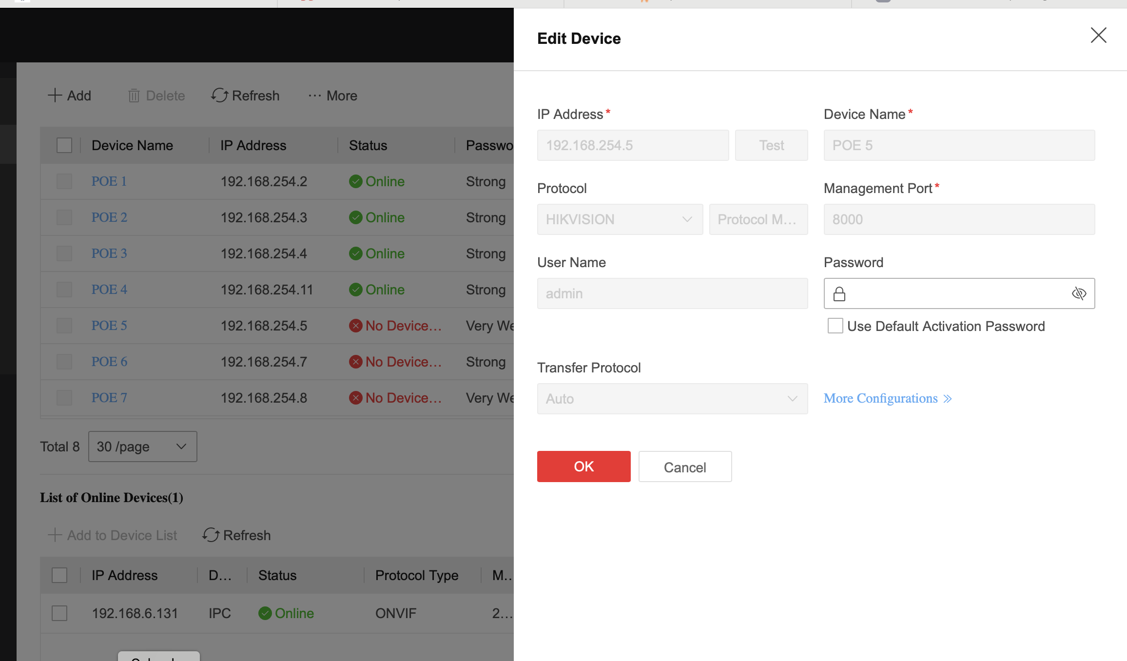

One of my ONVIF CAMS went offline due too non static ip, disappeared from device list after restart of NVR, Unable to add it back as it states 'No more channels allowed' also no option to edit IP on existing device lists as options remain greyed out despite entering passwords - screenshot attached.
