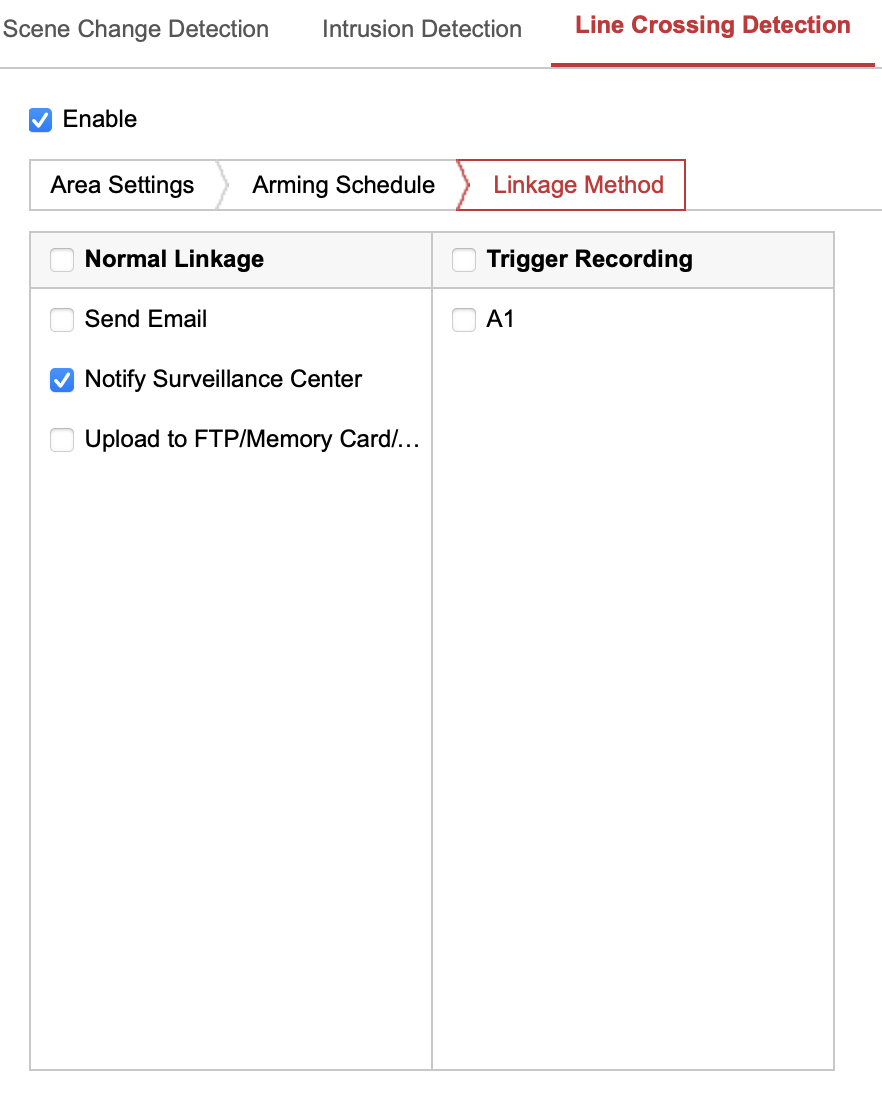

@venturis - as I mentioned in another post it's not there unless I'm missing something. Ive only seen it to date on version 5.5.114 on G5 and missing in all other versions:
View attachment 6725 View attachment 6726
I think the reason your not seeing the option is because your camera is the “-I” variant whilst you need to have the “-ISU/SL” version which has the integrated white light.
I would attach a screenshot of my camera config but Im on a tablet right now. I have the flashing light option under the event linkage for most smart events. Setting the flashing light to on instead of flashing keeps it on for the duration I set.
@venturis - All models have the integrated white light but the ISU/SL and LSU/SL has integrated white light and separate strobe light.
As I mentioned in the other post, the action to trigger the supplemental light was just that - no white LED illumination as standard during darkness, setting the action brings it on for a pre determined time after event activation. I did set it up on my DS-2CD2347G2-IU (G3 platform) a few weeks ago to try it. The ISU/SL and LSU/SL which I also have has separate options to trigger the strobe light on event activation but it's not possible to bring on the supplemental white LED in the manner described above, the way you can for the -I and -IU models with version 5.5.114.
In summary:
ISU/SL and LSU/SL have the ability to activate the strobe light (and/or speaker) on alarm event and this will occur irrespective of whether the separate supplemental LED is being used to aid illumination.
-I and -IU have no ability to activate a strobe light as they don't have one. However depending on platform and firmware version it is possible to leave the white LED illumination disabled, but have it illuminate for a time (not flashing) following an event.
Not confusing at all - lol. I think that people are getting the two functions mixed up.

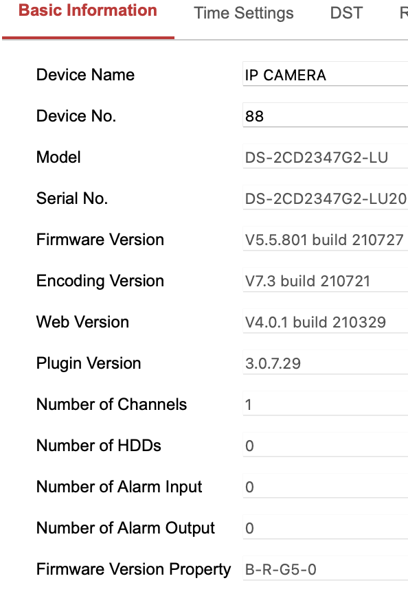

There are two portals - EU and UK. The firmware files are the same (although the UK seems to be more up to date and the EU has more of the older files if needed). The path to the relevant files is different - in the UK "Front End" leads to the Camera files and "Back End" leads to NVR and DVR files, whereas in the EU portal the files are nested beneath "Technical Materials"
To be confident which camera platform you have - G3 vs G5 (or any other). Just look in the System Settings page under Firmware Version Property at the bottom. One of mine is shown in the image and shows it as G5 platform:

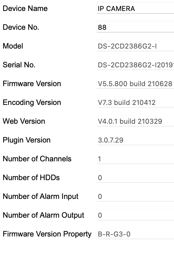

Thank you so much for clearing up the UK vs EU download specifics. I know my cameras were supplied from the Netherlands so that is that.
I also checked the Camera Plattform and it is G3
I now downloaded the 5.5.160 from the EU-Portal (Link) and the update is now in progress - great! Again, thanks!! Still not got my head around if 5.5.800 should work as well but I will try after successfully upgrading to 5.5.160 first.
