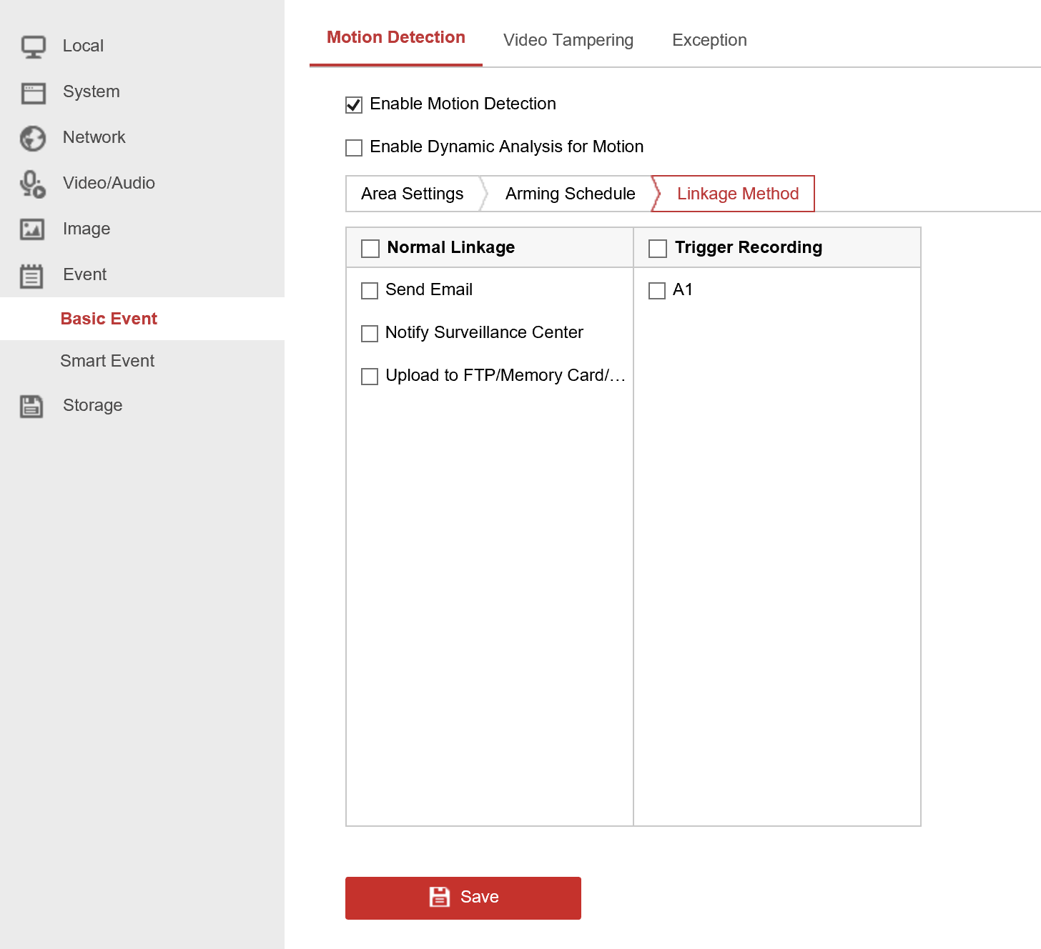

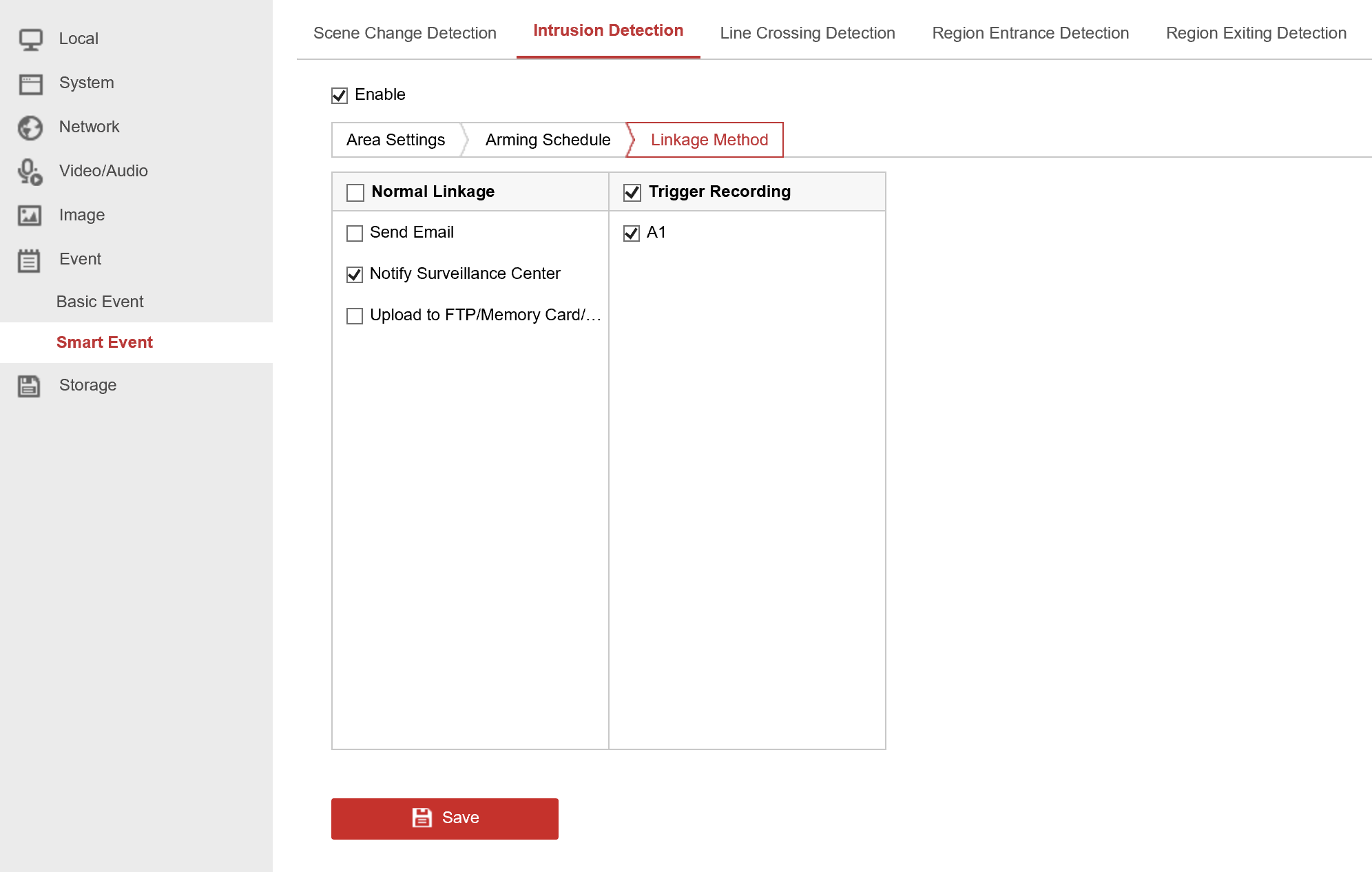

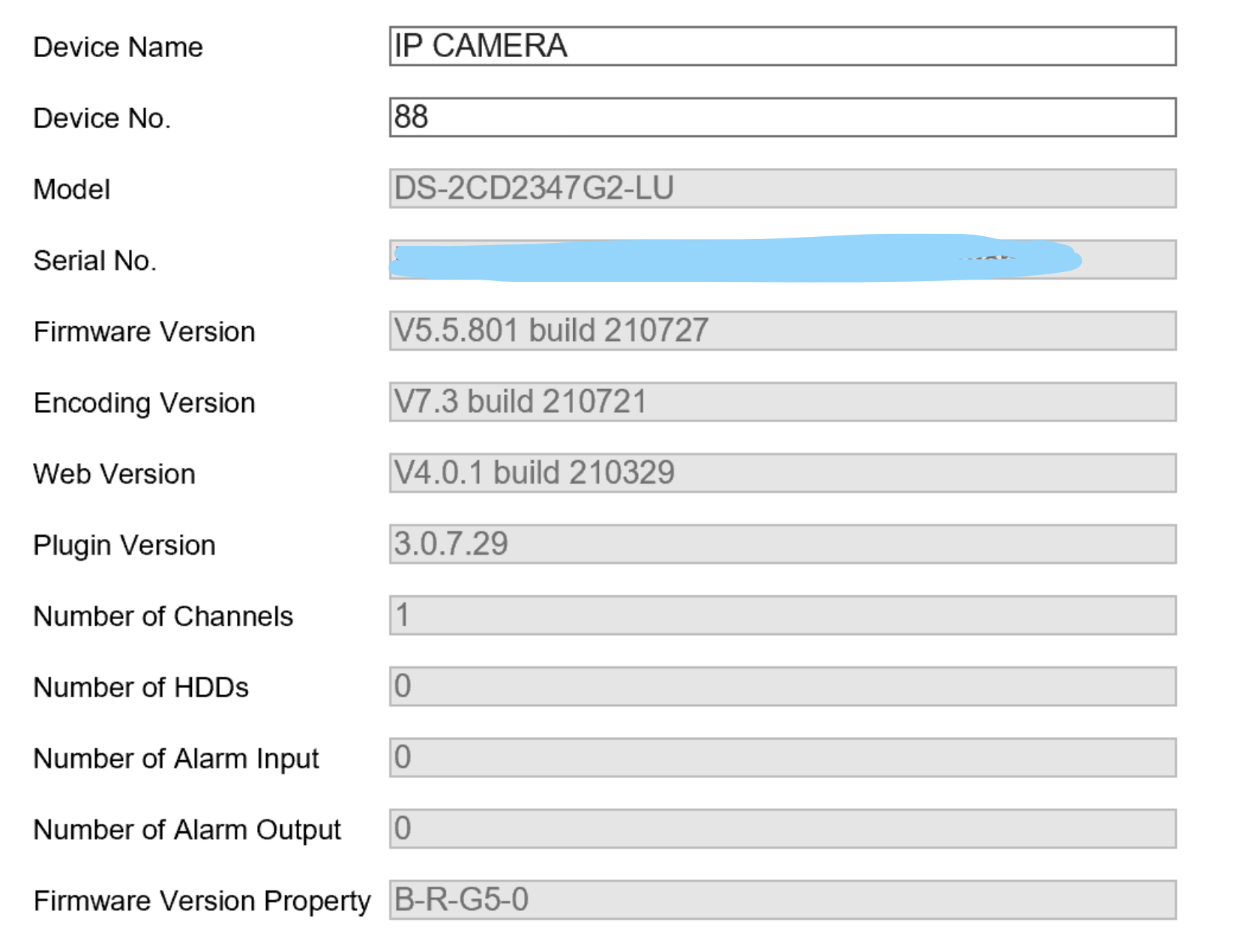

Can you guys please help a newb?? I bought a G2 camera because I heard you could set up the white LED lights to be triggered by motion detection. However, I do not see the "LED Light" option under the Linkage Method as it shows at 24:51 in this youtube video:
I have the following camera: DS-2CD2347G2-LU
Firmware is V5.5.801 and here's screen shots:
And here's screen shots:
View attachment 6653View attachment 6654View attachment 6655
Answered here:
Ouch, so it's just gone?? Is there anyway I can roll back the firmware to the version you posted?? Is there a newer version of this camera that does have the feature? I really need that feature as I bought this camera specifically for this feature to use in a dark alley.
Please let me know if there's anyway you guys know of a way to get this feature back.
All that’s gone is the ability to have it trigger on event rather than solely based on light level but it was a handy feature that immediately brought the camera to attention when activated.
If the feature is a must have, you can just load the 5.5.114 version - should be no issue.
I'm just a homeowner with basic skills, is there an easy way to roll back the firmware to 5.5.114? Will it work with just updating it through the regular process? I wouldn't think it would update to an older version of the firmware.
When you say "rather than solely based on light level" does this mean there's a way to setup the camera to turn on LED at night when motion is detected?
Yes it would just be "updated" in the same manner. I've never had any issues dropping to a lower version (usually when I've found a bug I don't like in the new version)
By default the camera will activate the white LED when it's dark IF it's needed. If you want the LED to work only when motion is detected then currently firmware version 5.5.114 is needed to make the option available in the cameras webpage menu.
PS: It's always best to start a new thread if you've a query rather than adding to an existing unrelated one - you'll likely get a faster response
Okay, I just posted a new thread. A google search makes it sound very difficult to roll back firmware with a potential to brick the camera but if you have done this without issue I'll give it a go tomorrow.
Thanks
