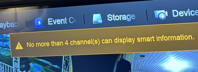

In the Live View screen on the NVR... if you select "Display VCA Info" from the pop-up menu at the bottom of the screen only the first 4 windows (I have 3 x 3 on my default view) will show VCA lines/information... if you go to another individual window say 7 and from its pop-up menu select "More/Show VCA Info" the following message appears...
It used to show it for all channels in the multiscreen, there was no limit. I don't use it but have confirmed I see the same on my DS-7616NI-M2/16P.
If you turn on "System Configuration/Local/Rule Information" in the web GUI, the Live View display in the web GUI happily displays VCA Info without the 4-channel limit... seems kind of arbitrary that the Live View screen on the NVR would have this limitation.

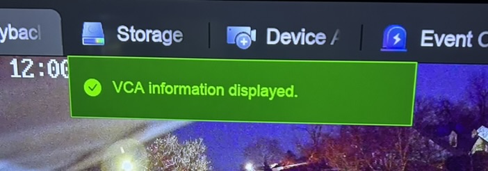

Once you turn it on via that system config, does the show/hide have any effect or is it locked on? Also does that display the overlays in playback that don’t seem to work?
I may not have been clear... The "System Configuration/Local/Rule Information" in the web GUI only affects the web GUI live view / playback... so enabled on the web GUI all seems to work correctly in both live view and playback... with no channel limit... there is no other show/hide button in the web GUI?
I assume you mean on the NVR GUI... I checked and NO, "Show VCA Info" does not seem to work on the NVR GUI playback despite the "VCA information displayed" message you get when tuning it on... it does work on the NVR GUI Live View (with the 4-channel limit).

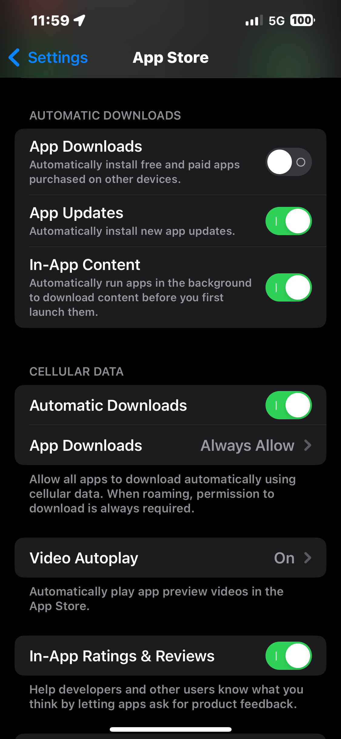

PS: I wonder why Hik-Connect just never seems to auto update on iOS. I regularly have to manually update after some days.
I've wondered about this too... not just Hik-Connect, other apps on my iPhone do not automatically update... there is a setting in iOS for "App Updates" that I did have turned on... I did not have "Automatic Downloads" (cellular data, same settings screen) checked so I have checked it now and will see what happens next time...
My screen is the same. I too do not have mobile data automatic downloads enabled but that shouldn't matter as it's always on WiFi at home. I regularly have to go into the App Store, search Hik-Connect. It's show as installed with a link to open it; however if I click on the app to get more details that 'open' link changes to 'update'. Sometimes there's been an update over a week ago and I'm still on the old version.

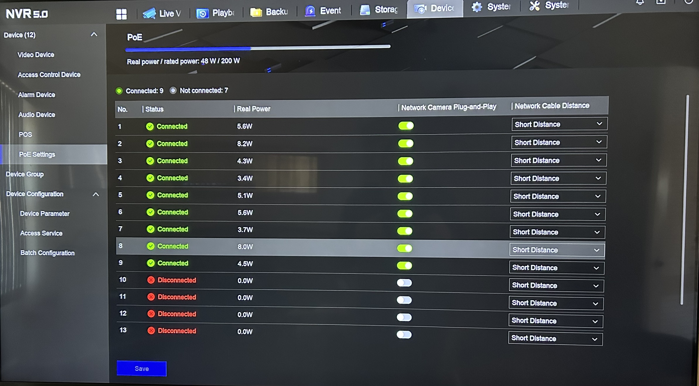

Another issue. It doesn't appear to be possible to edit a channel:
Go to Device Access > Video Device then double click a channel 'POE 1' for example. All fields are populated but greyed out. I would be unable to change from Plug and Play to Manual in order to enter an IP address manually.
I don't have the NVR 4.0 GUI running so I can't be sure, but did this change? Instead of "Network Camera Plug-and-Play" the 4.0 version of the PoE setting screen had "enable/disable"?
I tried turning off "Network Camera Plug-and-Play" for PoE port 1 and the camera went offline. I was then able to add the camera again to that same PoE port 1 even though "Network Camera Plug-and-Play" remained disabled... I guess this is the way you would have to add cameras without plug and play now?
On V4 for all models you can just highlight a channel and click the edit icon. In the resulting pop up box you would switch the channel from plug and play to manual and edit the IP parameters and password to suit. You could make those changes with or without the camera connected.

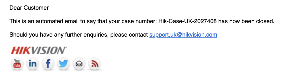

I always get a ticket number.....and then in a couple of months time after no further correspondence you'll likely get a "Case Closed" e mail like this:
By the time I get the "Case Closed" I've usually forgotten what the hell I reported!
